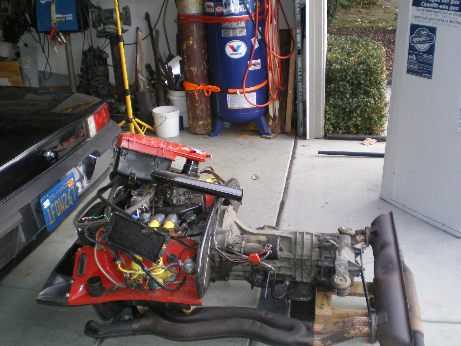

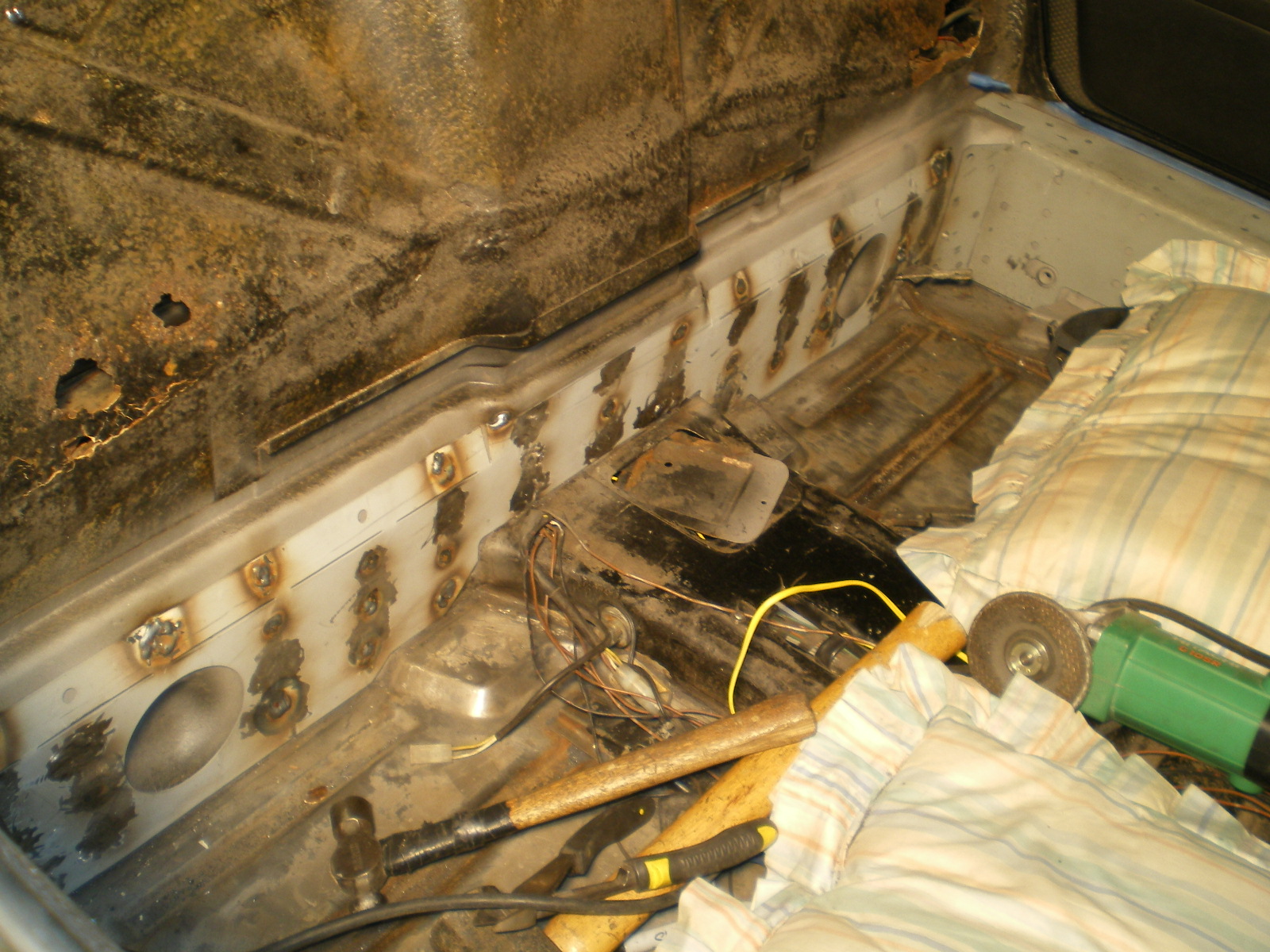

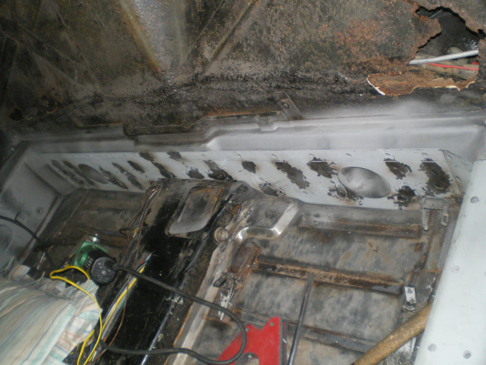

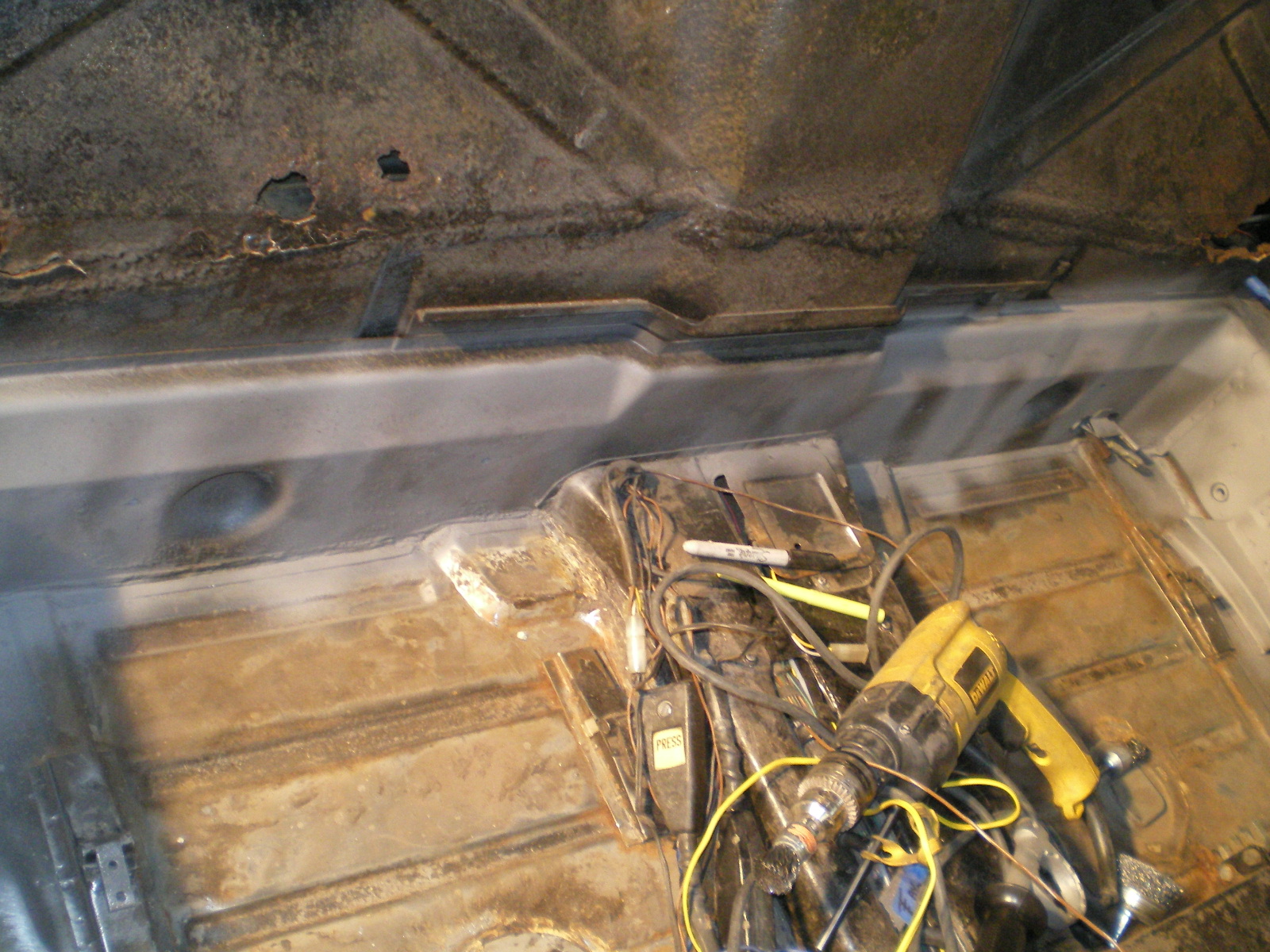

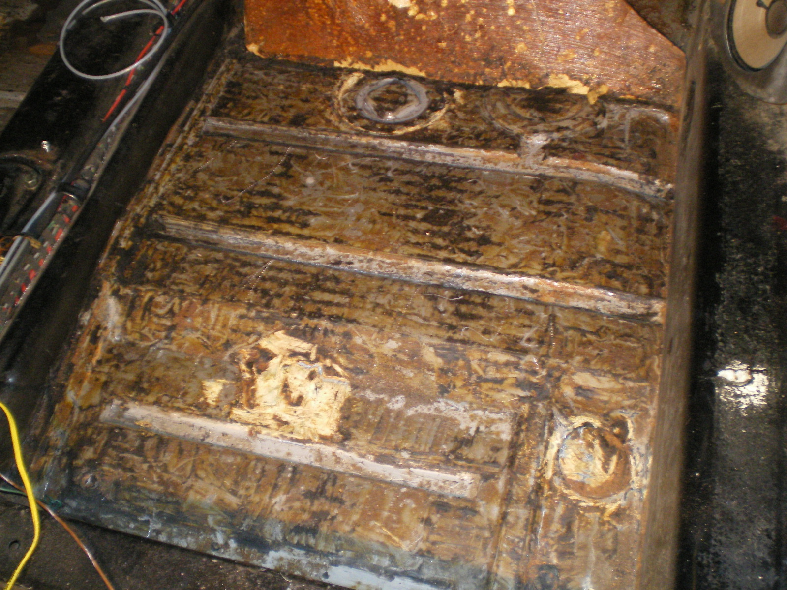

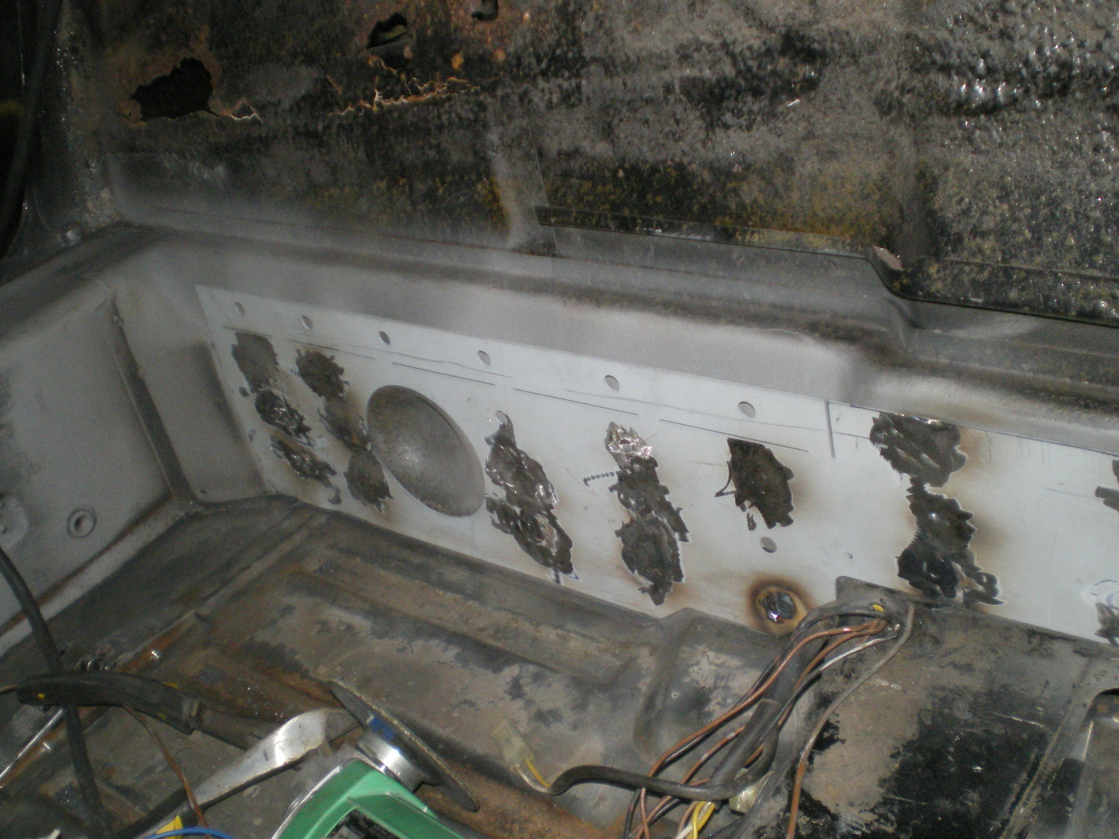

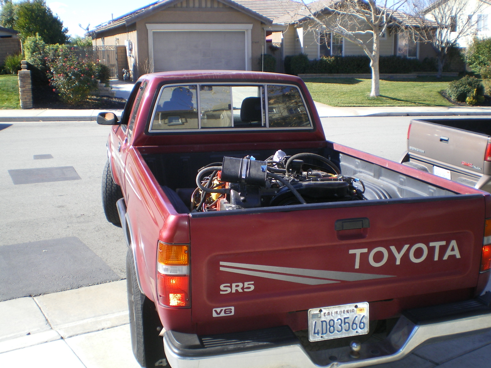

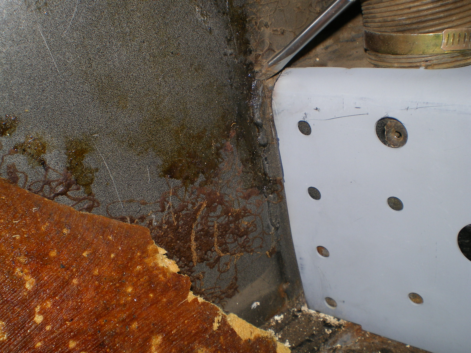

What's it been? A year since I got Blackie running. I finally get it tuned to a daily driver status and should have been happy as a Lark then but what do I do? I sold the engine (w/90 hour's on the Hobbs) on the last Dawn Patrol GMR run. So I pulled the engine and began preparing Blackie for her transformation.

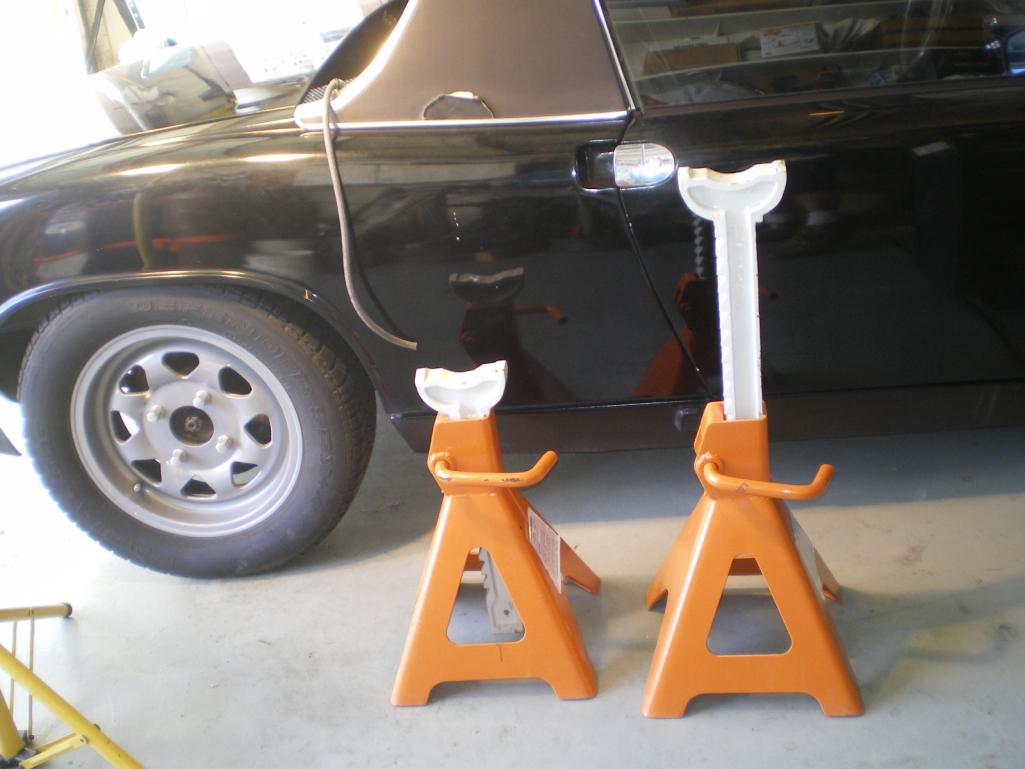

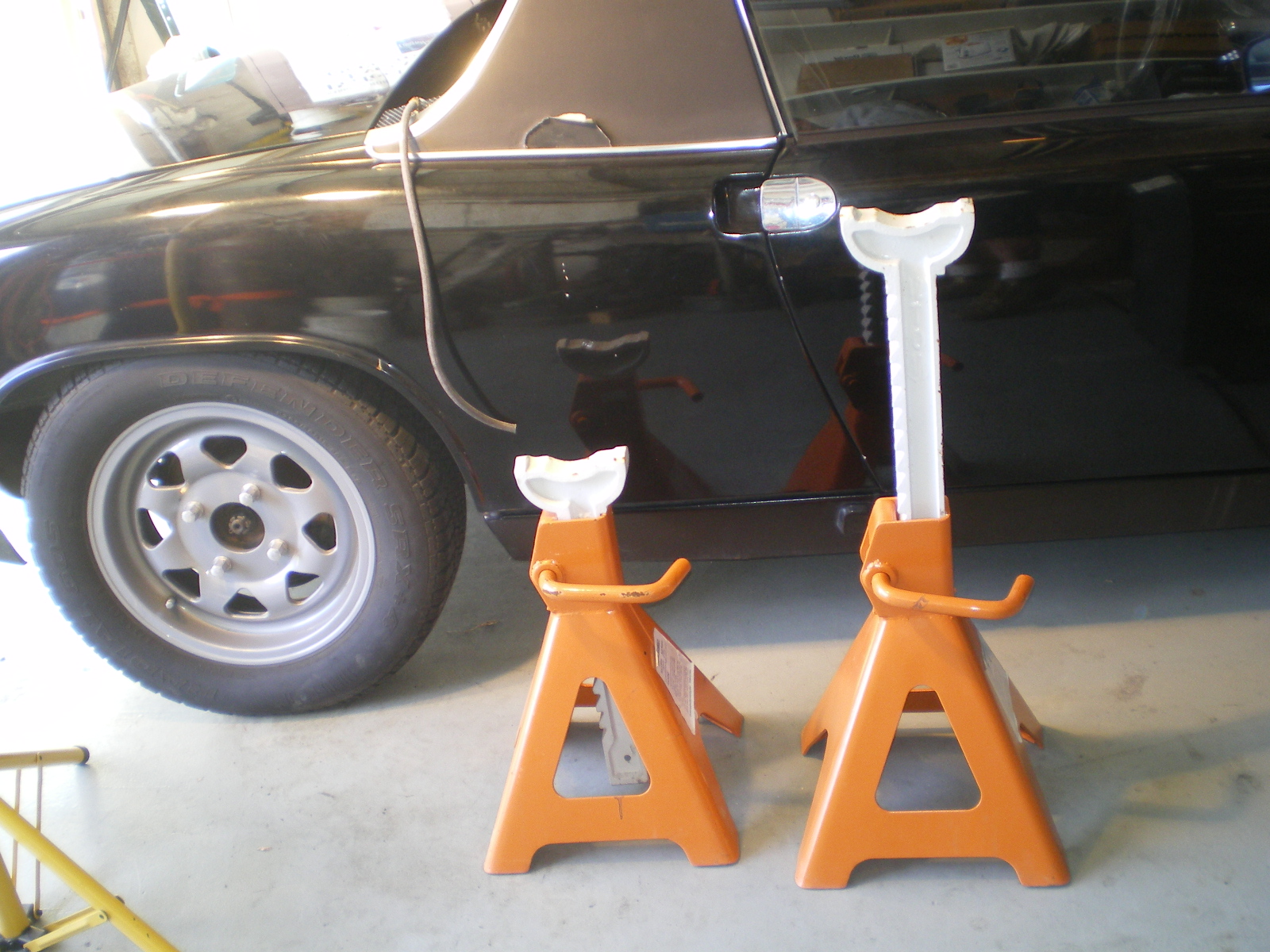

Before I go any further check out my Jack Stands. Min height 19.5", 12 ton and should hold up to a 6.7 quake or direct nuclear attack.
And out she comes.

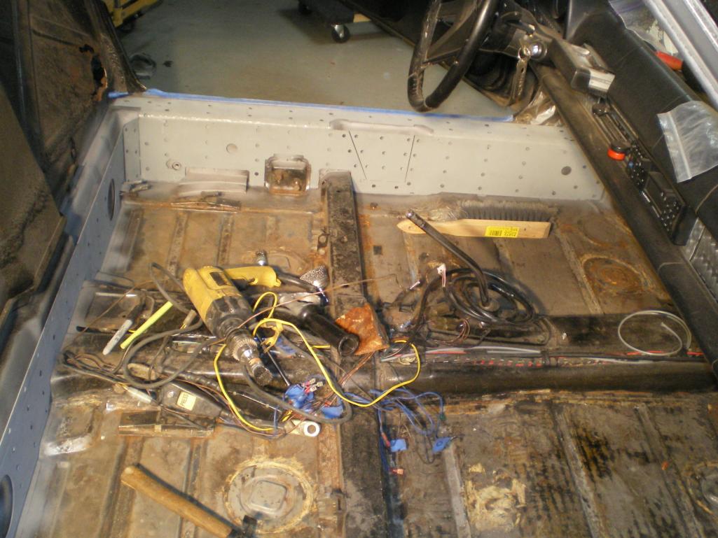

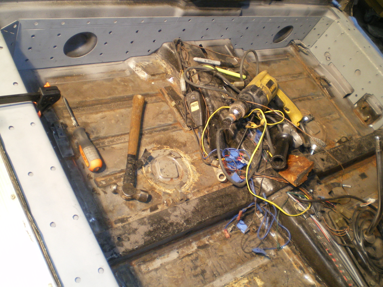

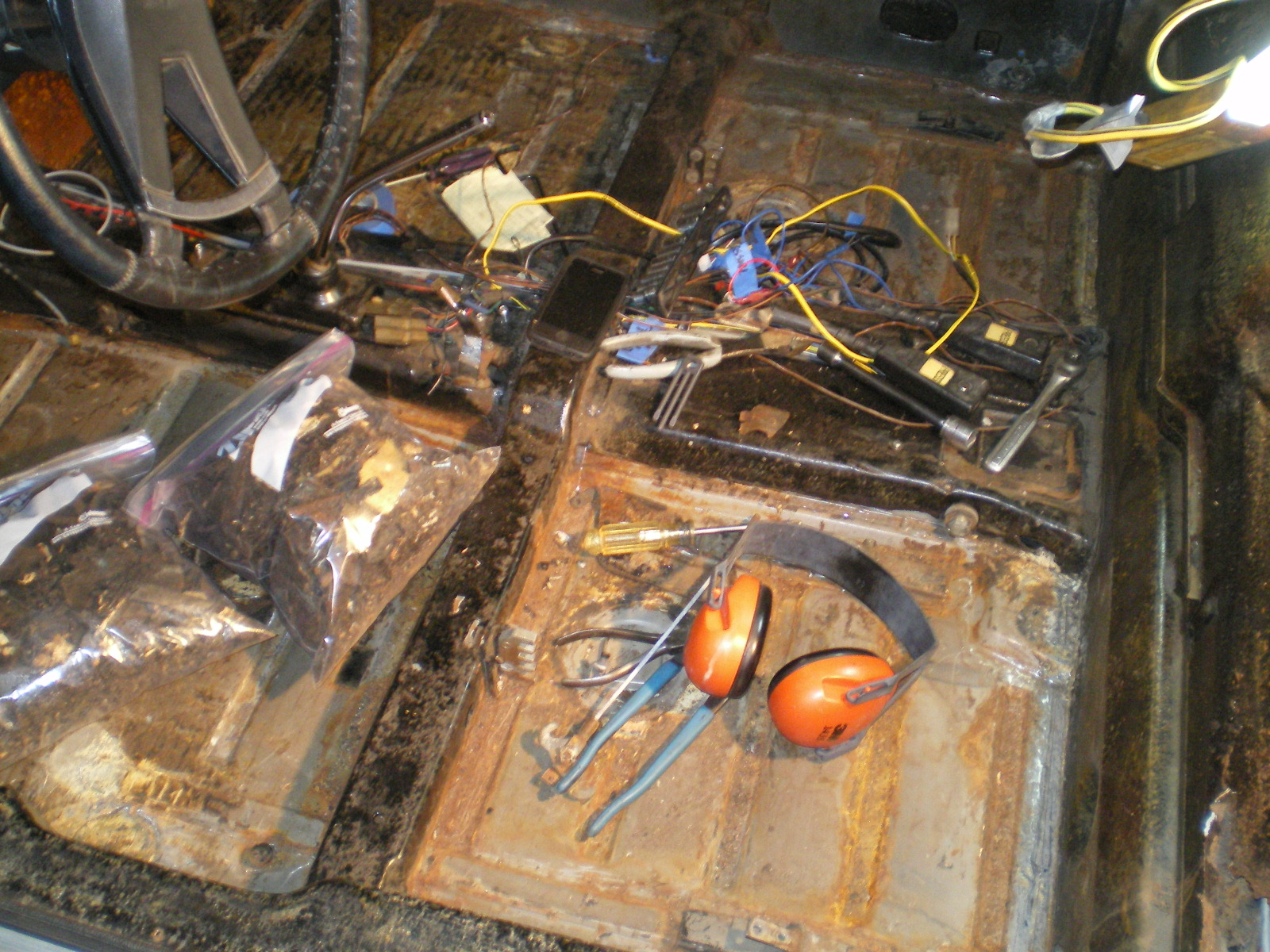

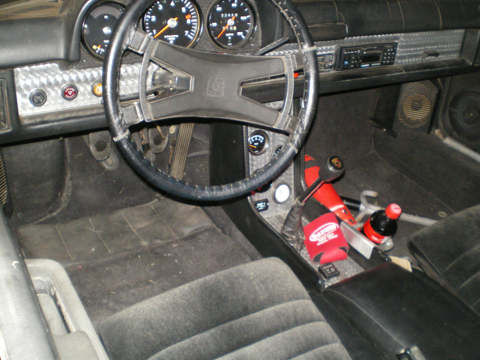

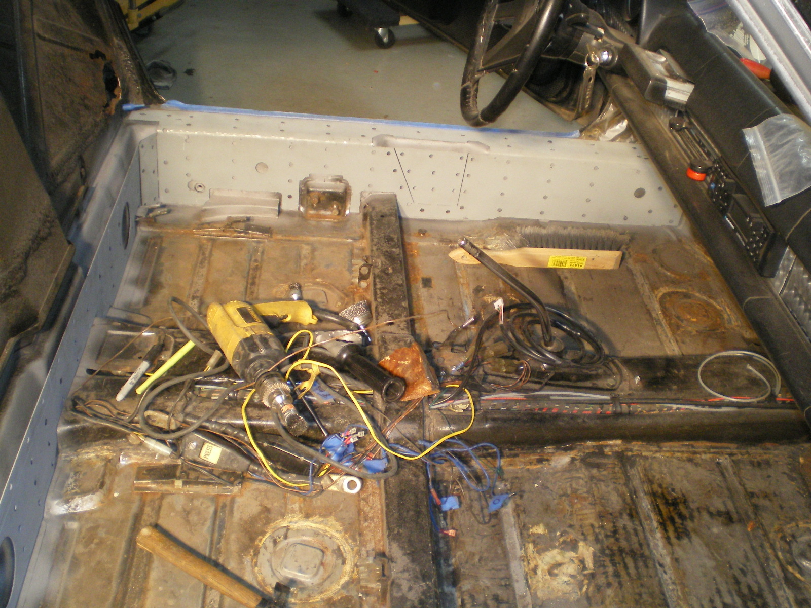

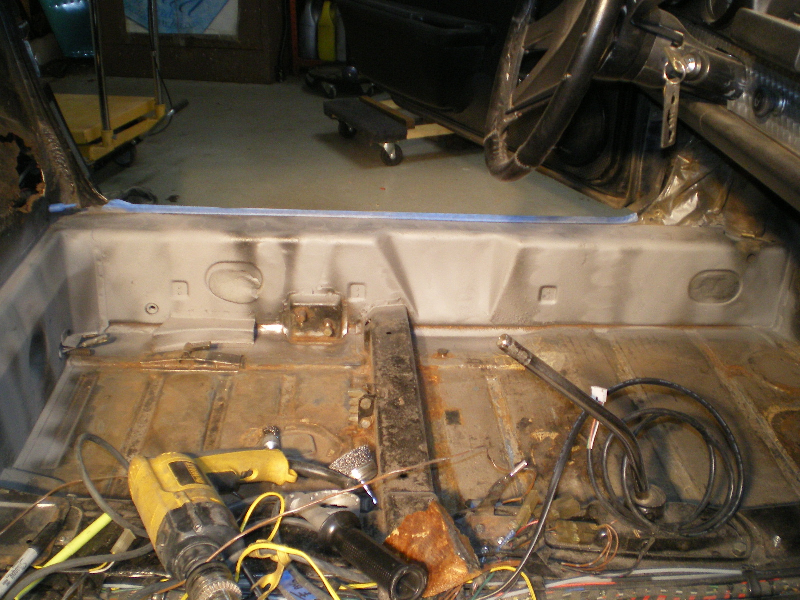

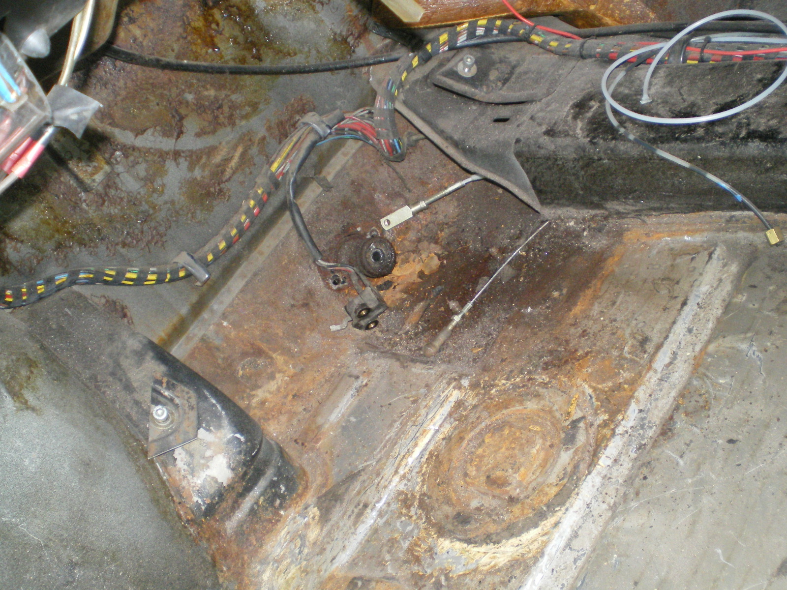

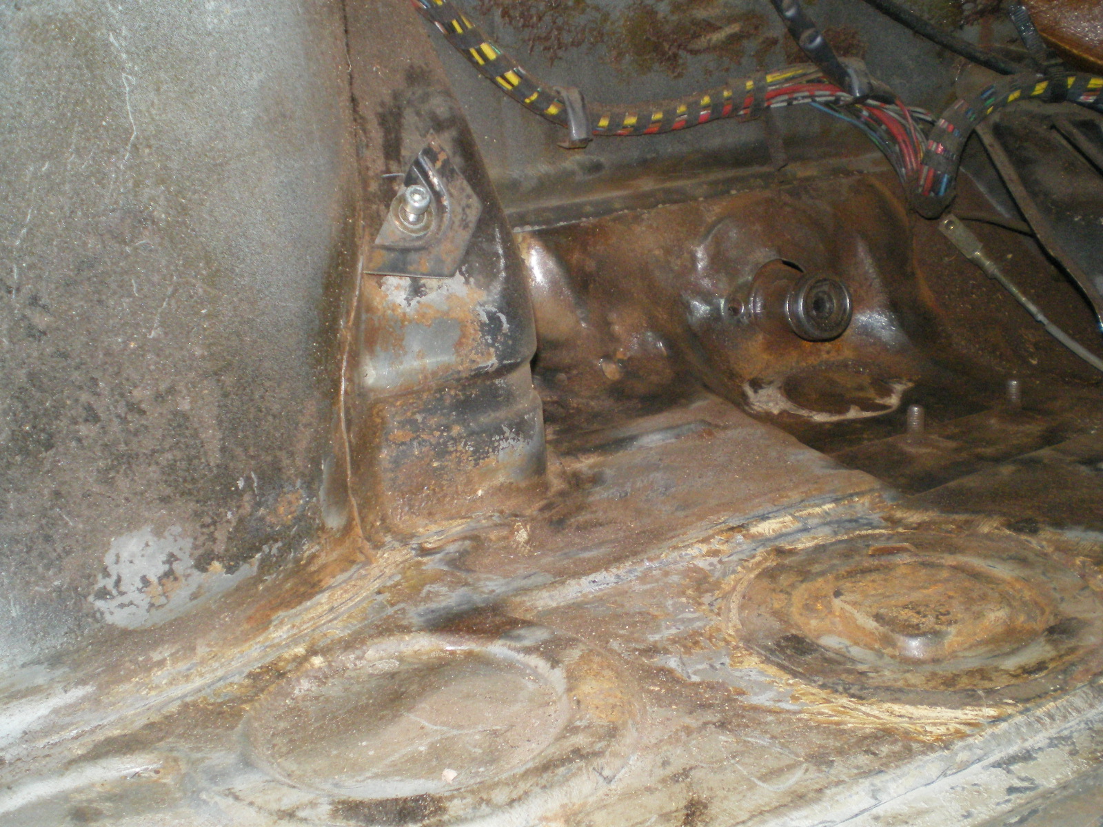

One thing you have to love about these cars is that you can remove an interior in 15 minutes. 30 min's if you have a console. This was one shot before the interior is gutted.

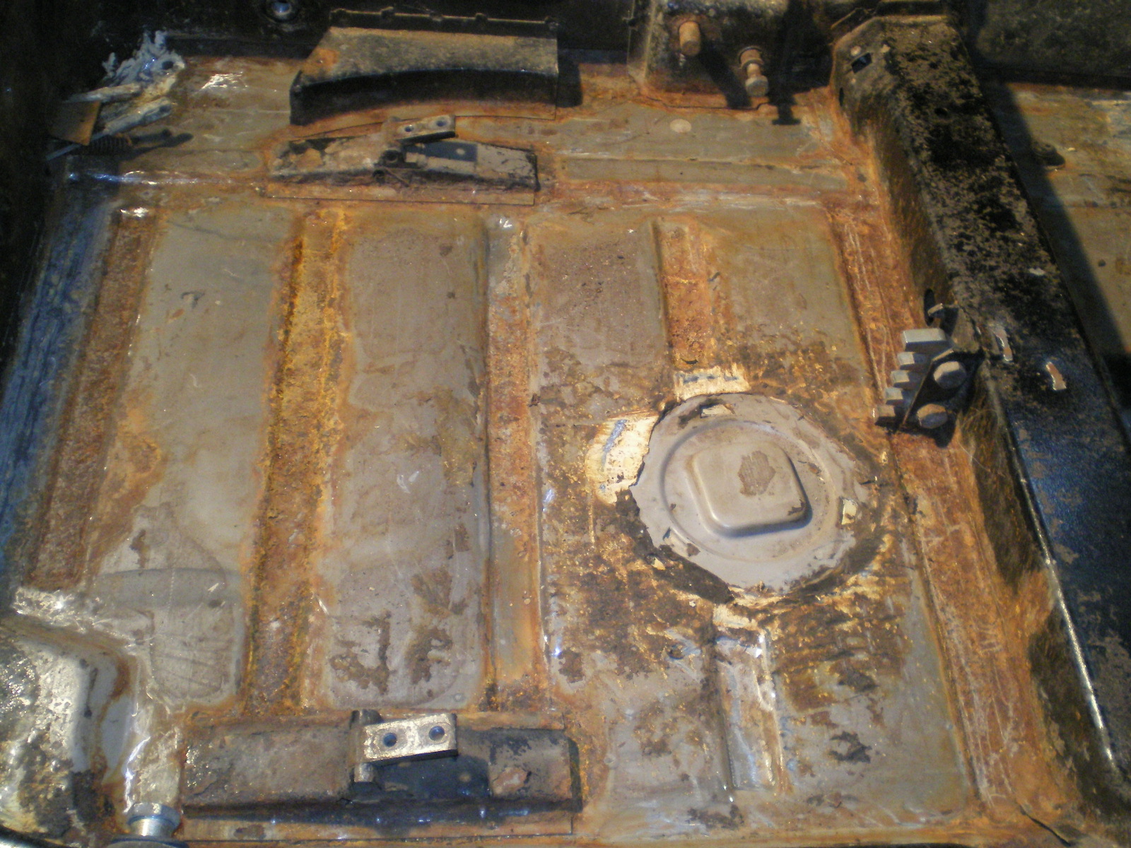

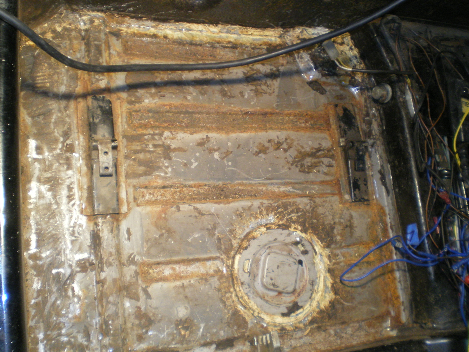

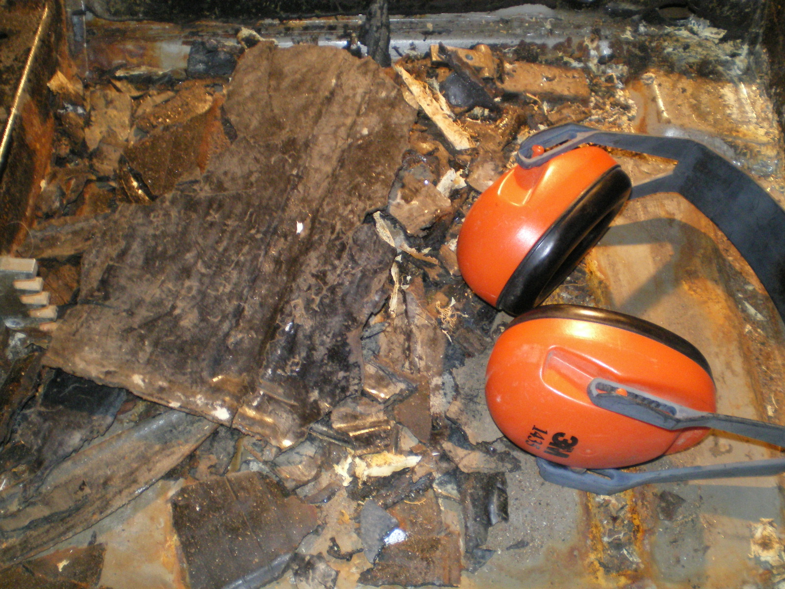

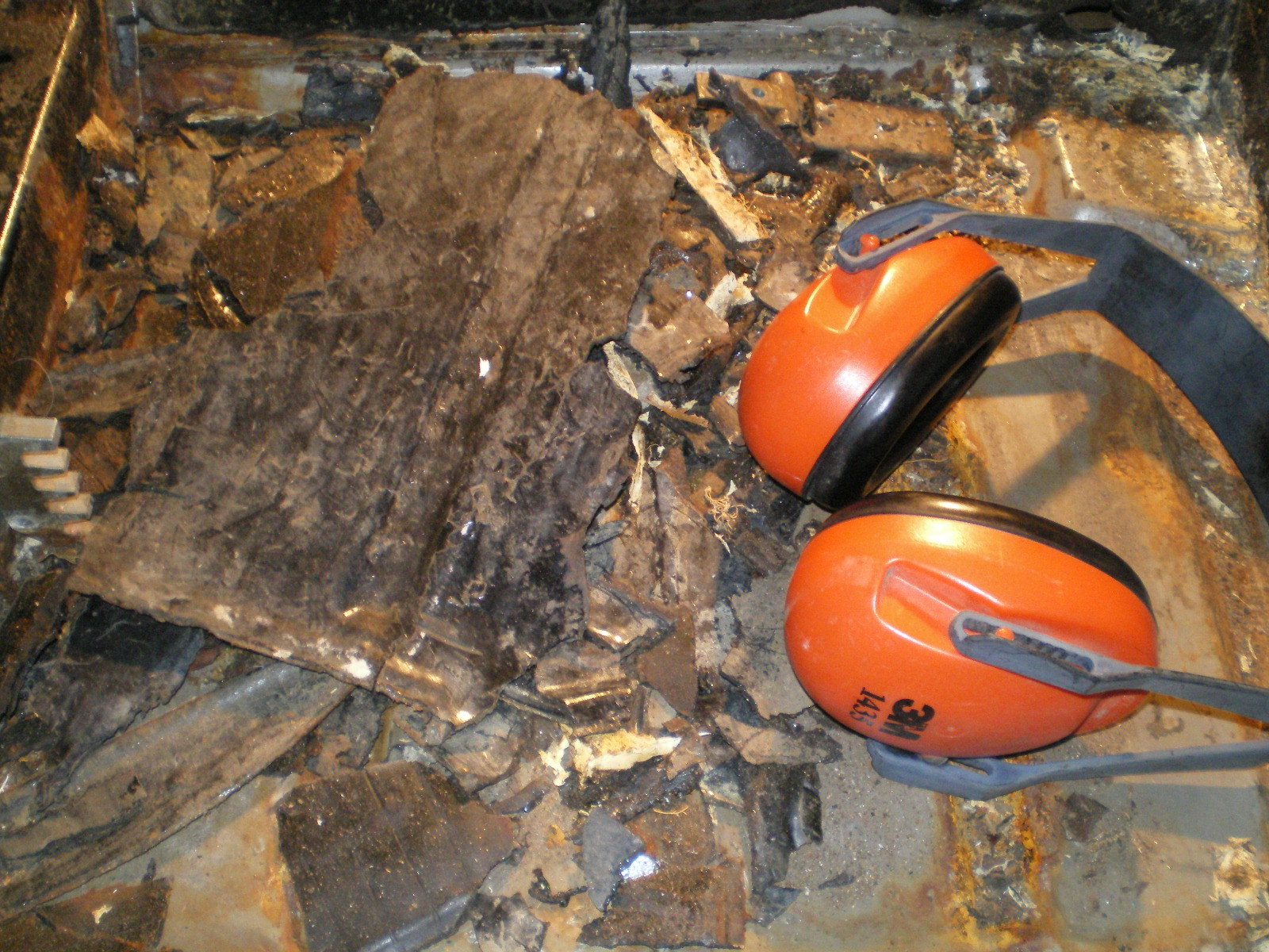

and an hour later I'm scraping tar floorboards.
76-914   '73 Resto & Suby 6 Conversion   Jan 9 2013, 10:21 PM

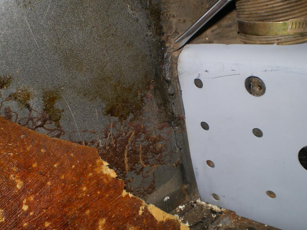

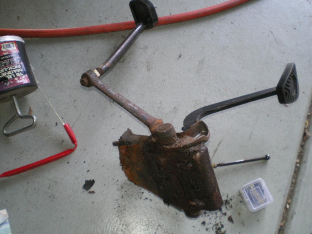

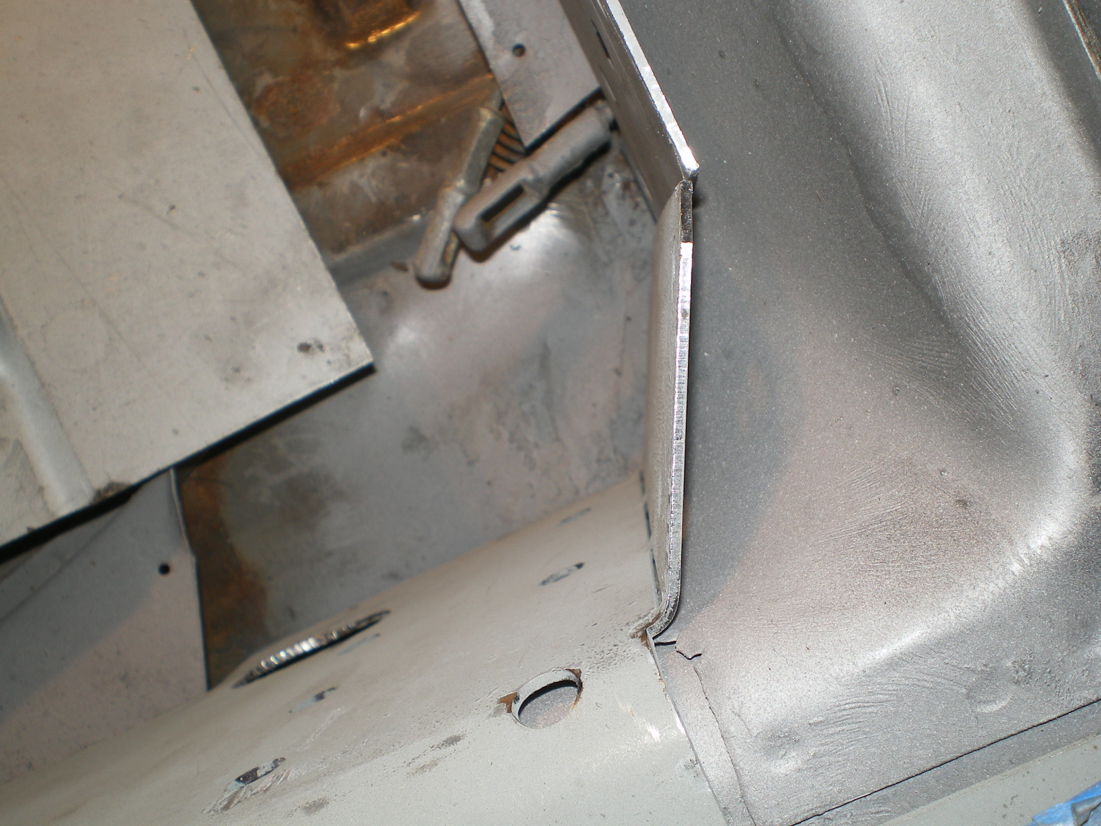

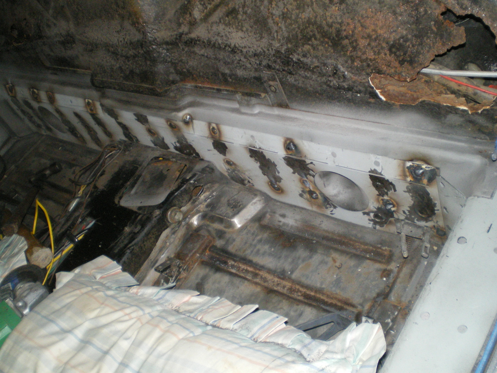

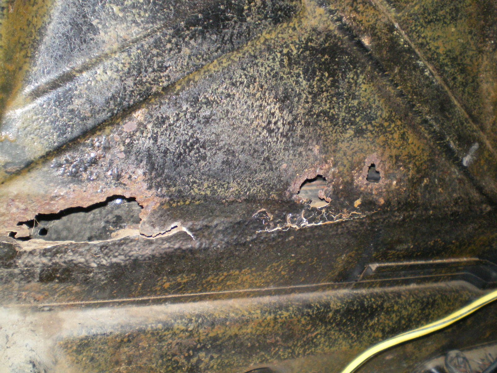

76-914   So after a couple of hours this is what I found be...   Jan 9 2013, 10:22 PM

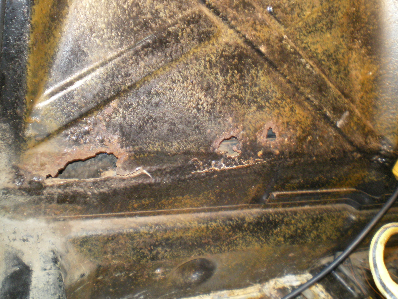

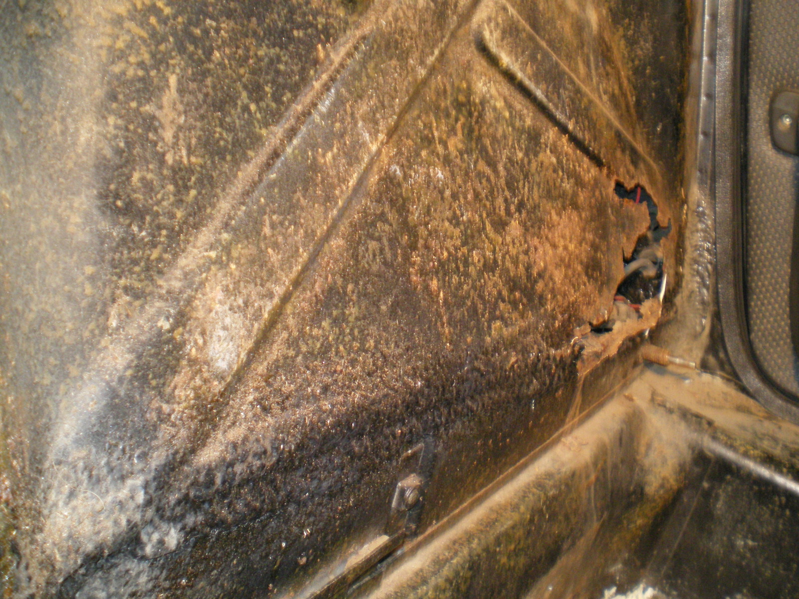

76-914   So the pans look great but look what I found. I ha...   Jan 9 2013, 10:33 PM

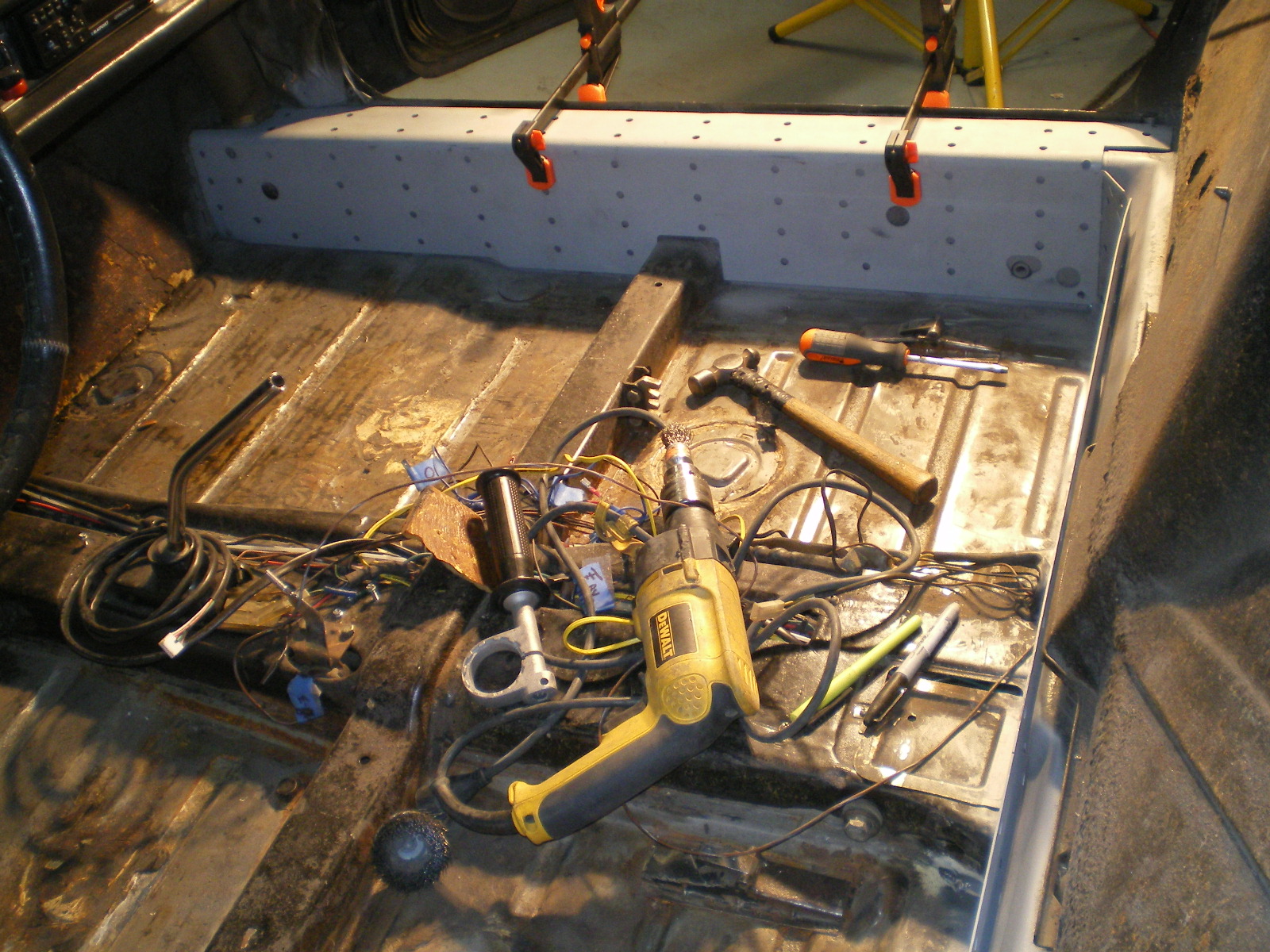

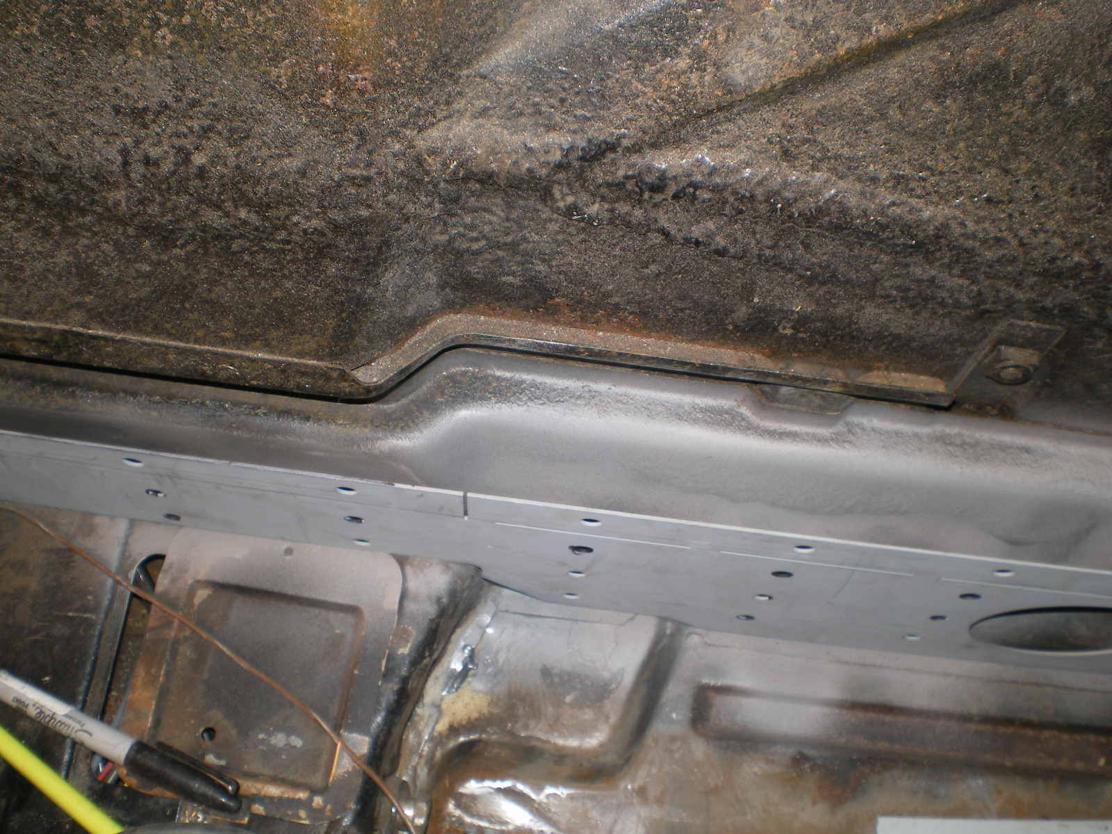

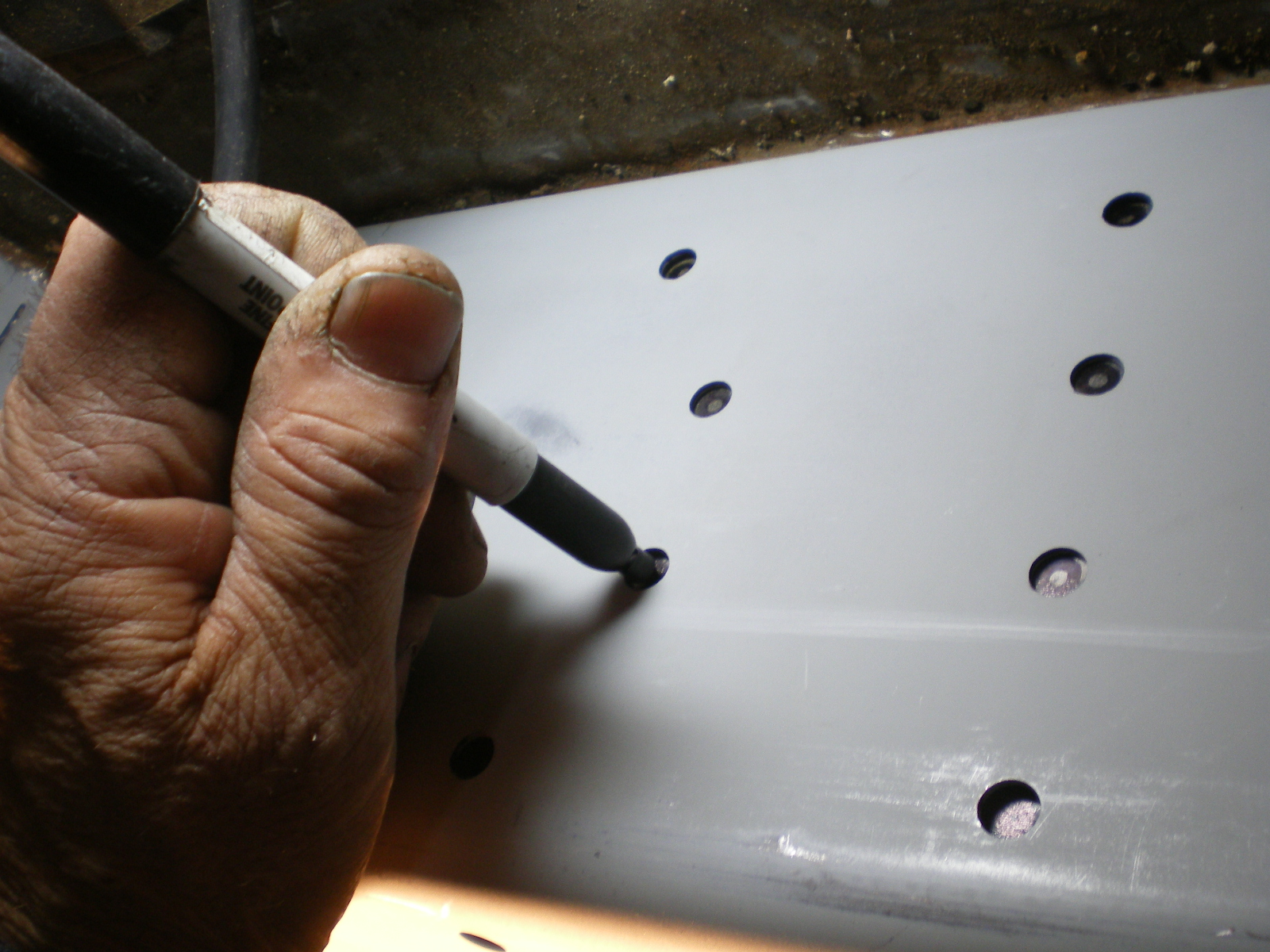

76-914   Before the fitting can happen I need to locate the...   Jan 12 2013, 09:17 PM
76-914   So, weld areas are sanded, cleaned and hit with so...   Jan 12 2013, 09:18 PM

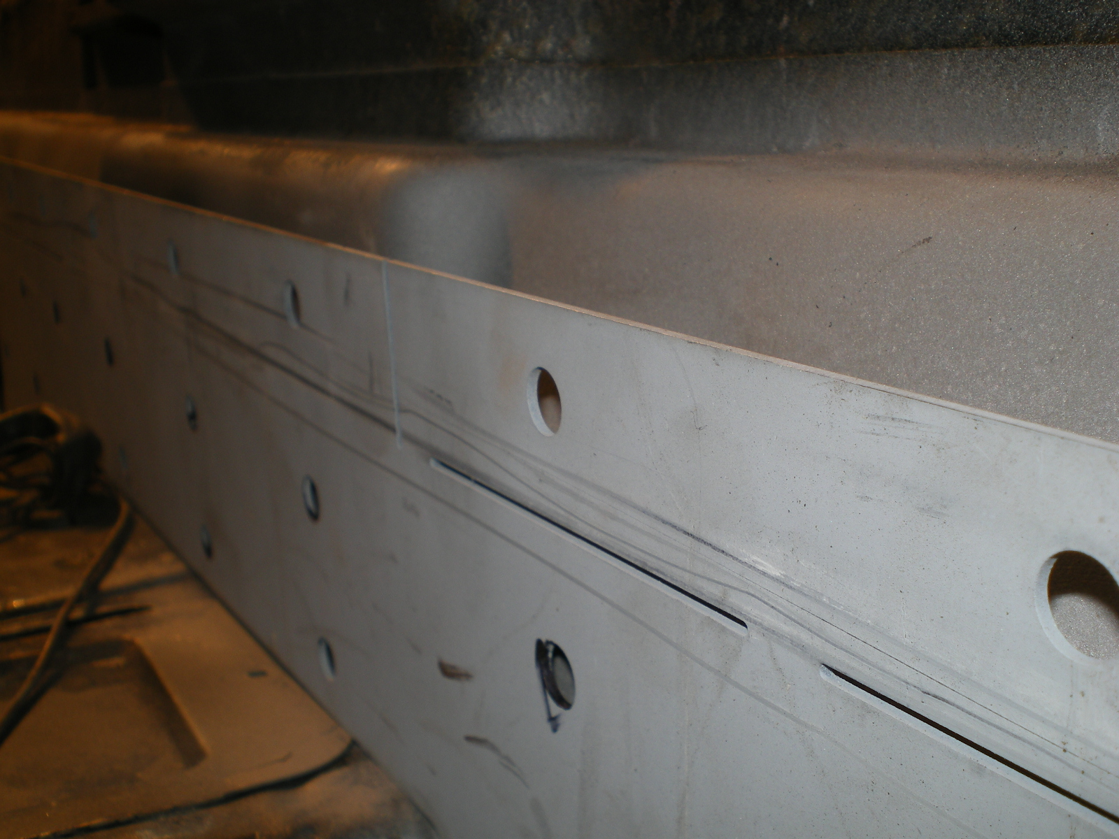

76-914   There are places that need to be bent or formed an...   Jan 12 2013, 09:38 PM

Elliot Cannon   You actually trust those jack stands?? :screwy:   Jan 14 2013, 06:38 PM

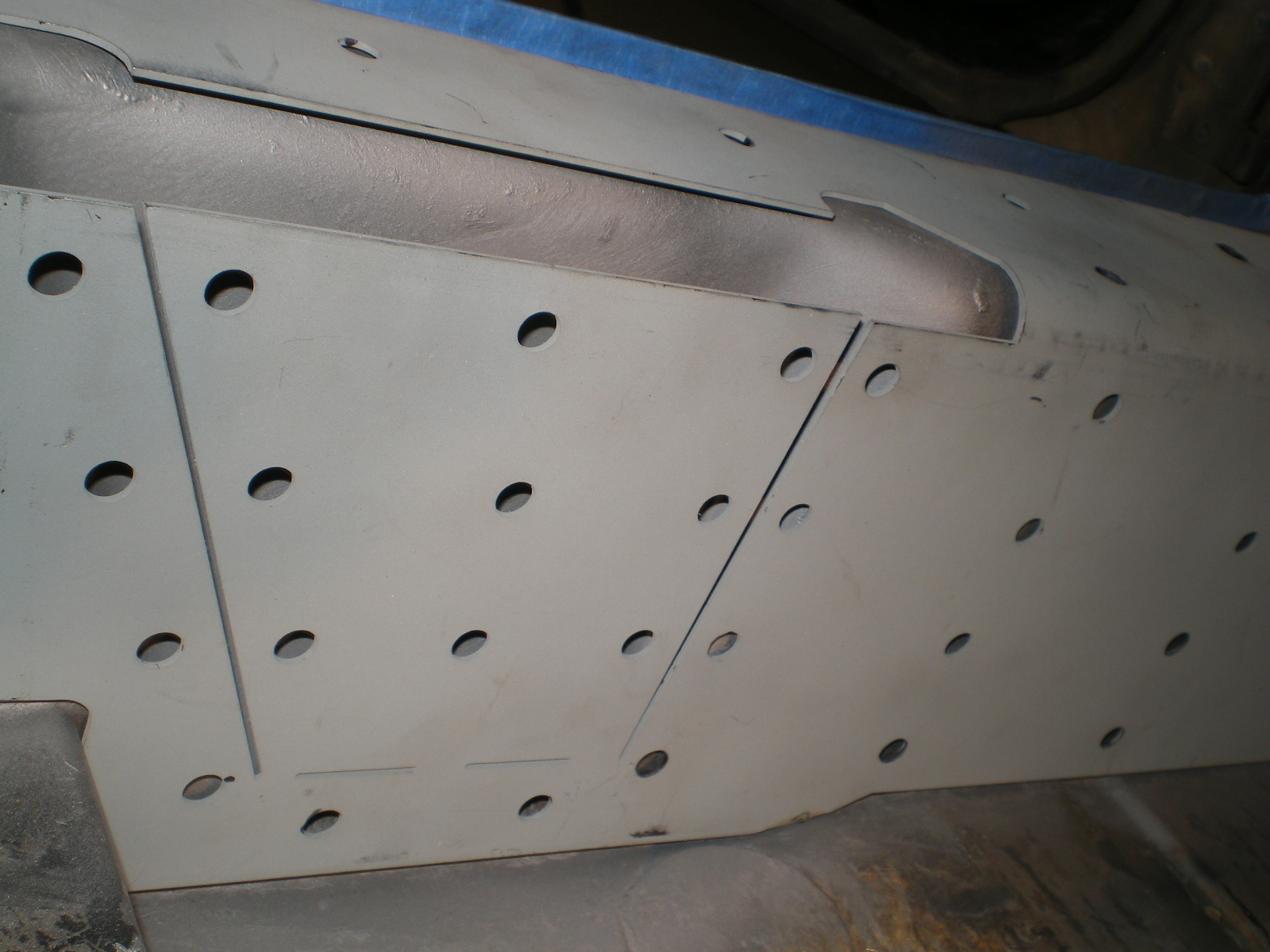

76-914   I got around to welding on the r&l long stiffn...   Jan 20 2013, 10:05 PM
76-914   When I was banging around bracing the panels with ...   Jan 20 2013, 10:06 PM

76-914   I finally finished the welding of the Engman kit. ...   Jan 22 2013, 09:01 PM

mepstein   Your "jack stands" scare me.   Jul 11 2013, 08:18 PM
