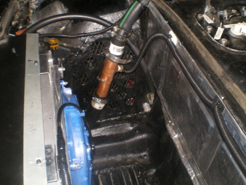

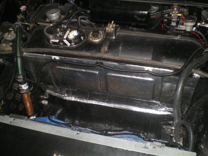

I was able to squeeze in a quick run this evening after reconnecting the hoses and topping off the coolant. The new radiator added about 1 qt to the cooling system capacity. I let it idle about 10 min. and the Subie factory gage was approaching the mid point i.e. operating temp, when I pulled out of the garage. I drove around the hood for 10 min's (<40mpn & 55F) and the needle never moved nor did the fans kick on. Ran it up to 55mph and the fans kick on. Drop to 40 and they go off, and so on.
This is the 1st noticeable improvement. I will pull the fan's fuse before the next run to see what happens to the temps at 55mph+. Either the sensor cut in / cut out is not compatible with this system, in which case I'll go to an after market sensor, or it's time to order some 1 1/4". When the OLD radiator was installed it took several minutes for the fans to shut down after they came on. As stated above, they only came on above 55mph tonite. They also would kick in on the hi way quite often with the old radiator in place. I may find that this isn't an "and/or" scenario but an and/and scenario. More later. (IMG:style_emoticons/default/beerchug.gif)

Today I drove with the fans fuses pulled. I drove around the "hood" for 10-15 mins w/normal stop n go. OAT was 75F and speeds were < 45mph. Engine temp stayed centered. I then hit the Wine Country back roads for another 30 mins. OAT 75F, speeds < 62mph, engine temps still centered. AHAAH I thought those fans were running too much and now I know they were.
All this thought about changing my cooling system began when I installed a light to tell me when the fans were running. I noticed they came on (and off) when on the hi way. The temps were always centered but damn it, those fans shouldn't have been on. I also noticed that if I stopped then started the engine the fans did not come back on, although they had been running 10 seconds before???
So the cut in/cut out factory set points do not appear to be the best set up for my system. Looks like an adjustable fan controller is in my future. I should be able to dial it in quickly as I know what the temp gage should read.
Next test hop I plan to run some realistic hi way speeds 70-80mph with a bit of higher RPM driving to test for 2 things. Both were mentioned in an article that George posted in Chris' thread. One is cavitation the other is high pump head pressure. More later.

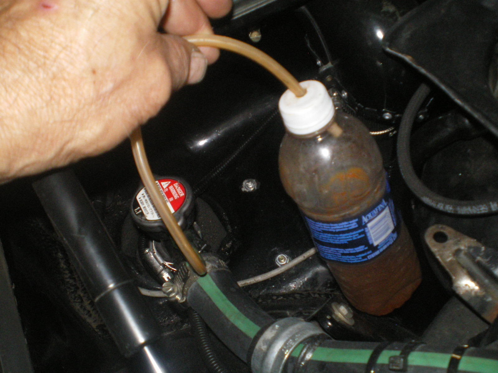

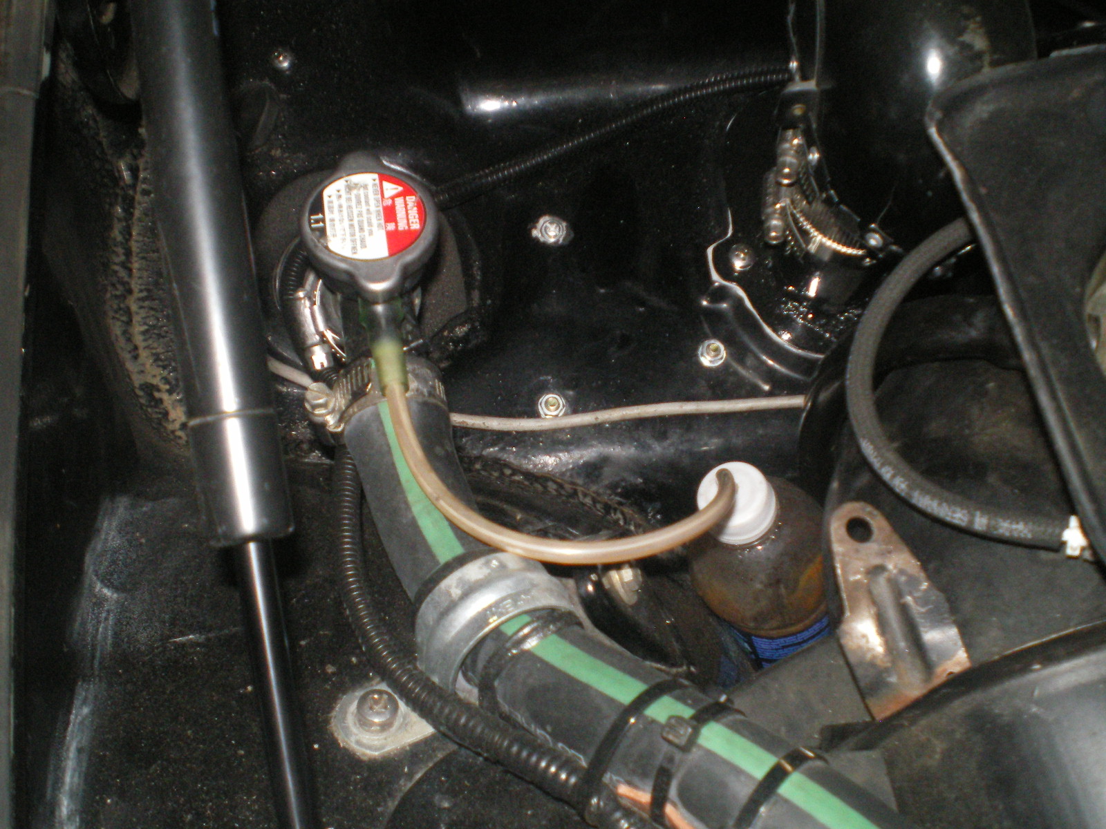

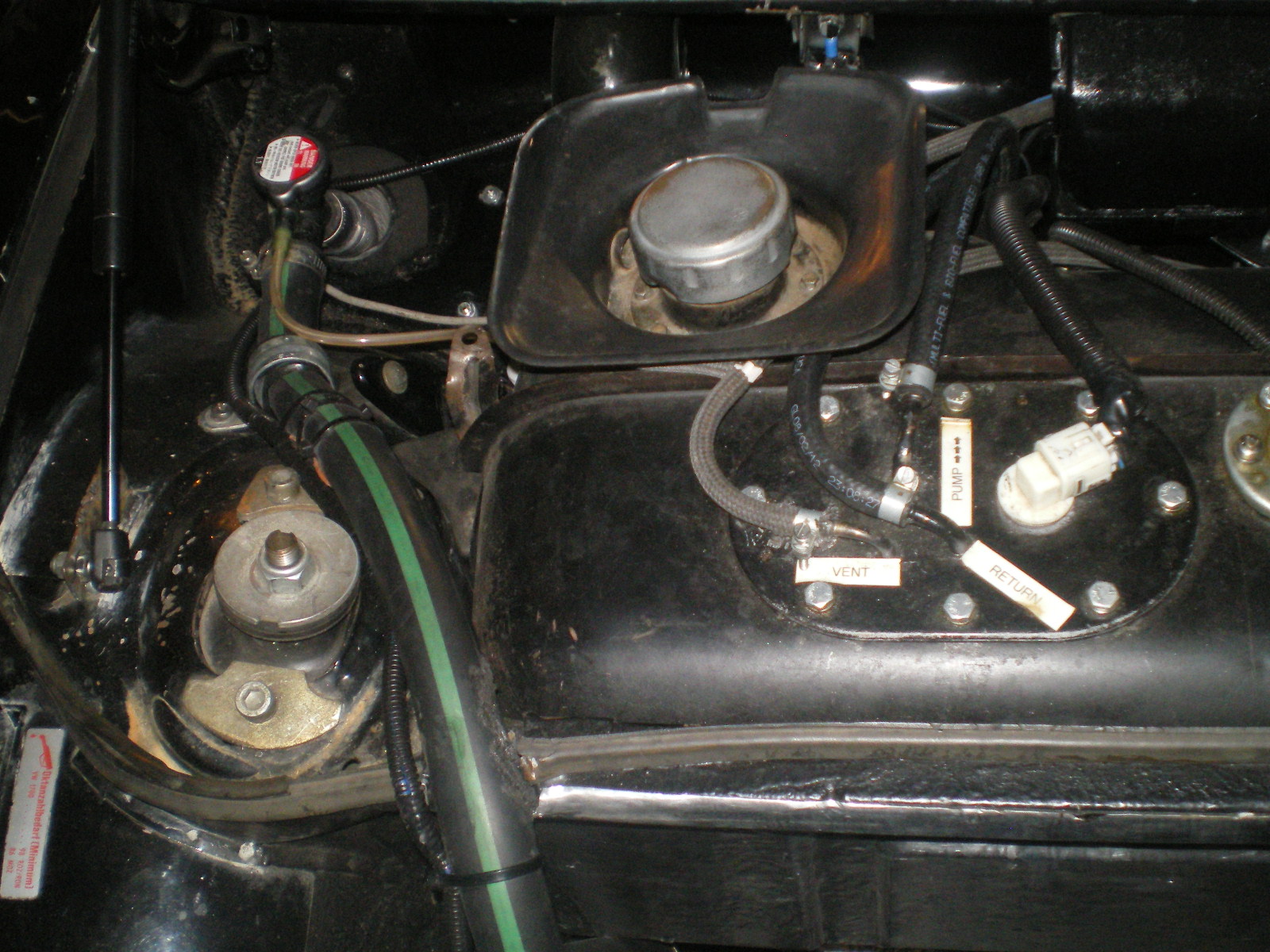

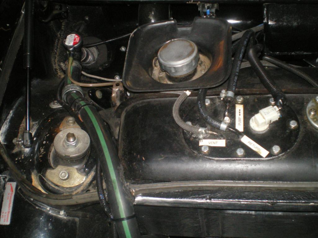

For the few that are following this Boredom Bowl, I will continue to post these uninspiring updates on my cooling system. I'll try to keep these brief until it's complete.
Hit the hi way yesterday for about 40 min's. This hi way has about 6 stop lights along the route and I kept it at 70mph+. Why this test? In reading one of the articles that Stephen posted it spoke of a head pressure build up on the pump. I had noticed this phenomenon early on but wasn't sure what was behind it. Heat or pressure? I used this MC filler neck in the front trunk and noticed a discharge after some hard runs so I poked a hole in the top of this water bottle to catch the overflow.
It was only then that I noticed how much it discharged. No problem. I'd just pour it back in the expansion/recovery tank in the engine bay every once in a while. So now that I know why this happens I want to see if there is has been a change since the radiator swap. I didn't see any discharge w/ this radiator but I didn't "horse it" either. I'm betting 4000rpm+ and I will see it return unless this radiator flows more freely. 70mph is only 2800rpm.
So all this (IMG:style_emoticons/default/stromberg.gif) and what did I learn? Just that the discharge is not constant. I may have the chance to "horse it" this afternoon to see if high rpm is related to that discharge. Seems logical that pressure would increase with rpm. If that's the case, and I suspect it is, I will change hose size. More later. (IMG:style_emoticons/default/beerchug.gif)

We may all end up going this route but I had a pleasant surprise after yesterdays drive. I horsed it around on some back road twisties yesterday and did not have any discharge into the water bottle reservoir. Maybe a little in my pants as a Mountain Lion crossed the road in front of me but none in the water bottle. (IMG:style_emoticons/default/blink.gif) Previously high RPM's preceded (not ready to say caused) this discharge. Absolutely no reason for this unless the newer radiator has < flow restriction than the old one. Maybe the 3/4" return IS ample. Regardless, it's time to throw the condenser back into the mix and see what happens next. (IMG:style_emoticons/default/beerchug.gif)

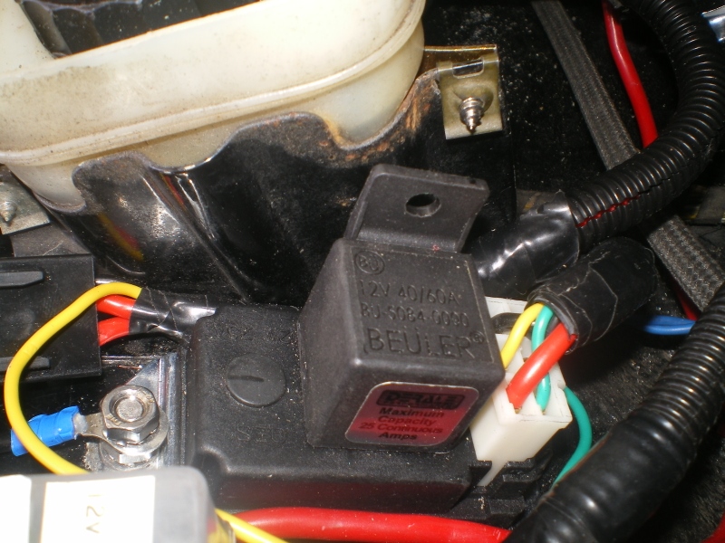

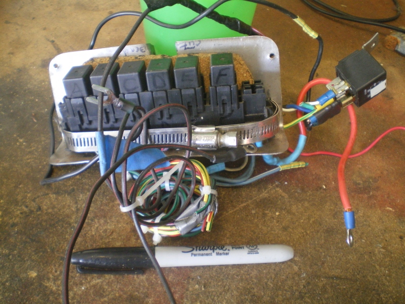

No apparent changes to the indicated temp since throwing the condenser back on so I installed the Derale fan controller. The factory ECU was not shutting the fans down once they activated so I'm hoping this unit will produce favorable results.
It's quiet compact:
Compared to my old Rat's Nest.
Just needed to make this Tee for the sender and I was good to go. Look out Rt 66!
