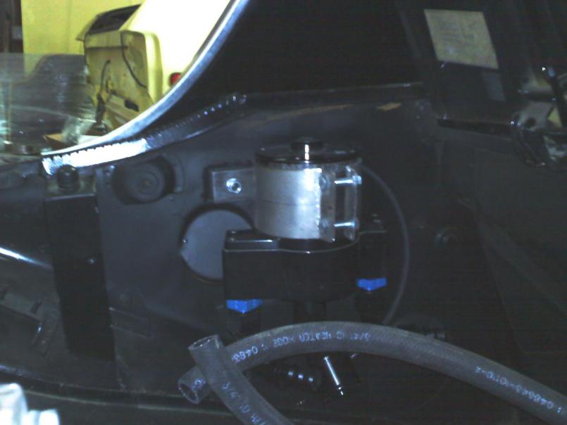

You can use a Meziere pump and mount it in a remote location. If you bolt it to the block it will hit the firewall. The Meziere has one inlet and two outlets. You connect it to the water pump inlet passages on the block with 90 degree fittings.
Picture of a Meziere remote pump
(IMG:http://www.914world.com/bbs2/uploads_offsite/www.meziere.com-13632-1358775847.1.jpg)
(IMG:http://www.914world.com/bbs2/uploads/post-12479-1299724114_thumb.jpg)
Fittings You will need
(IMG:http://www.914world.com/bbs2/uploads/post-12092-1349377478_thumb.jpg)
Another option is to use the dedenbear water manifold and dedenbear remote pump.
(IMG:http://www.914world.com/bbs2/uploads/post-13632-1349395275.jpg)
Both the Meziere and dedenbear units are expensive but both have useful lives of over 3000 hrs.
Neat thing about the remote pumps- it allows you to use the stock fuel pump.
Another pic of the Dedenbear set up.

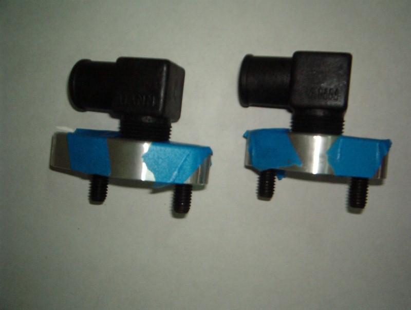

I have two fittings for sale if you need them-
(IMG:http://www.914world.com/bbs2/uploads/post-13632-1345679355.jpg)
Water Pump/block Fittings SBC

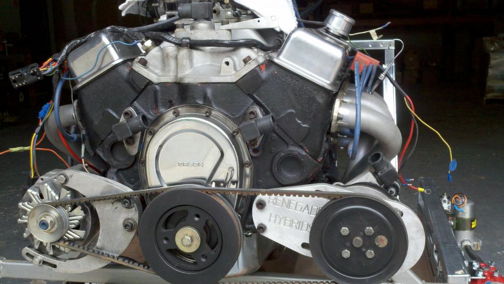

I've been using the Dedenbear pump (my engine with the yellow oil pan above) for almost 10 years and around 10K miles without any problems. These pumps can be rebuilt with new seals and brushes but I've never had a reason to take mine apart.
