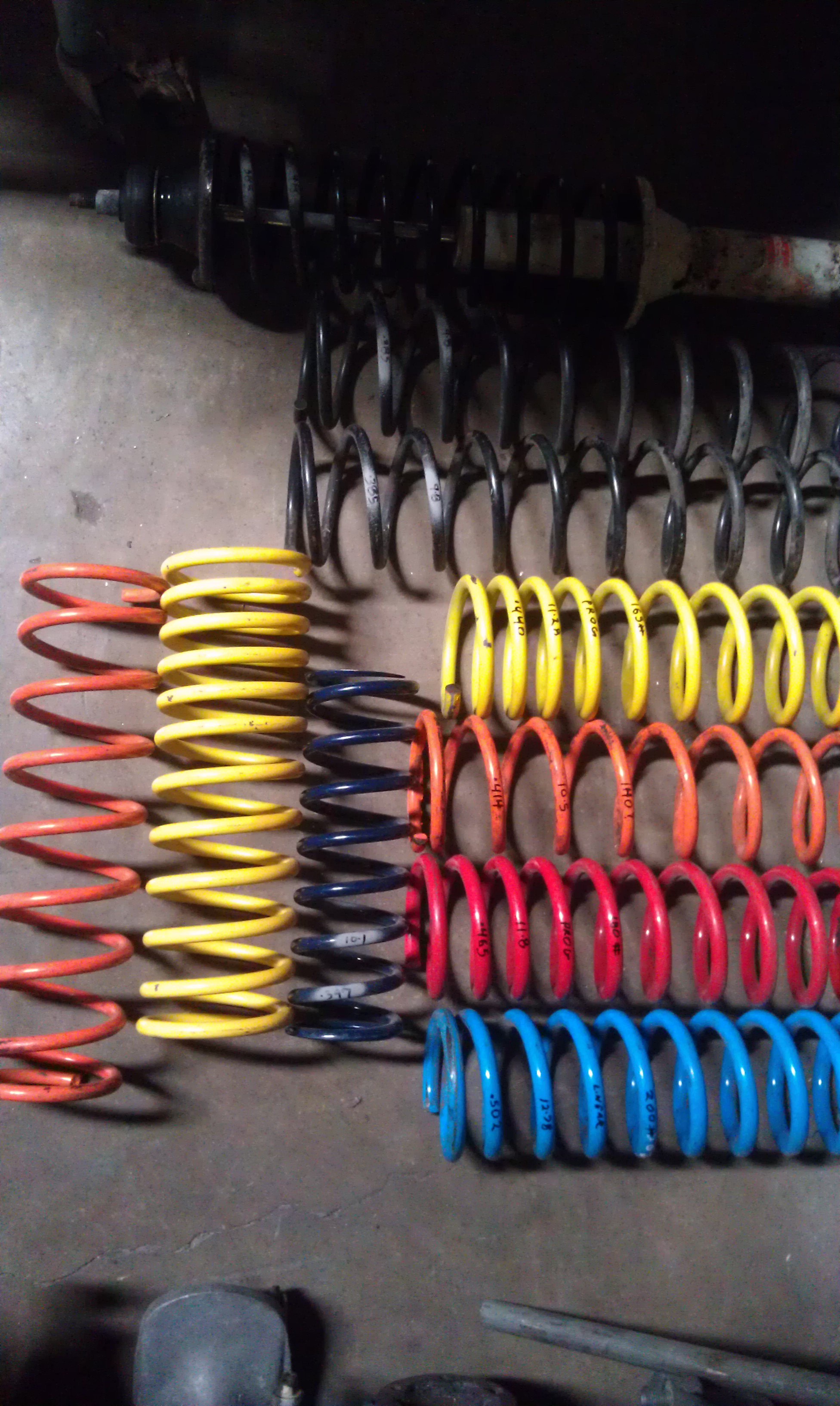

> rear spring data, spring dia vs spring rate
sean_v8_914
post Jan 25 2013, 12:03 PM
Chingon 601
Posts: 4,011
Joined: 1-February 05
From: San Diego
Member No.: 3,541

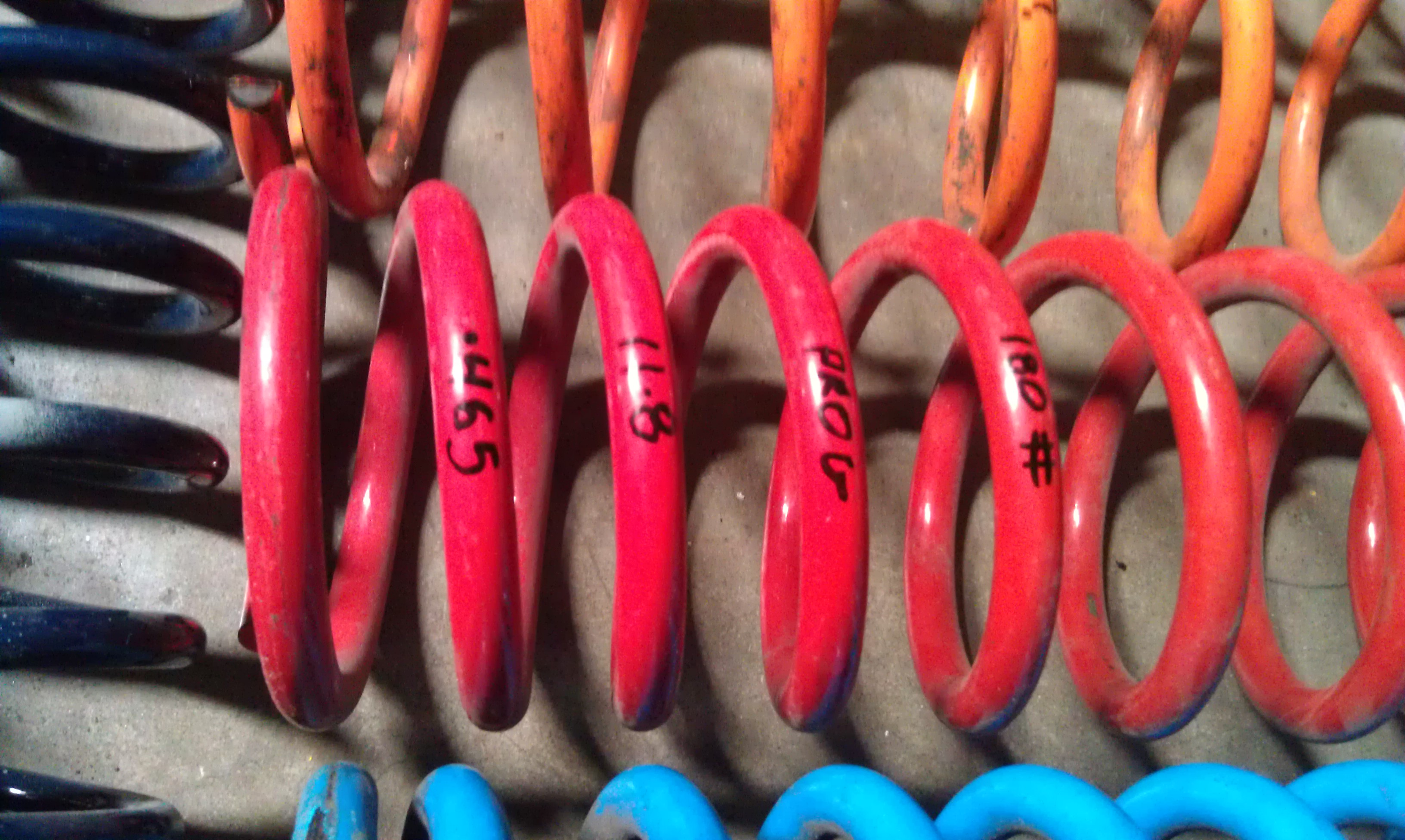

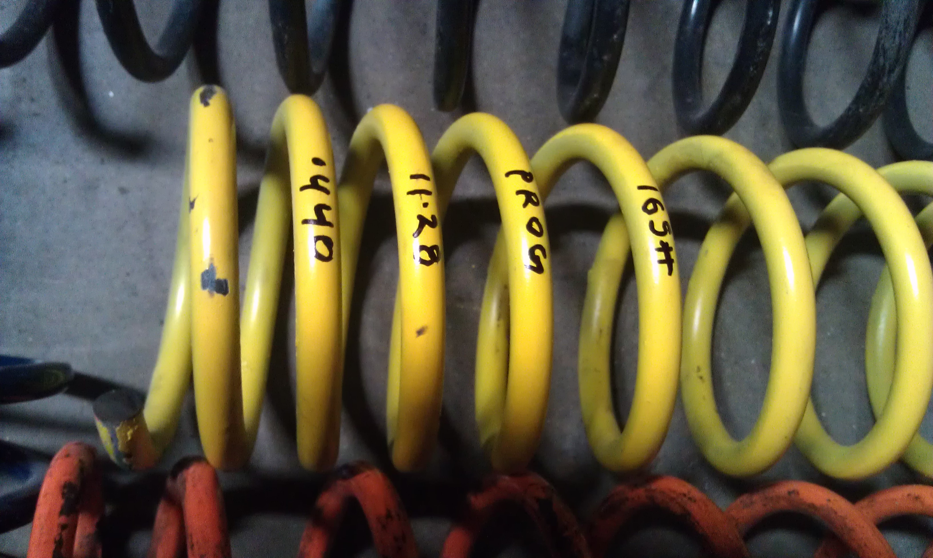

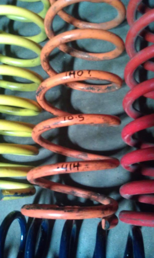

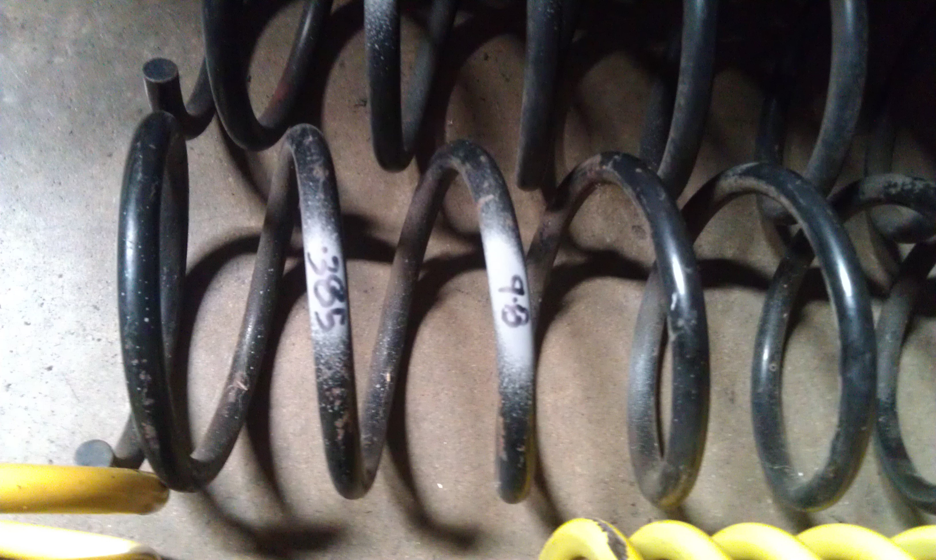

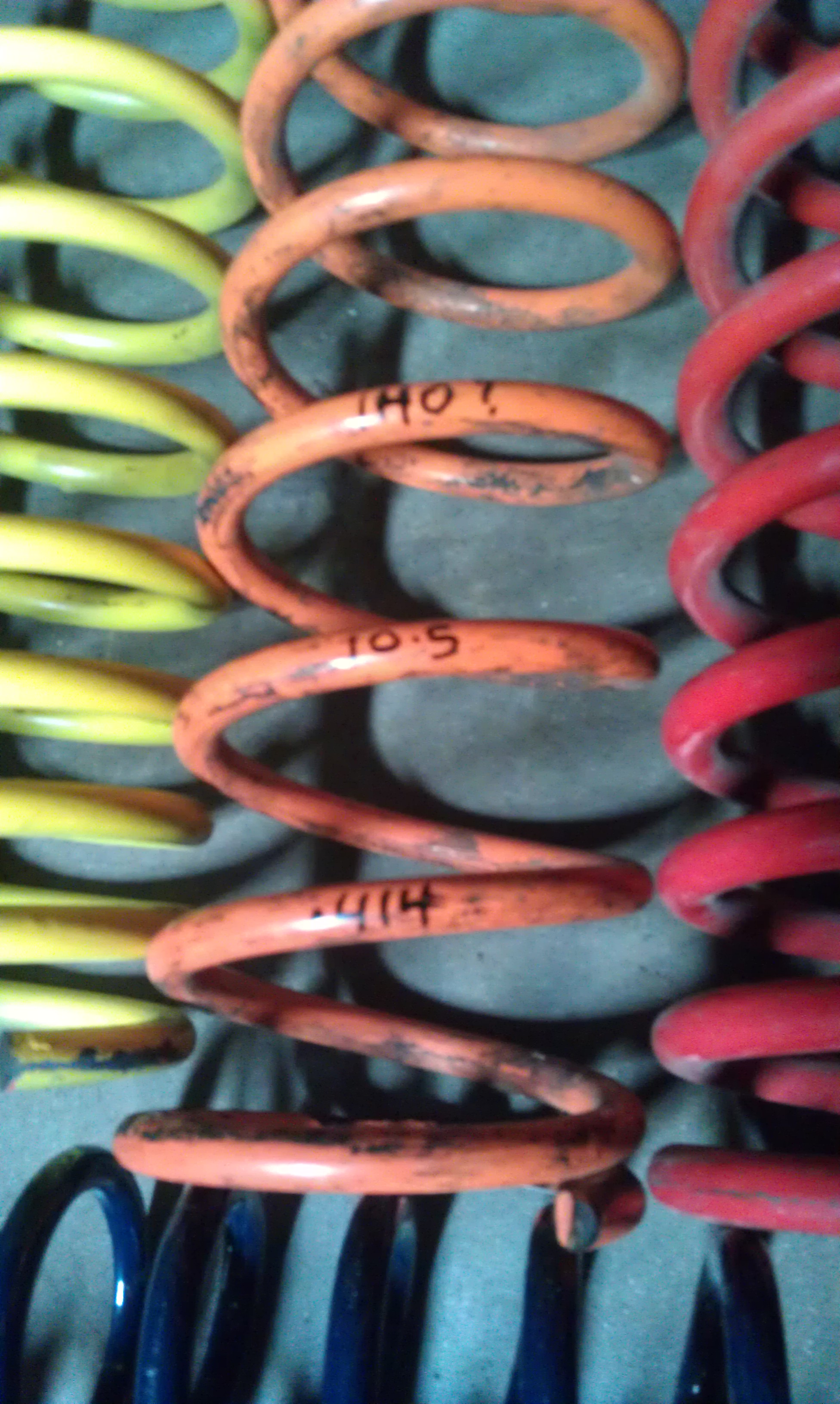

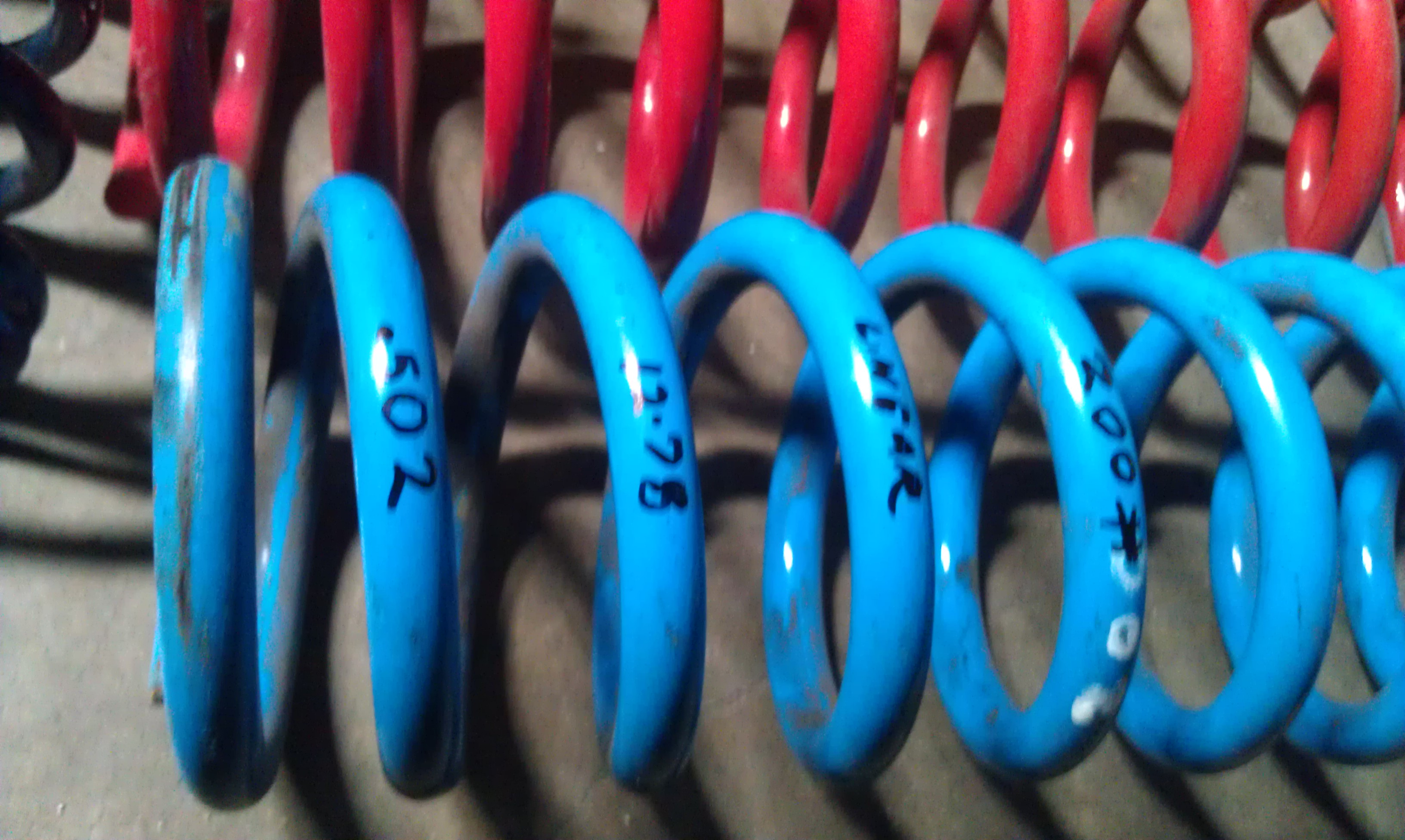

inches, mm and spring rate if I knew it at thje time

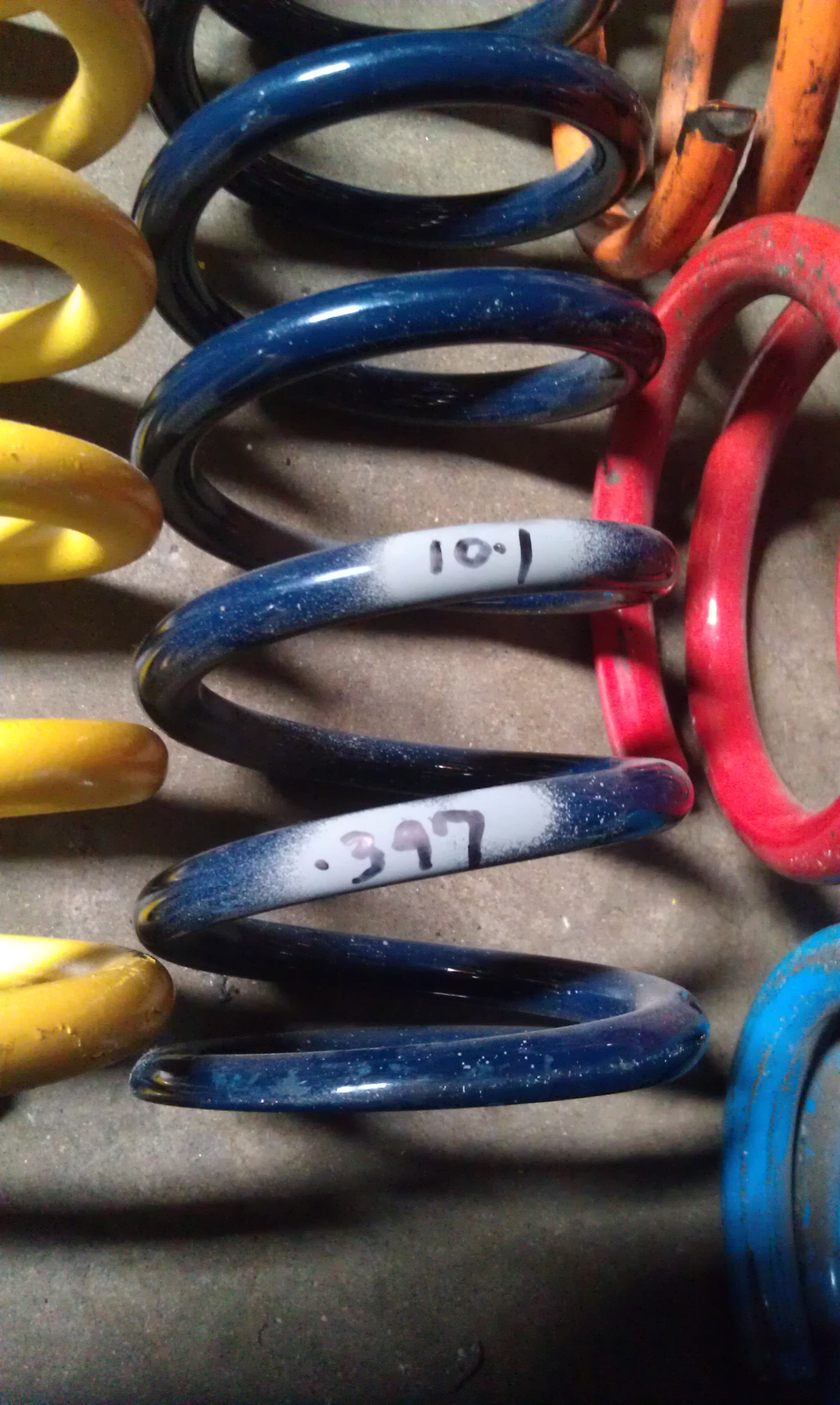

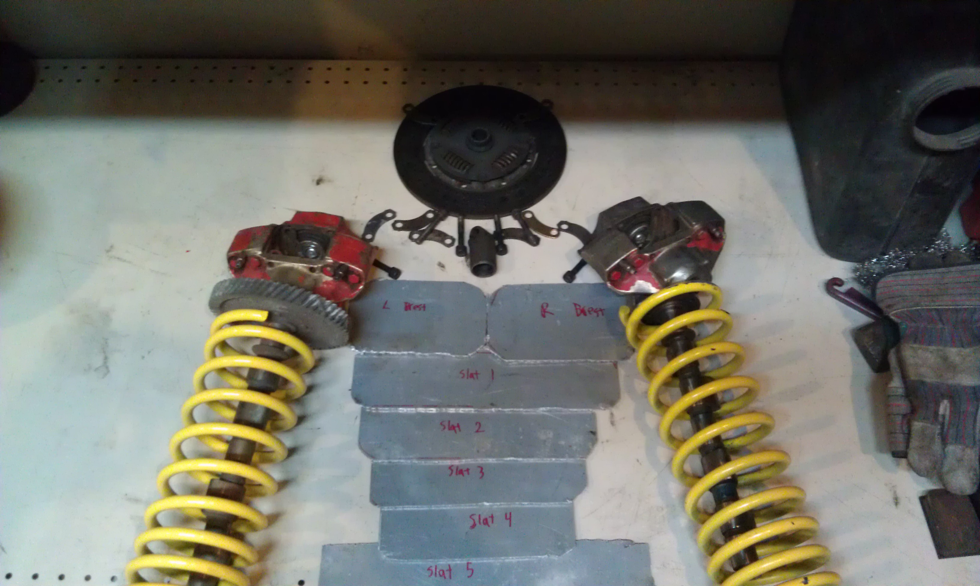

hyper coil is 2.5 inch x 10 inch 175# linear
10.1mm or 0.397 inch
