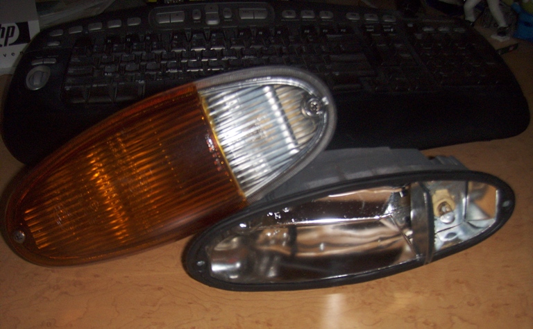

Her is what the euro buckets look like. These were advertised as NOS euro buckets and will go on my-6
