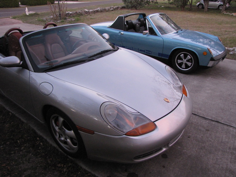

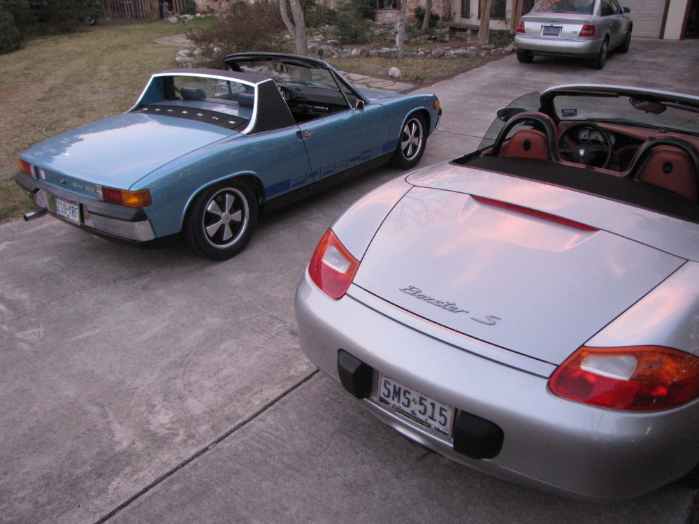

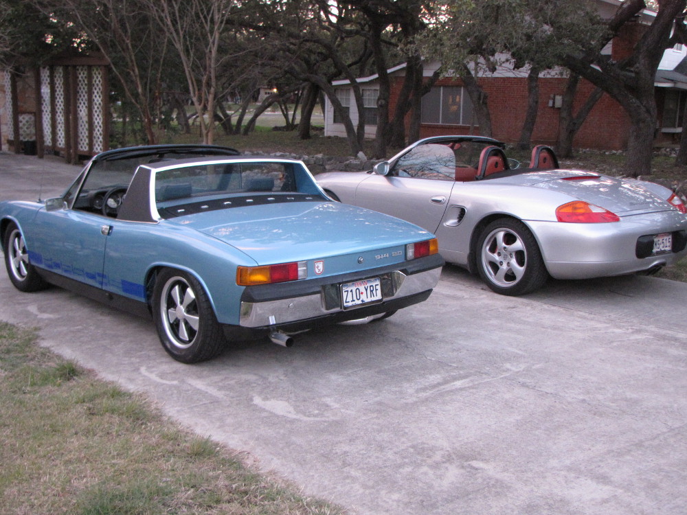

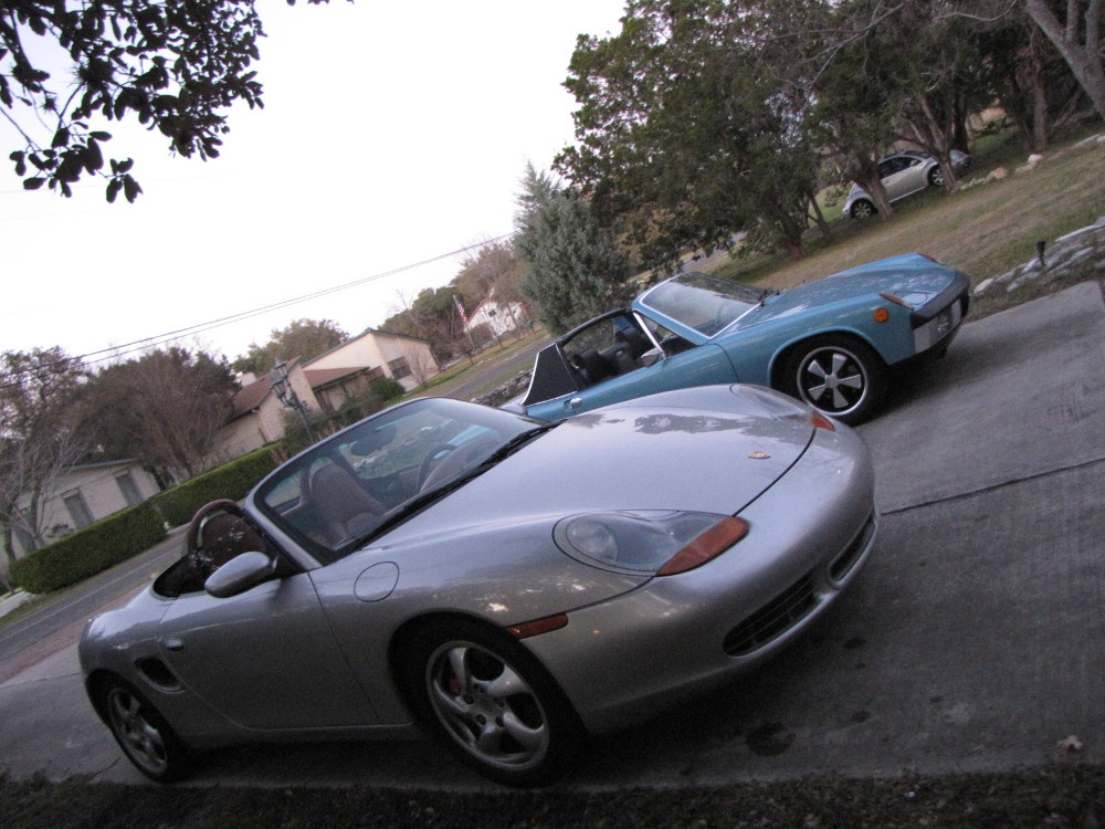

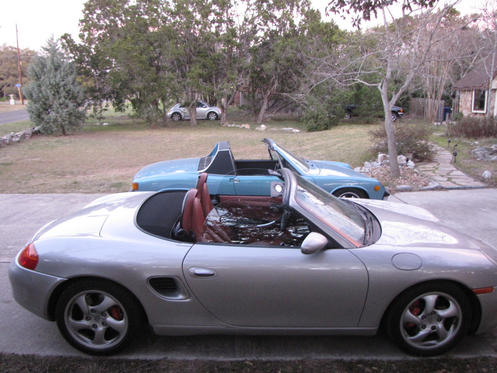

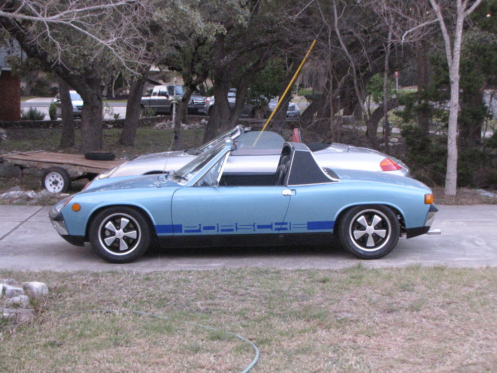

I finally had time to put my Boxster alongside my 914 for some comparisons.
It was getting a little dark, but the pictures are still decent.
37 Years of difference, but they do not drive so different.
Attached Image Attached Image Attached Image Attached Image Attached Image Attached Image
