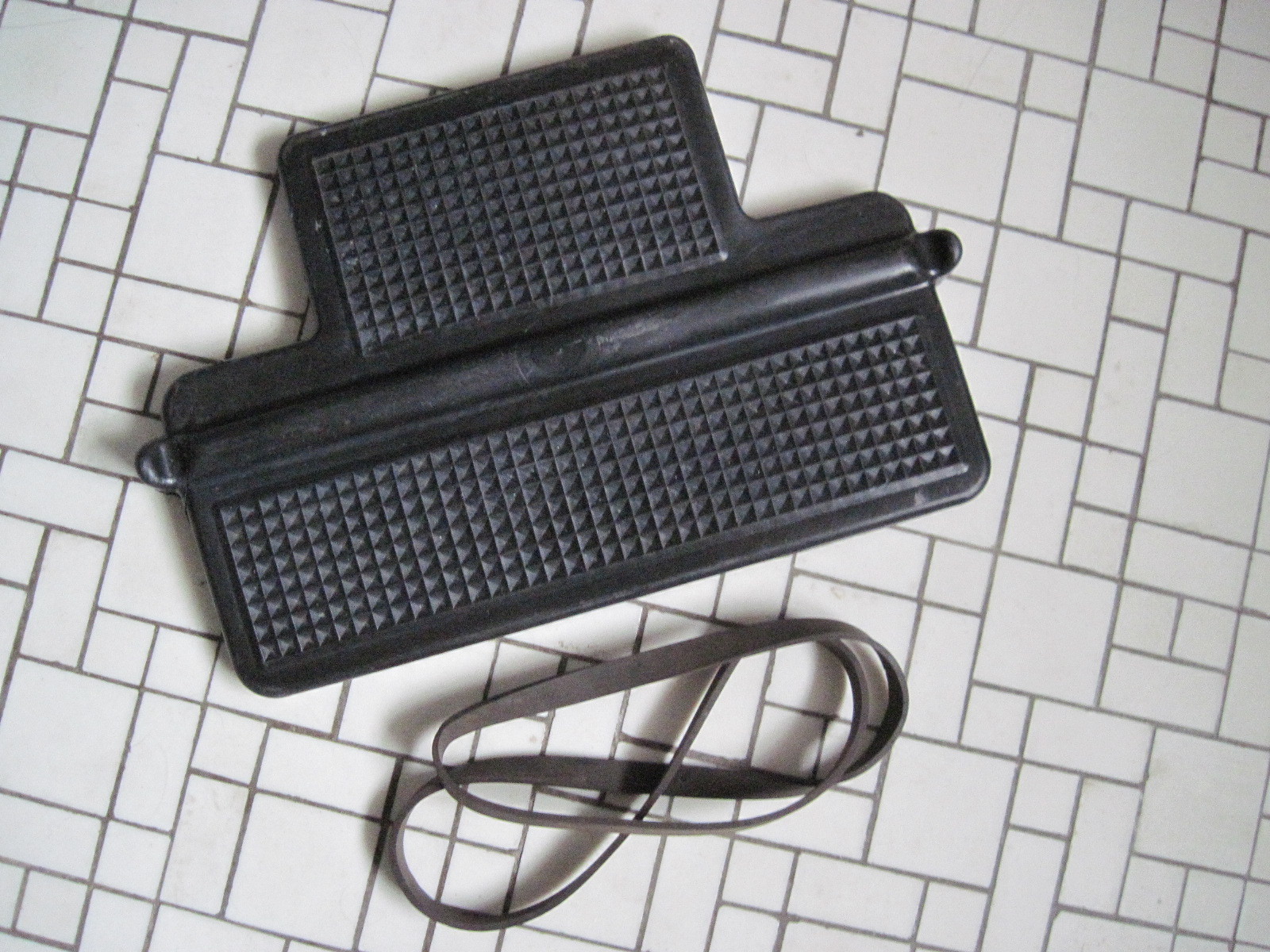

Hey Jeff, I noticed there are TWO different factory plastic battery covers.
The first one (borrowed from your link) is the HO cover (what does HO mean anyway?).
The latter one the original battery cover and replacement.

The top photo was the one supplied in the recall kit. The bottom photo is the battery cover originally supplied with the car.

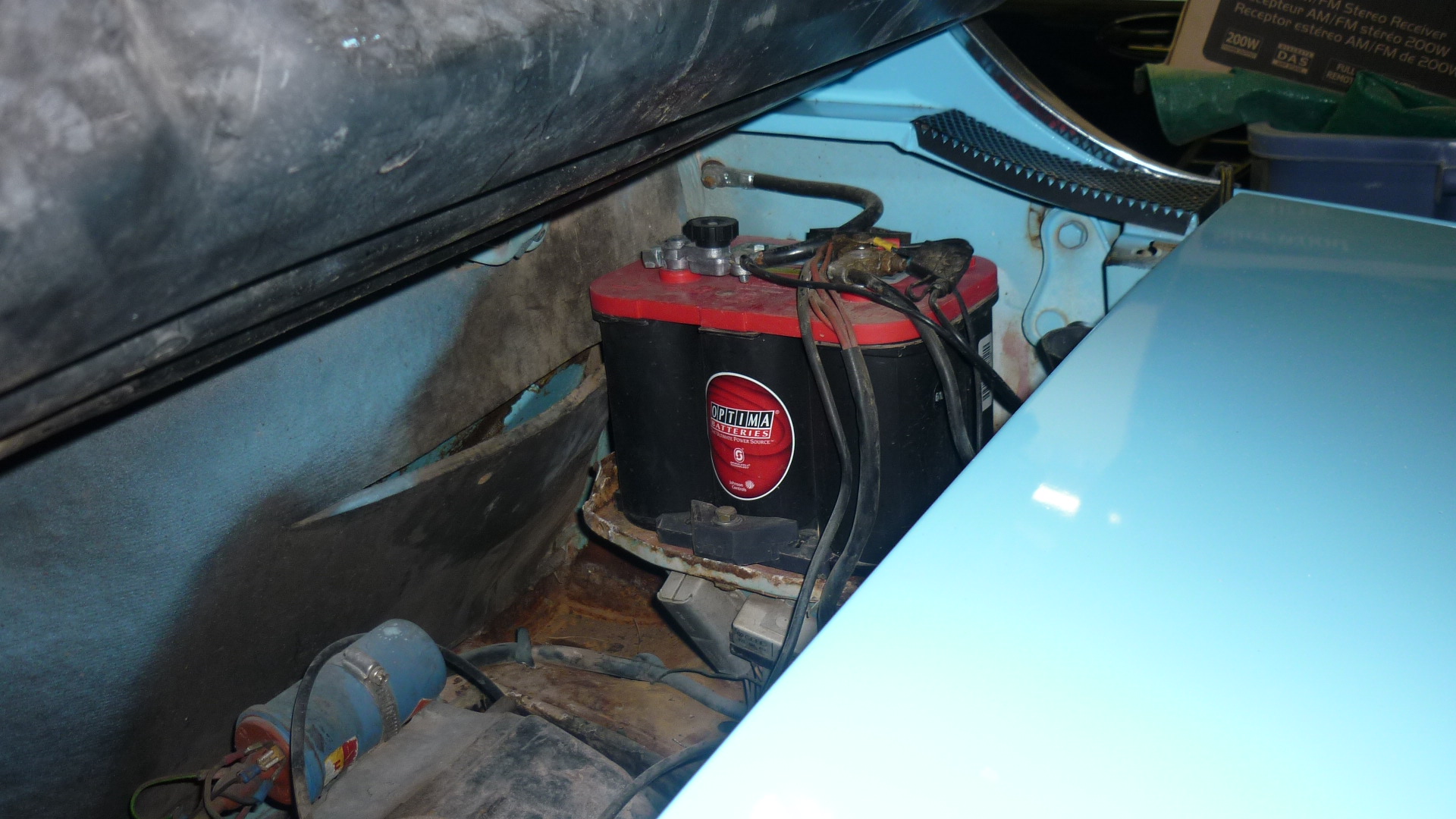

Just my .02 on batteries--I have had really good luck with Optima Red Tops, and have not had one go bad despite it getting drained from lack of use a number of times (before battery tender purchase). My oldest one is now 6+ years old, still going strong, even though I drive the car it is in very infrequently.
In the teener I have a 34R Optima Red, and with the hell hole issues, I can't see why anybody would use a normal lead acid battery--it seems like false economy to me. Especially if your hell hole has been repaired (mine hasn't yet...)

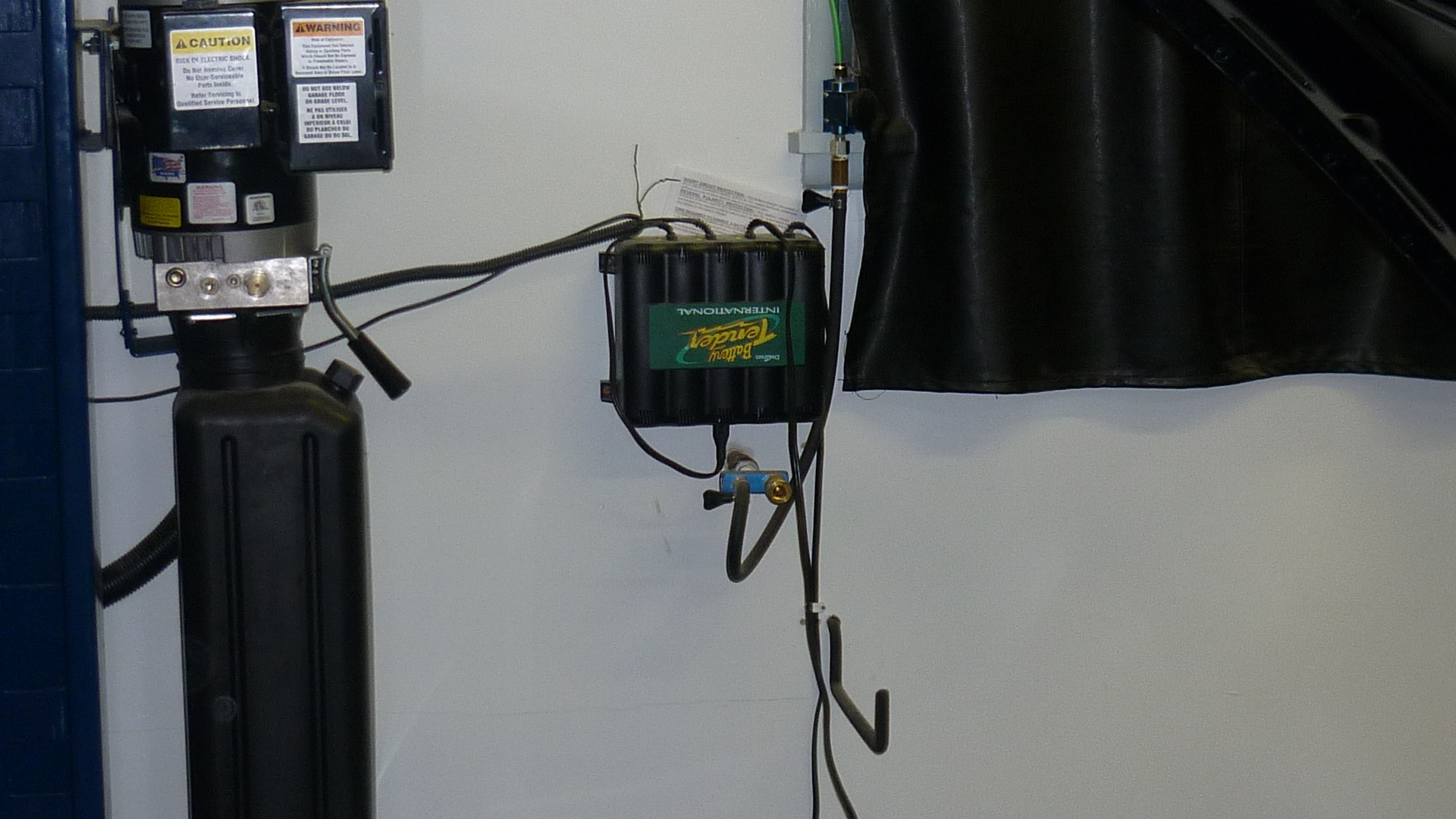

A battery tender is definitely a great upgrade for anybody who does not drive their 914 often--no more ruining your cruise day when it doesn't start. I only have experience with the Deltran Battery Tender (version with 4 leads for all the toys), but it works on the Optimas and the lead acid batteries, and I have not had a problem with mine in over 2 years of continuous use. I read somewhere on the internet (it must be true, right?), that Optimas have the potential to last decades if kept on a good trickle charge and not overheated, etc.
Attached Image34R Attached Image TenderAttached Image Toys (IMG:style_emoticons/default/aktion035.gif)
