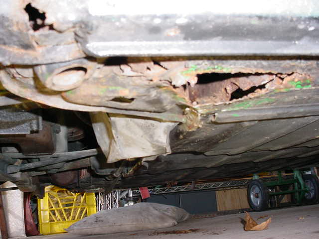

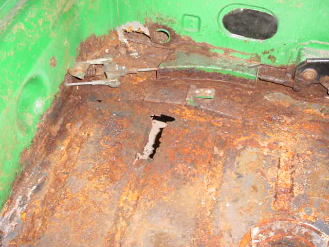

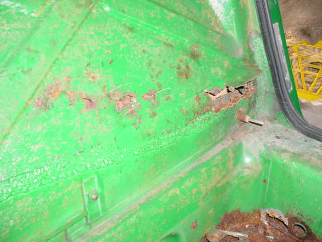

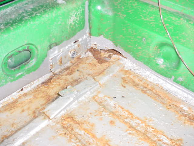

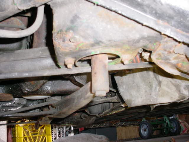

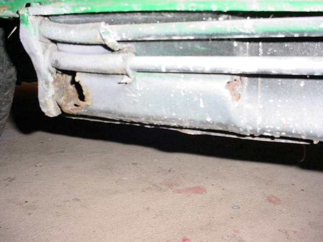

Purchased my first 914 a few weeks ago. I found some rust while looking it over but after taking off the soundproofing and really getting a better look, i found a good deal more rust than I expected. Looking for suggestions how to attack this. I have a mig and can weld a little. Was planning on building a rotisserie to do the work. If I had a better idea of how much rust I was looking at I probably would have passed on the car.
Would appreciate your suggestions as to how to plan and go about the work. How tough is it to do the entire rear floorpan on a unibody? The driver's long has a patch that is solid but I'm not sure what it is covering up. I can guess it's not too good. On the positive side I found over six dollars in change, mostly undre the e-brake. Thanks in advance.

Larry, it does not look good. Mine needed a lot of rust repairs requiring a lot of work, but yours looks much more severe. If you're going to attempt this yourself, what I would do first is strip the car down to the tub and take it to be media blasted. Then start cutting out the rusted areas, or better would be to cut the spot welds and replace complete sections with new (or from a donor car). Smaller areas it's possible to cut out the rust and replace with 18 or 20 gauge cold-rolled steel. But with the amount of work required maybe it would be a lot easier and cheaper just to buy a roller in good condition. Whatever you decide to do, good luck.

Replacing the pans isn't too hard really, just drill out all the spot welds and remove the pieces. Some pieces you will have to reuse or make so save them. The pans are readily available from Restoration Designs.
The Long should be repaired at the same time but how are the trunks? If they are rusty then I would strip the car. If not then just replace the pans and repair the longs.
Alas, one of the cardinal rules of buying old cars is rust is always worse than it first appears. This one looks pretty bad. In California, that would be considered a parts car, and would probably end up being sawzall'd (for panels to send to East Coasters with cars like yours...).

The trunks appear to be pretty solid. Just a little surface brown. I'm up in the air about what direction to go. Appreciate your thoughts.
