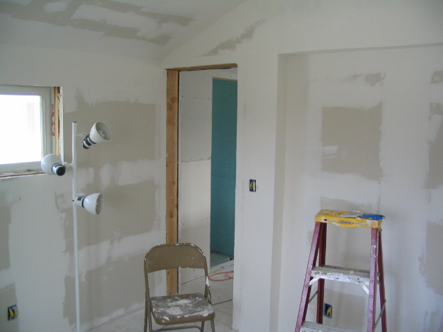

Hello,
After finding out that I officially suck at taping on a 12x12 room, I've decded to get smart and see about finding someone who won't get half the mud on the ground to do the bulk of my house. . . and who's faster. You know. . . machines and all. Or, if you're good at it and have time to show a moron how to do it right, lemme know.
Otherwise, any leads to a good drywall contractor would be appreciated.
-'Chung
ok, I don't suck as bad as I think, but I'm SLOW.

Thanks for the tips guys. . . I'll add some water to the bucket of premixed compound. I've been going thin and slow. 3 layers. the 3rd layer was basically wipe on and scrape it all off. The factory edges are perfectly flat. Mike, I'm crazy and going for smoothe finish (IMG:style_emoticons/default/monkeydance.gif) won't need to texture. . . unless my taping is utterly embarrassing.
This room is ready to sand and paint. . . I'm dreading my vaulted ceiling in the big room it's those off-angle inside corners that are driving me nuts. I'm thinking about buying a special trim to make life easier and straighter than paper tape on them.
