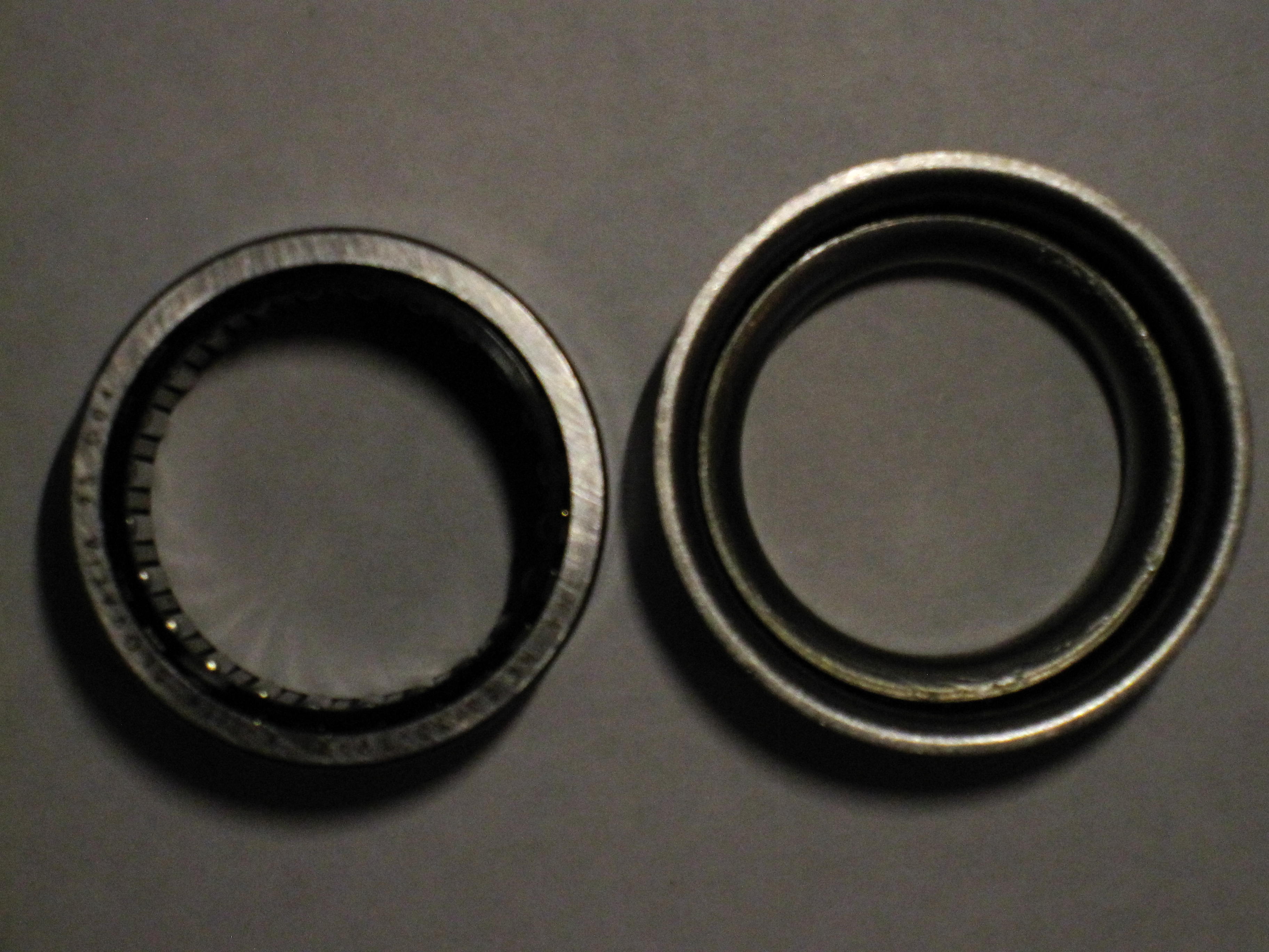

Well, it pays to be observant. My original bearing is still in one piece and firmly attached in the steering housing. I'll need a small bearing puller to get it out to experiment with Mark's prototype. Here's a couple of pictures of the original bearing, the prototype and an OE bearing I happen to have on hand.

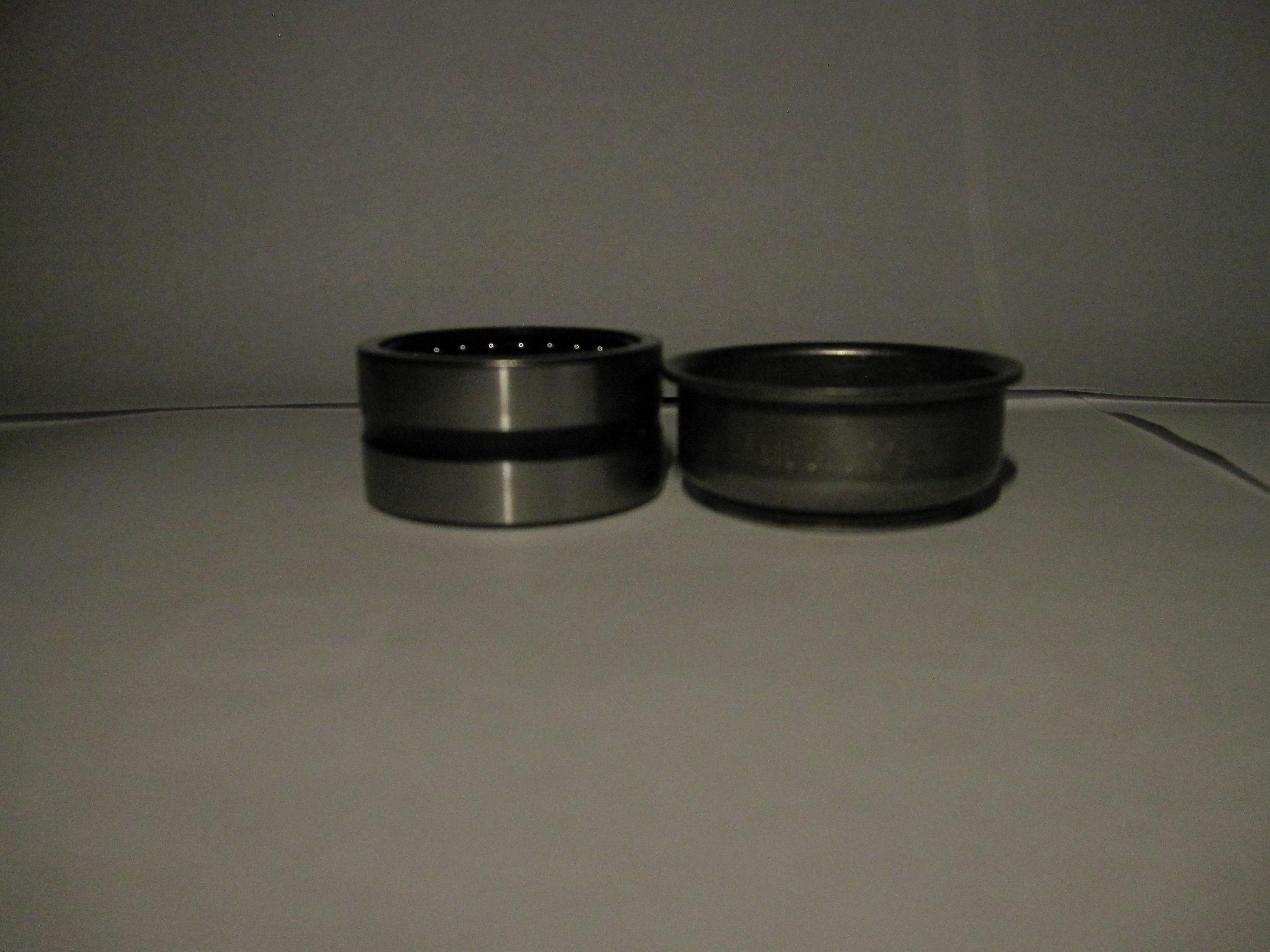

Mark's bearing is on the left and the OE bearing is on the right. The OE bearing has a 1mm lip circling the outer bearing face. The side view shows a slight difference is height (about 2mm) between the two bearings.Attached Image

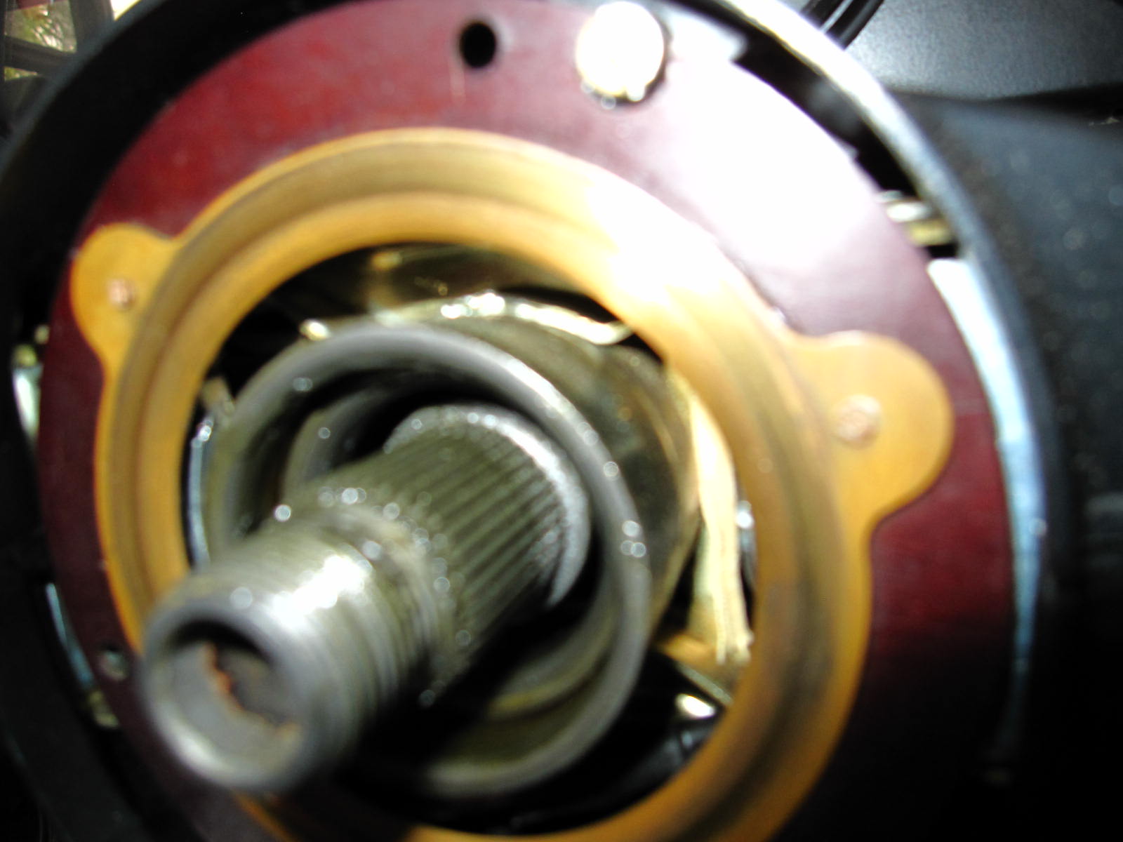

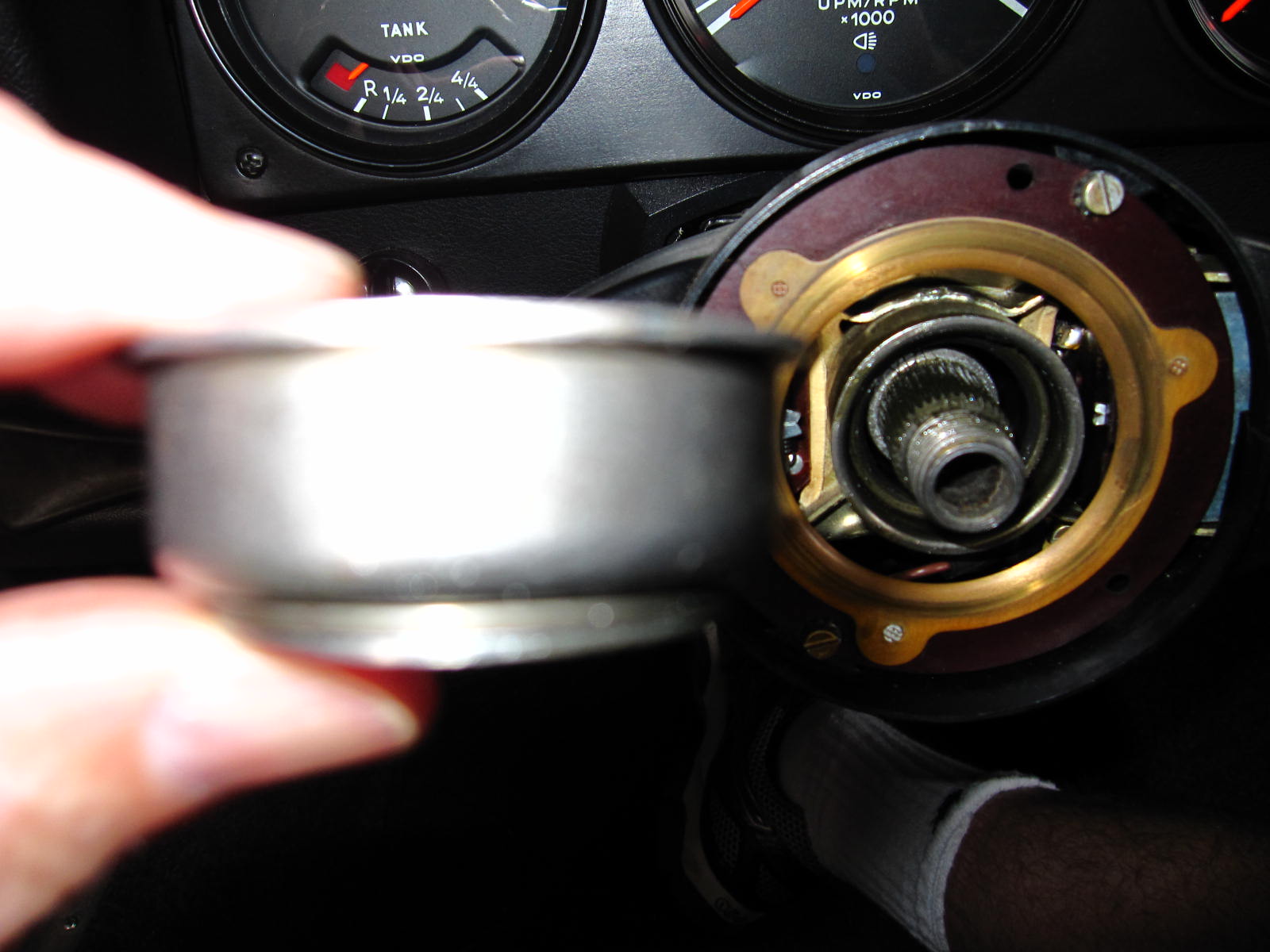

Attached ImageAttached ImageSorry for the blur, my camera doesn't like short focal lengths. These show the existing bearing in the column with not much room to extract it and the side view showing the taper and the lip of the OE bearing.

Mark, I'm open to suggestions about how to proceed with the bearing extraction. I thought this would be a slam dunk!

Isn't there a tiny lip around the OD? You might be able to get away with Channel-Loc pliers. I didn't think it was that tight...

I am the other prototyper,and I am in the same spot.My bearing is still in the upper column,I tried a screwdriver,with no success.I am going to go out and play with it after I take my kid to school

I was thinking that as well, but the space is pretty tight. I'll give it a shot in the next day or two.

I was able to get the original out by taking a thin screwdriver,tap it straight in,working around the entire outside diameter,another wider screwdriver,until I had a space the channel locs could get a good grip on,wiggle in a couple different directions and it came out.
Working on putting the bearing in now.
