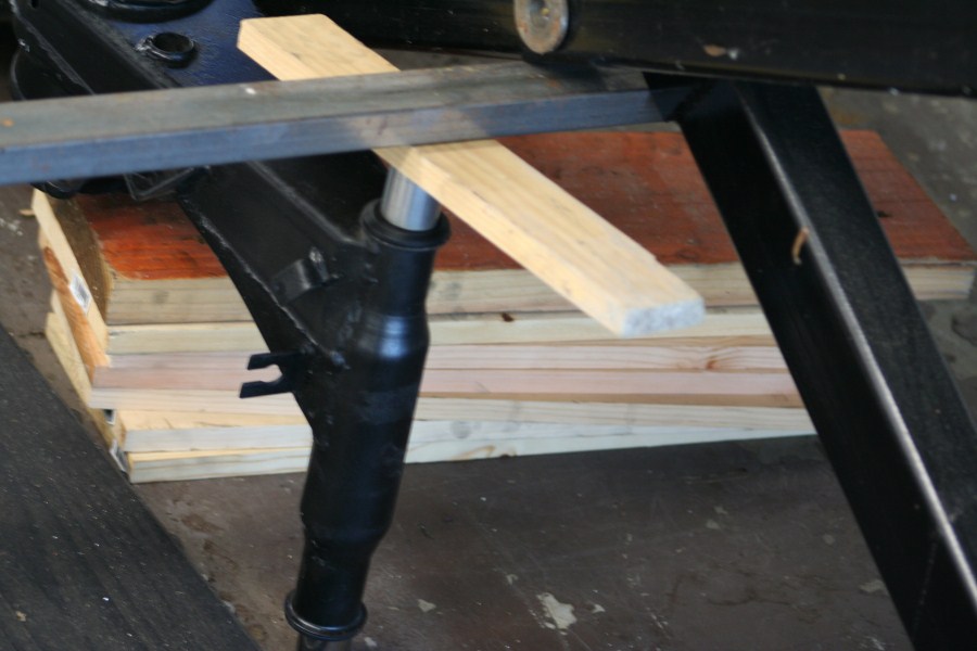

When you're ready to install new bushings you can't get much simpler than this. And it worked great. (IMG:style_emoticons/default/biggrin.gif)
