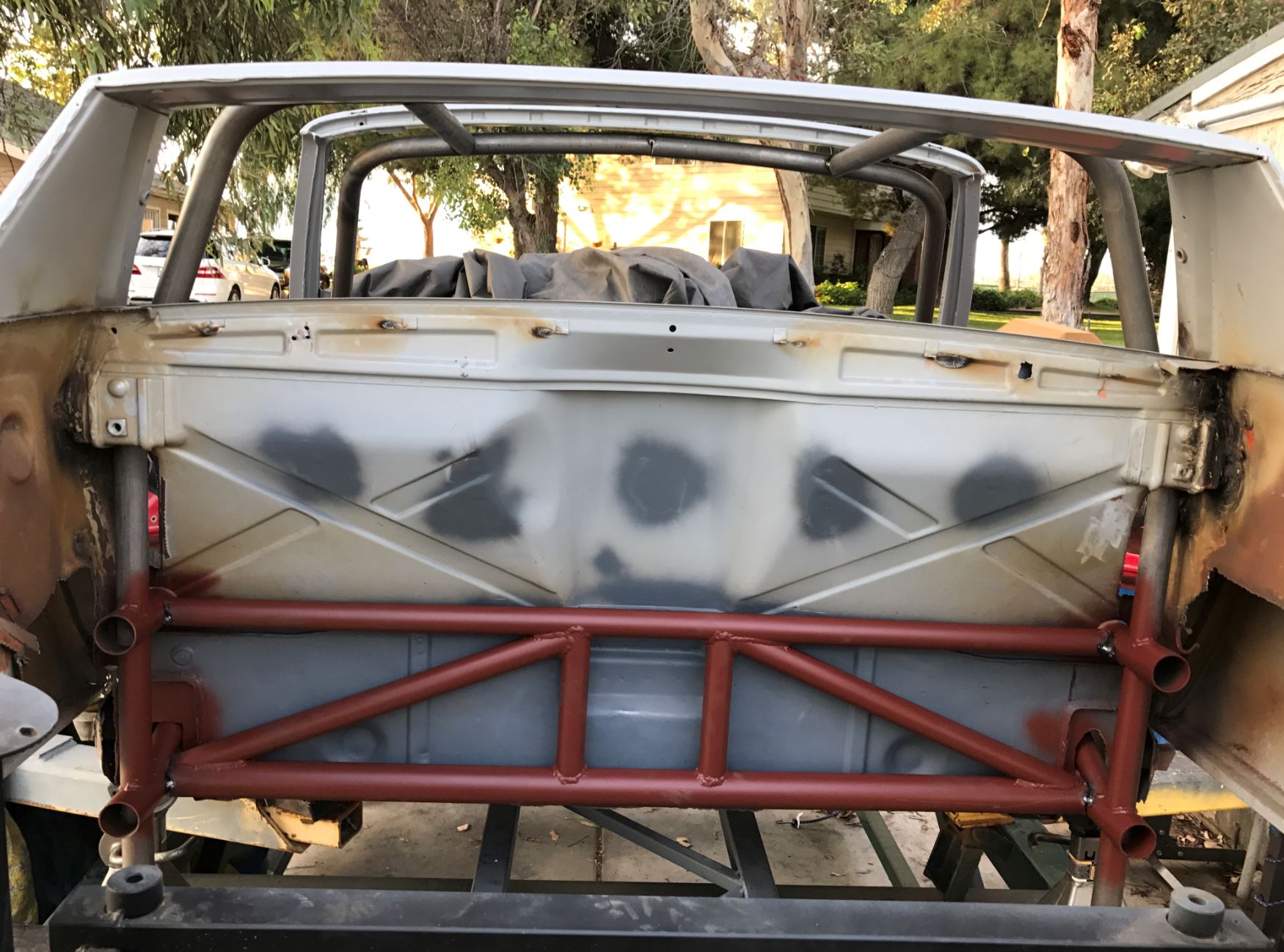

I forgot to add that I tied both of the truss longs with a rear firewall truss. This will stiffen things up a bit.....torsionally speaking (IMG:style_emoticons/default/biggrin.gif) (IMG:style_emoticons/default/biggrin.gif)

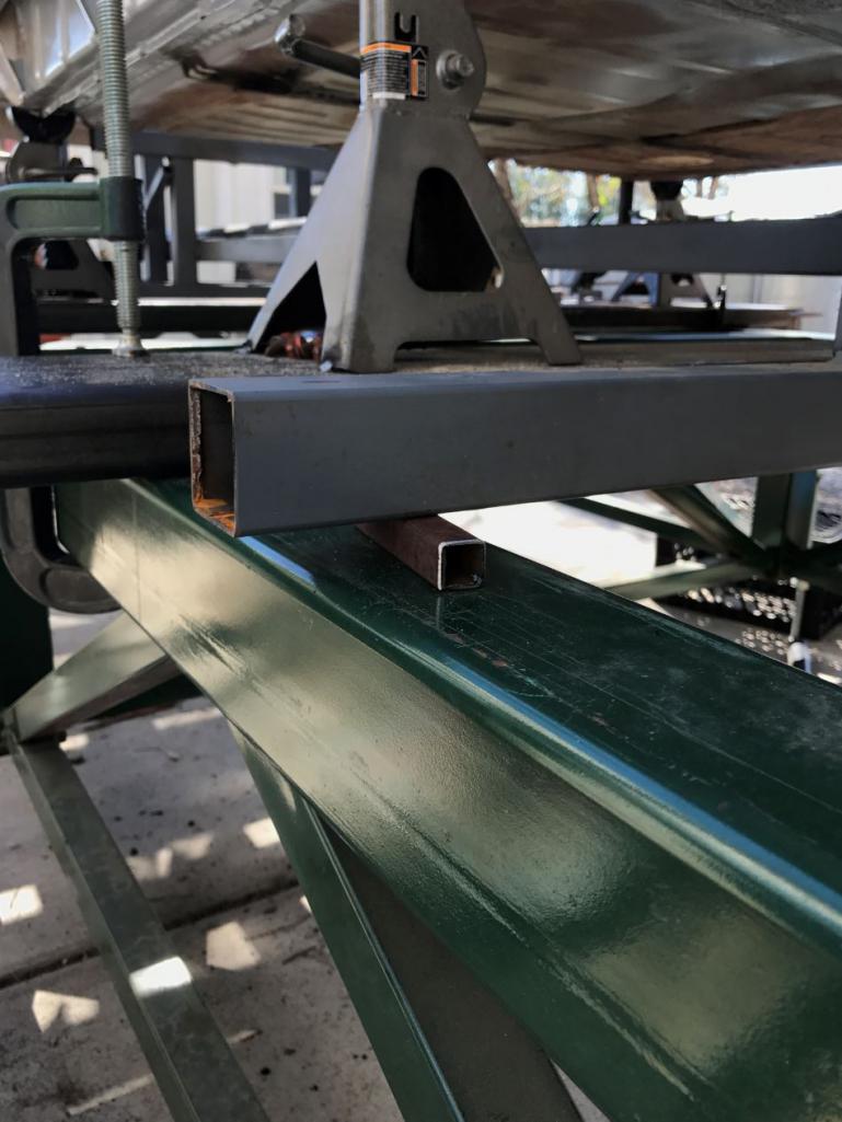

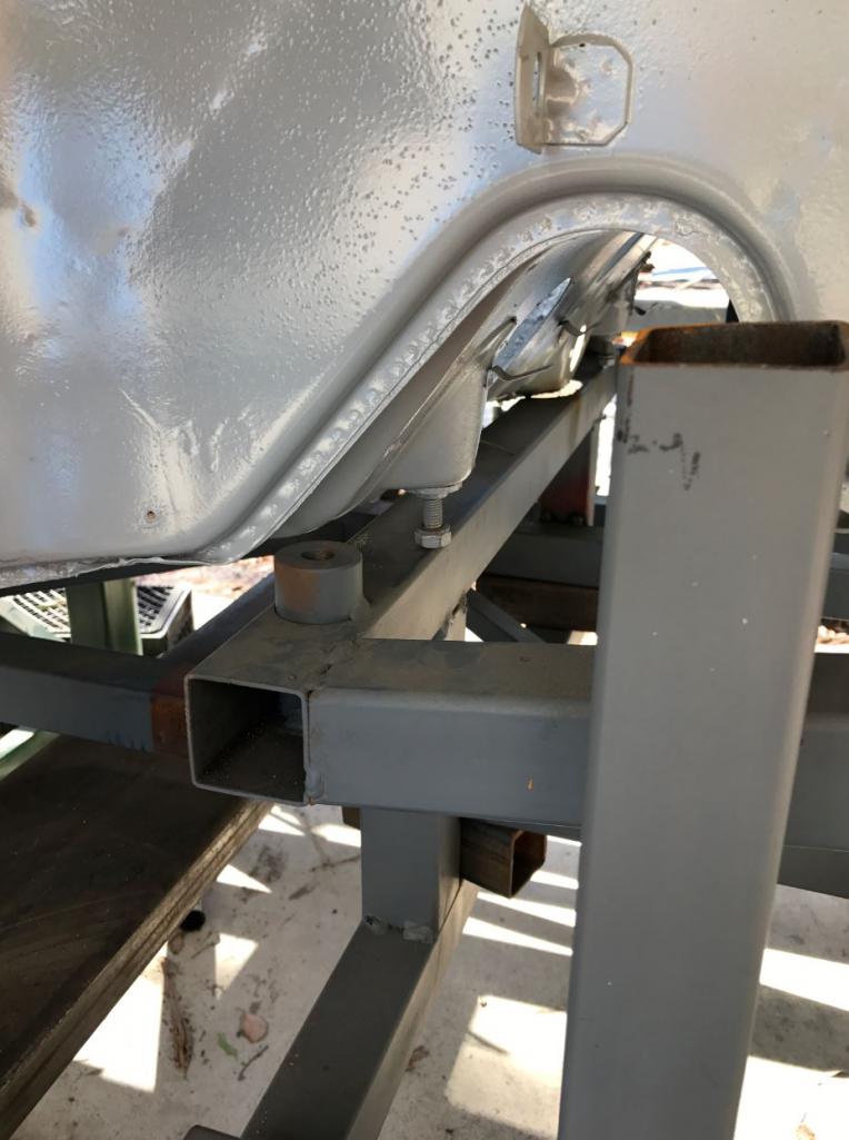

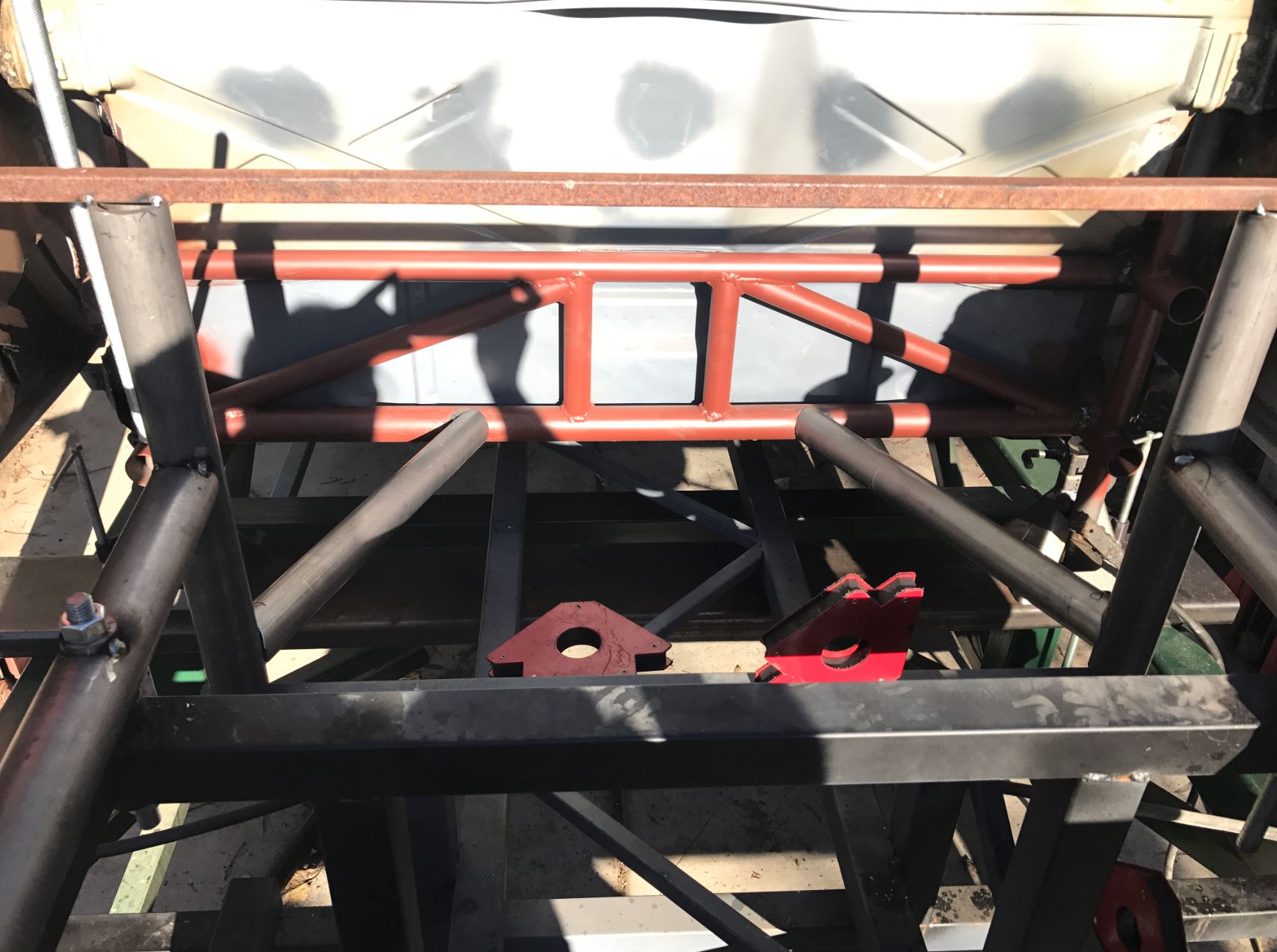

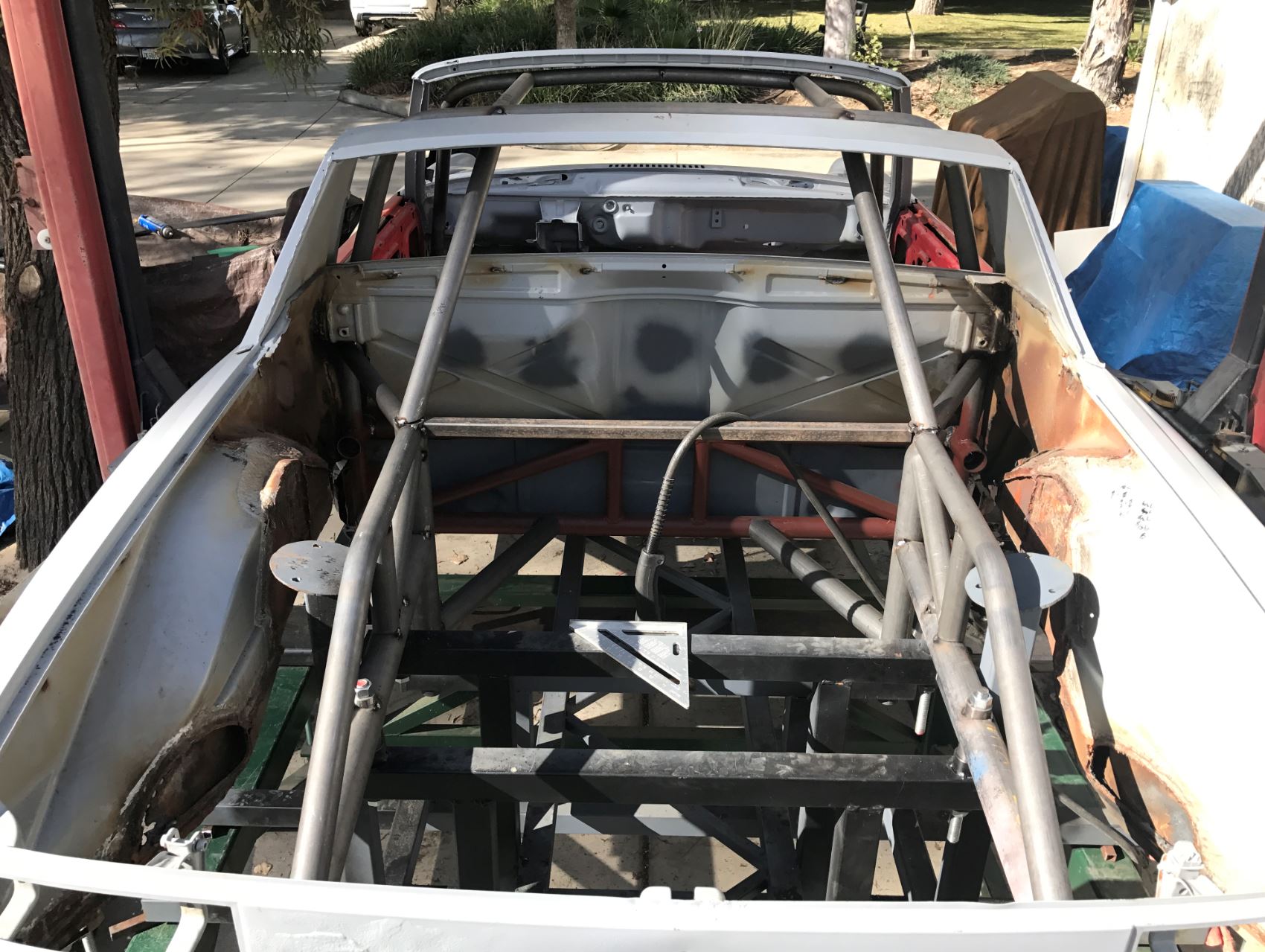

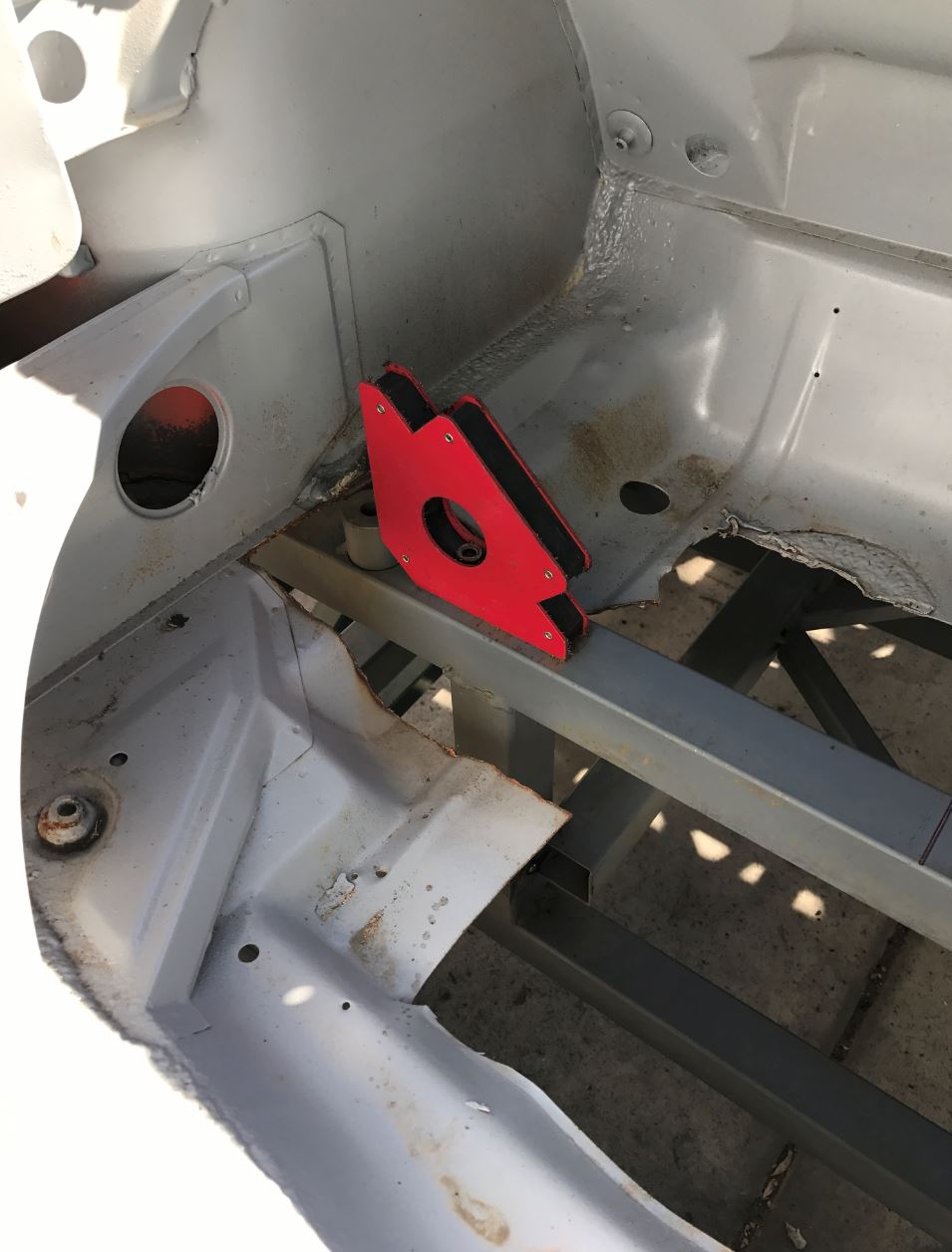

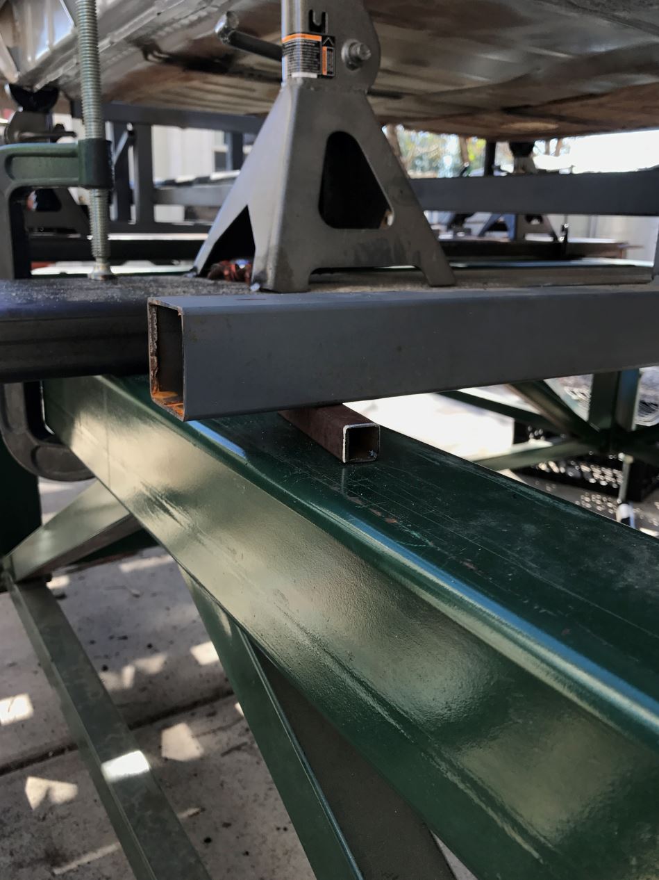

Anyway, I was able to get the suspension jig lined up under the 914. I stretched the wheelbase 3". I also raised the suspension jig 3/4" into the 914 thereby lowering the ride height by 3/4" as compared to a stock 996. The cool thing about this is that by lowering it this way, it will retain the stock 996 ride but in a lowered stance and the ride quality will be completely unaffected. Attached are the pictures of the suspension jig in place.

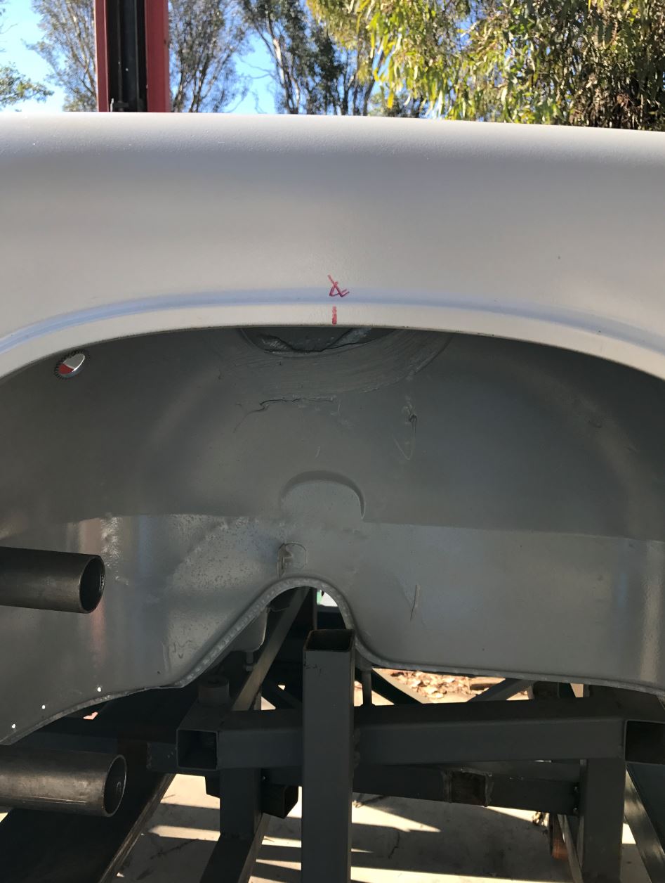

Posts: 566
Joined: 8-March 13
From: Murrieta CA
Member No.: 15,637

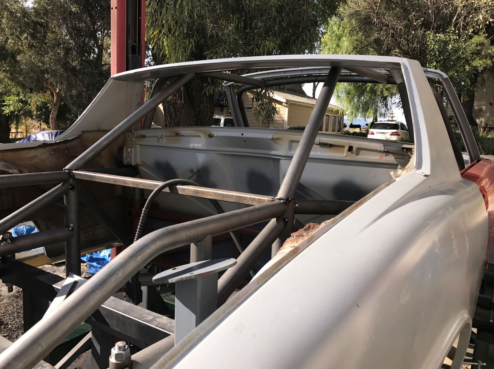

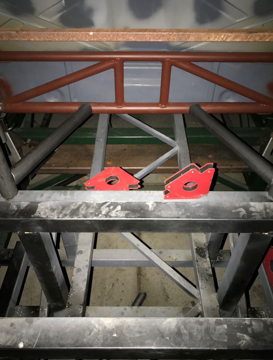

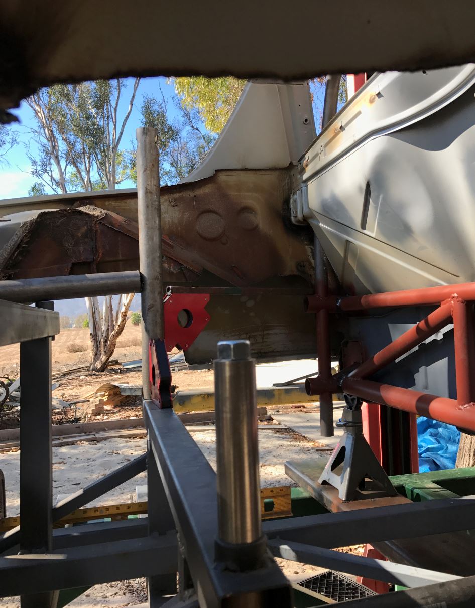

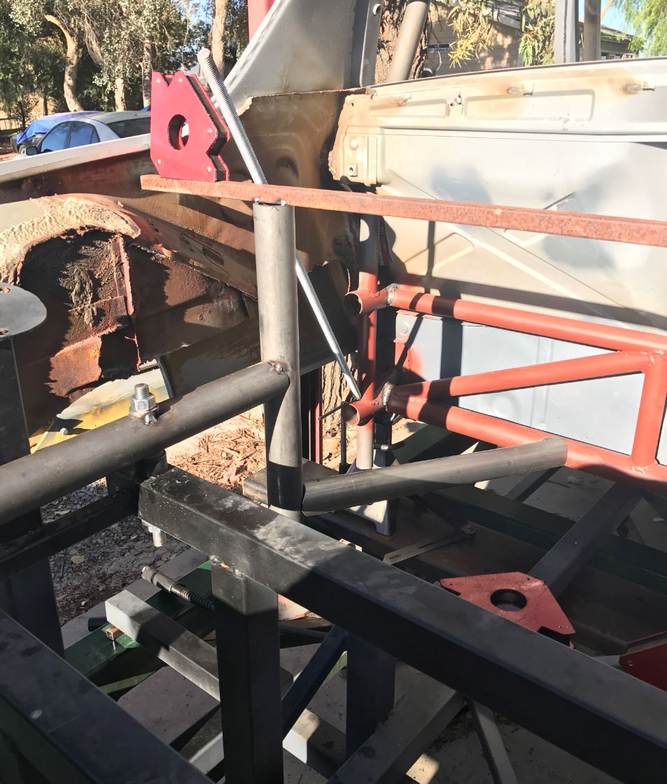

Here are some shots of the rear suspension pick up points. I hope to have the rear completed this weekend and then move to the front.

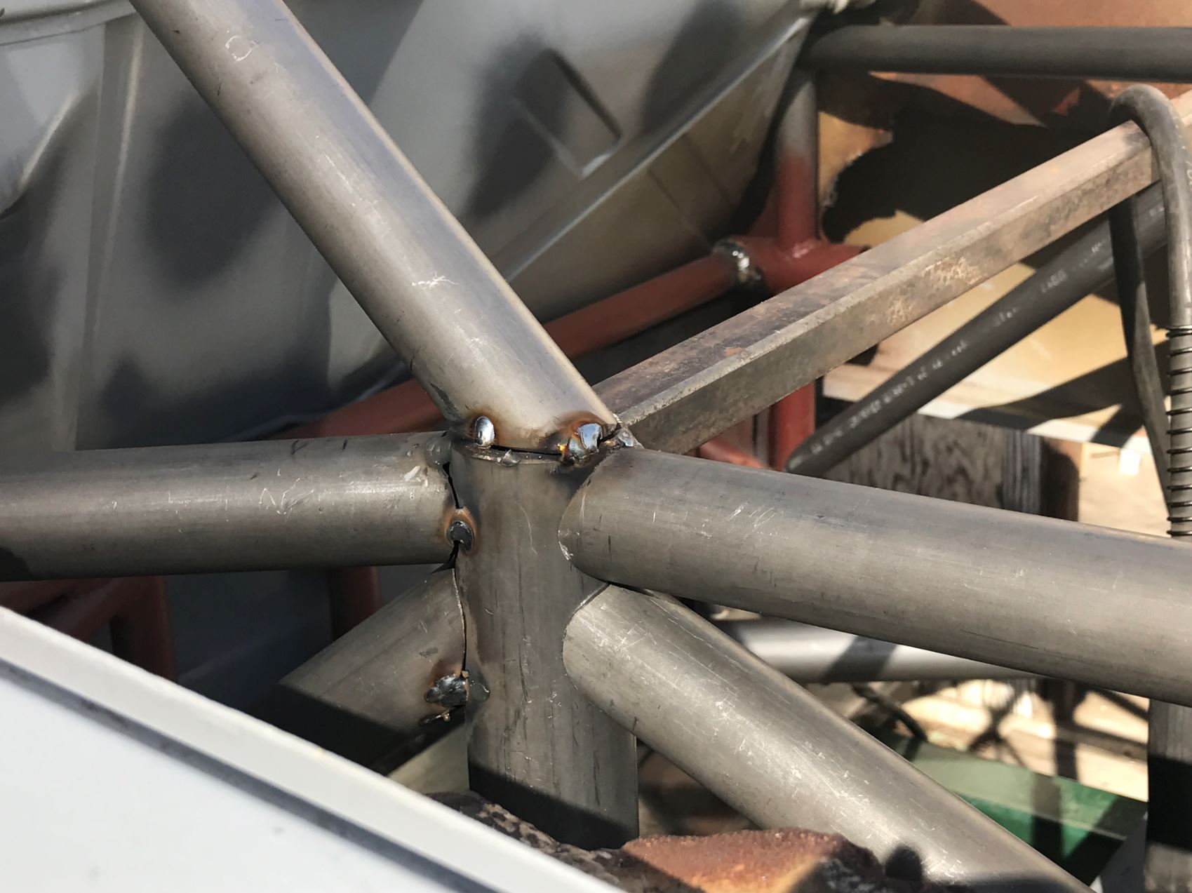

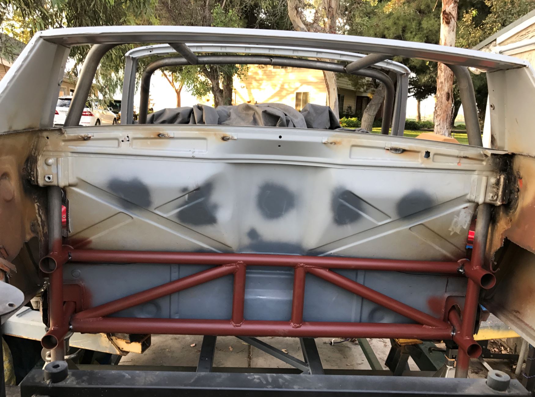

post Nov 13 2016, 12:08 PM
Post #218

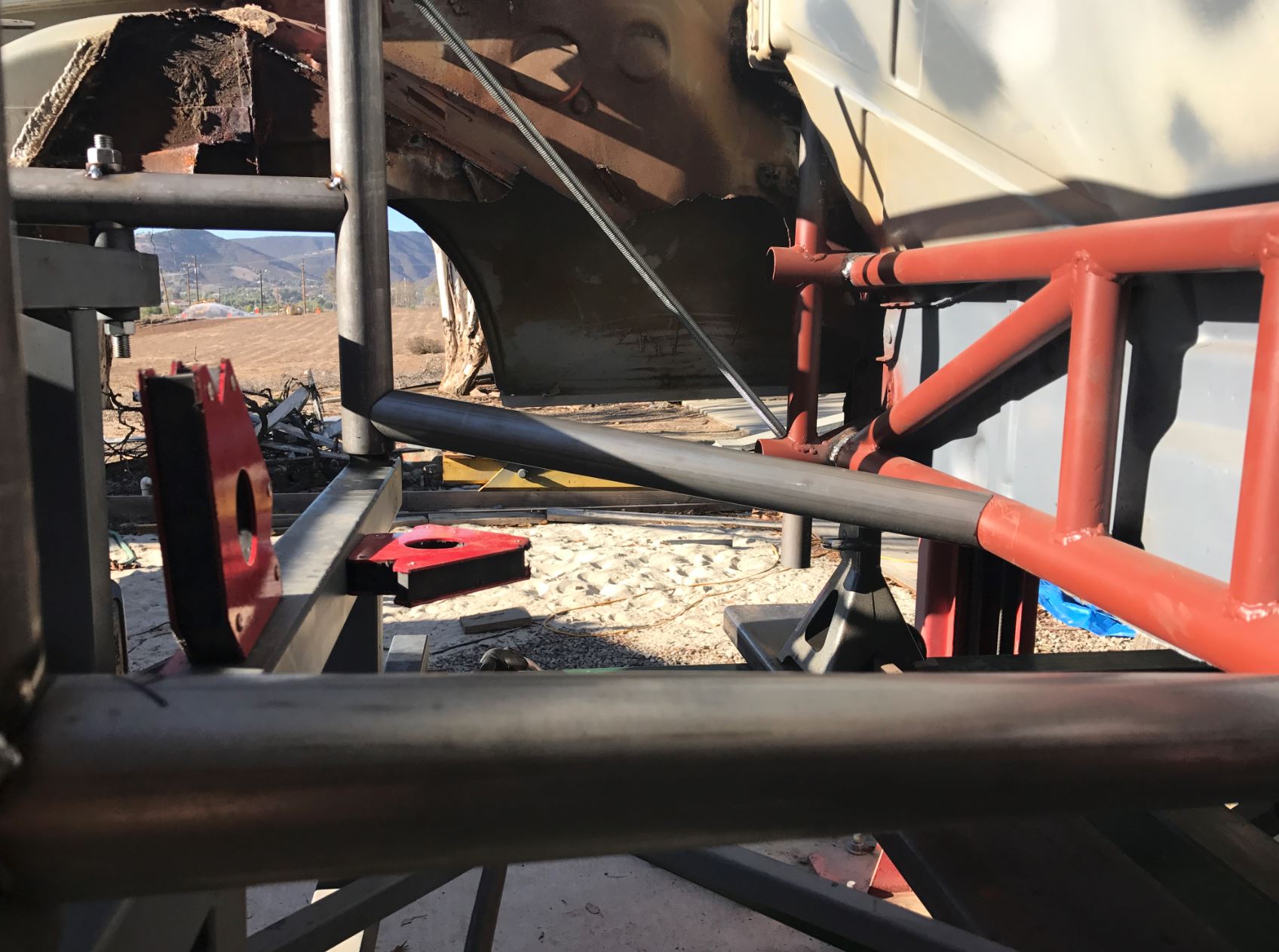

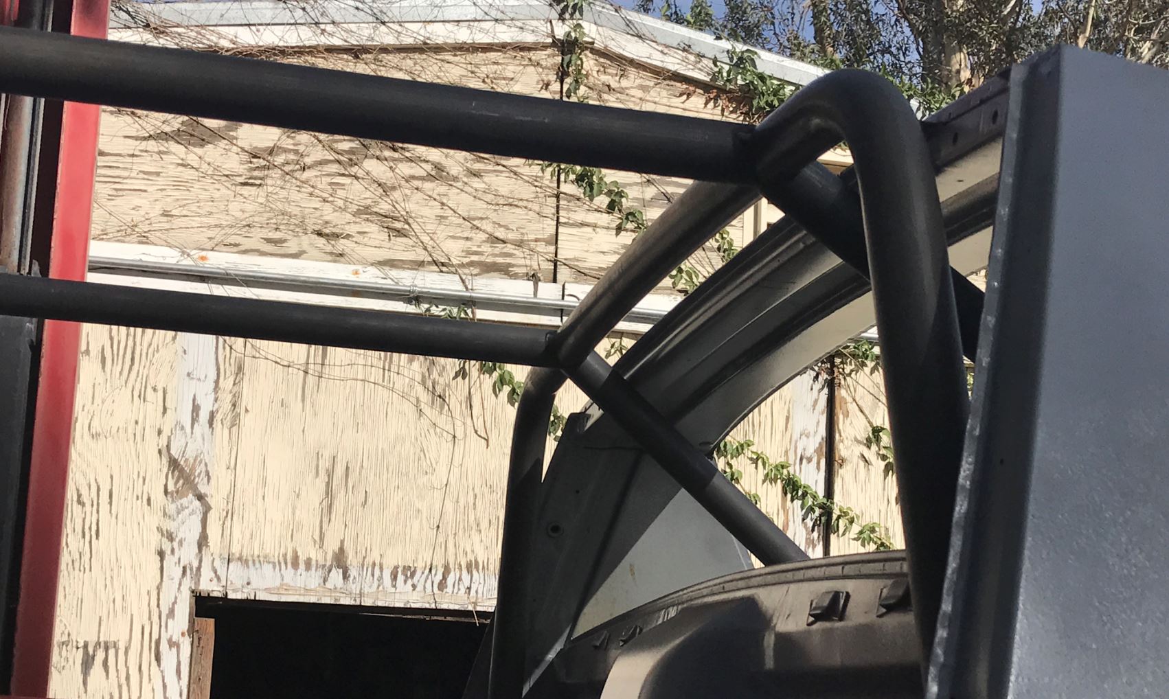

Posts: 566
Joined: 8-March 13
From: Murrieta CA
Member No.: 15,637

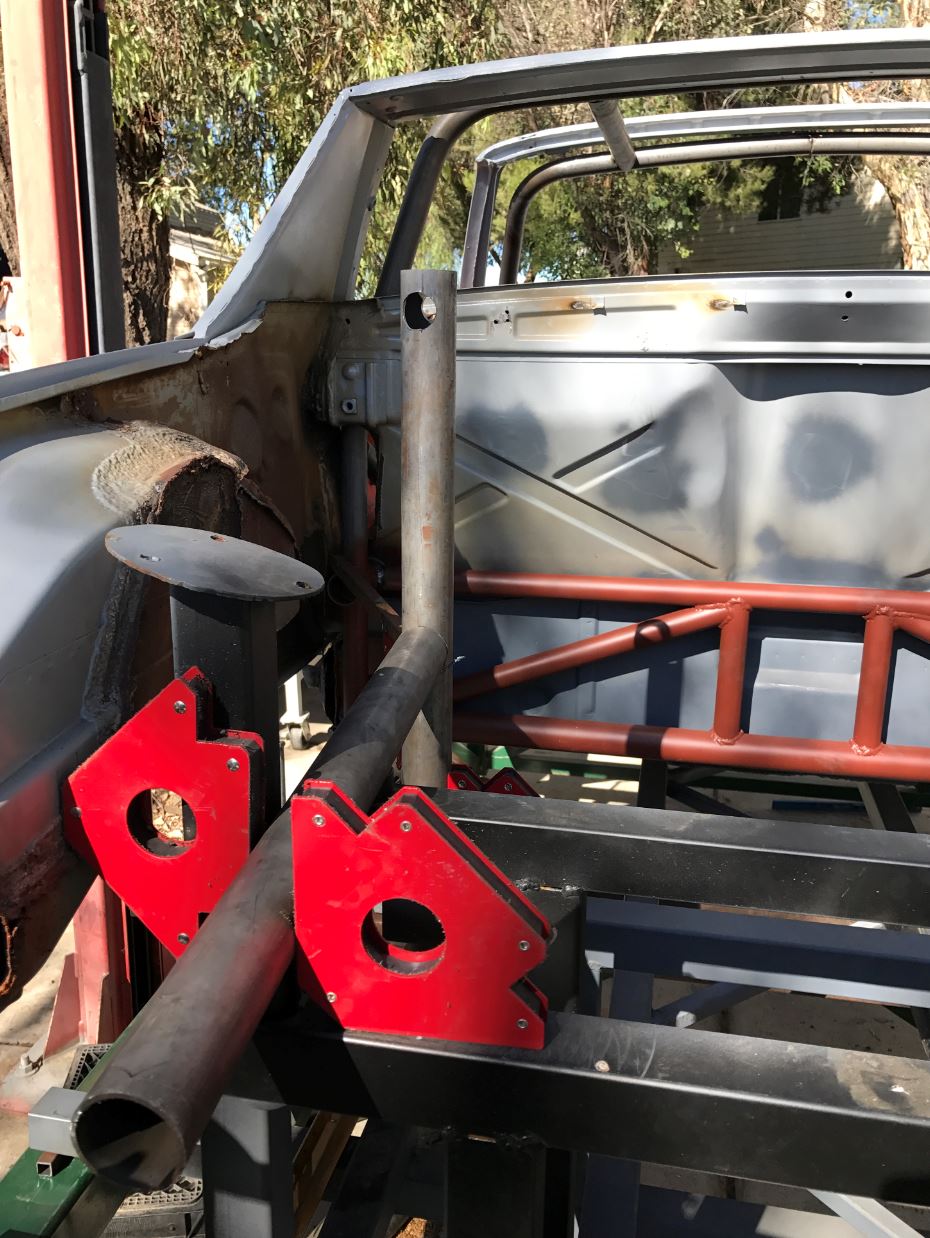

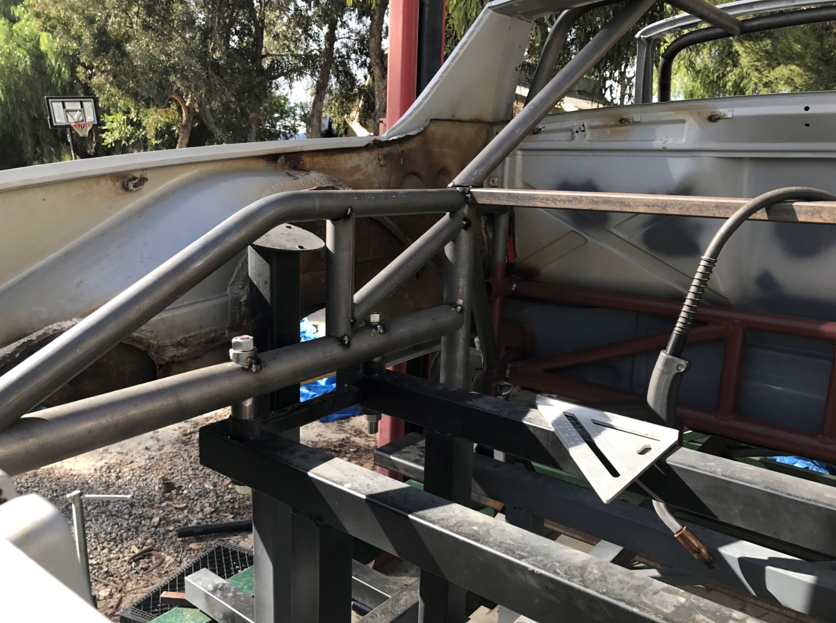

Almost done tying the rear into the car!!!! (IMG:style_emoticons/default/piratenanner.gif) (IMG:style_emoticons/default/piratenanner.gif) (IMG:style_emoticons/default/piratenanner.gif) (IMG:style_emoticons/default/piratenanner.gif) (IMG:style_emoticons/default/piratenanner.gif) Had to finish early off to my 7th wedding this summer/fall.
