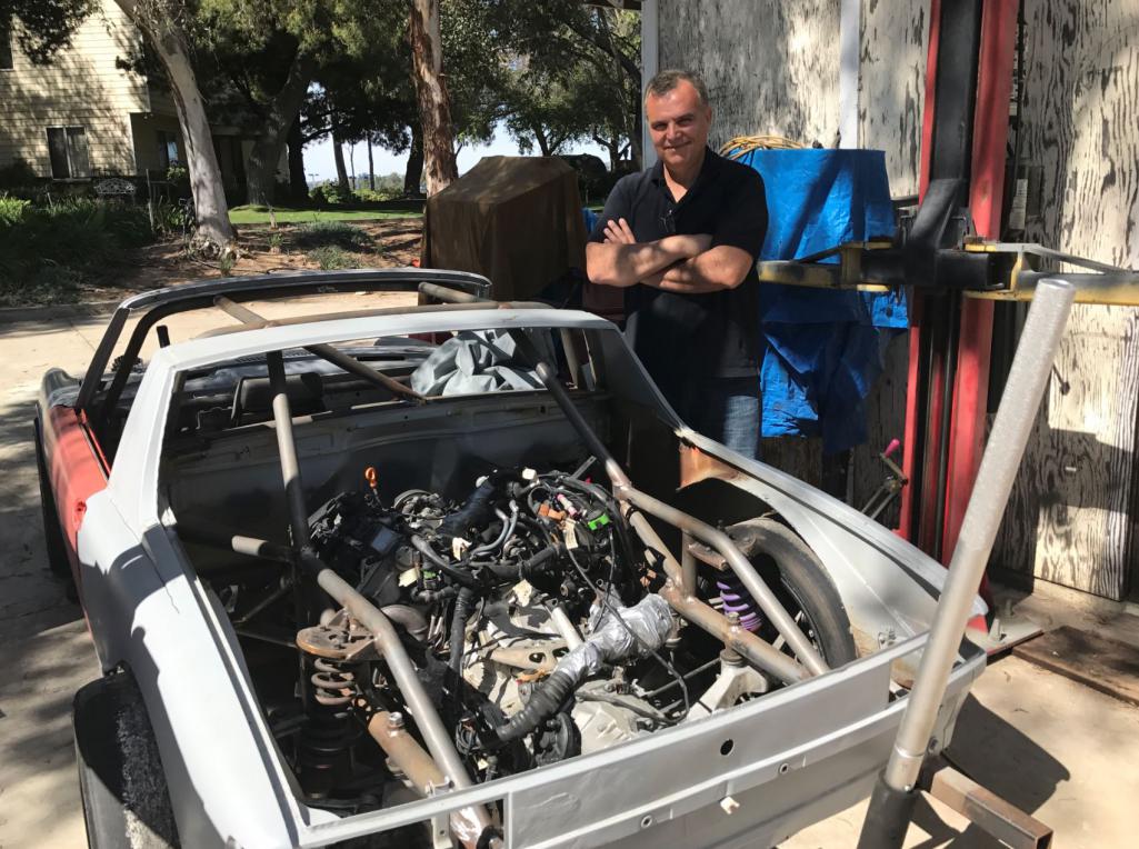

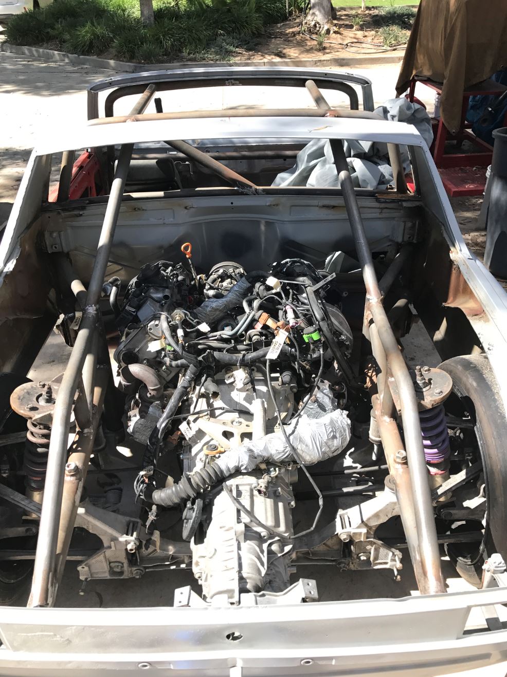

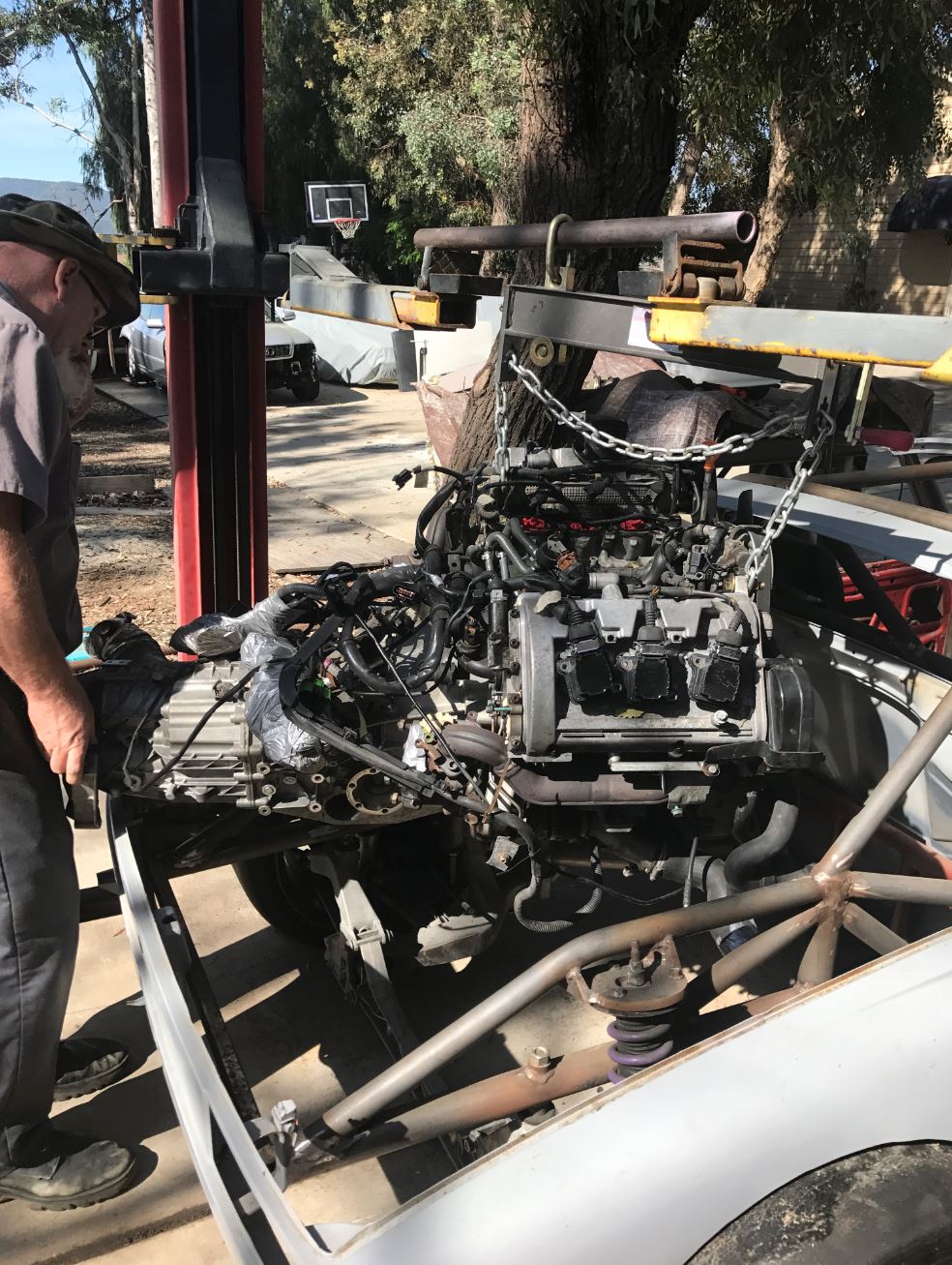

Well I we were able to place the motor to check for clearance and glad to say that it was a success. I'll have to adjust one tube to clear an oil filter but everything else fit great. Next step is to order some Z06 motor mounts and tie the motor in place.

I know I'm not the first to say this, but:
THAT... is a lot of wires! (IMG:style_emoticons/default/w00t.gif)
Here's to success as you get to hookin' up all that! (IMG:style_emoticons/default/beerchug.gif)
And Triple Super Bonus Points for being the only 914 (I've ever seen) where the motor/trans goes in from the top!

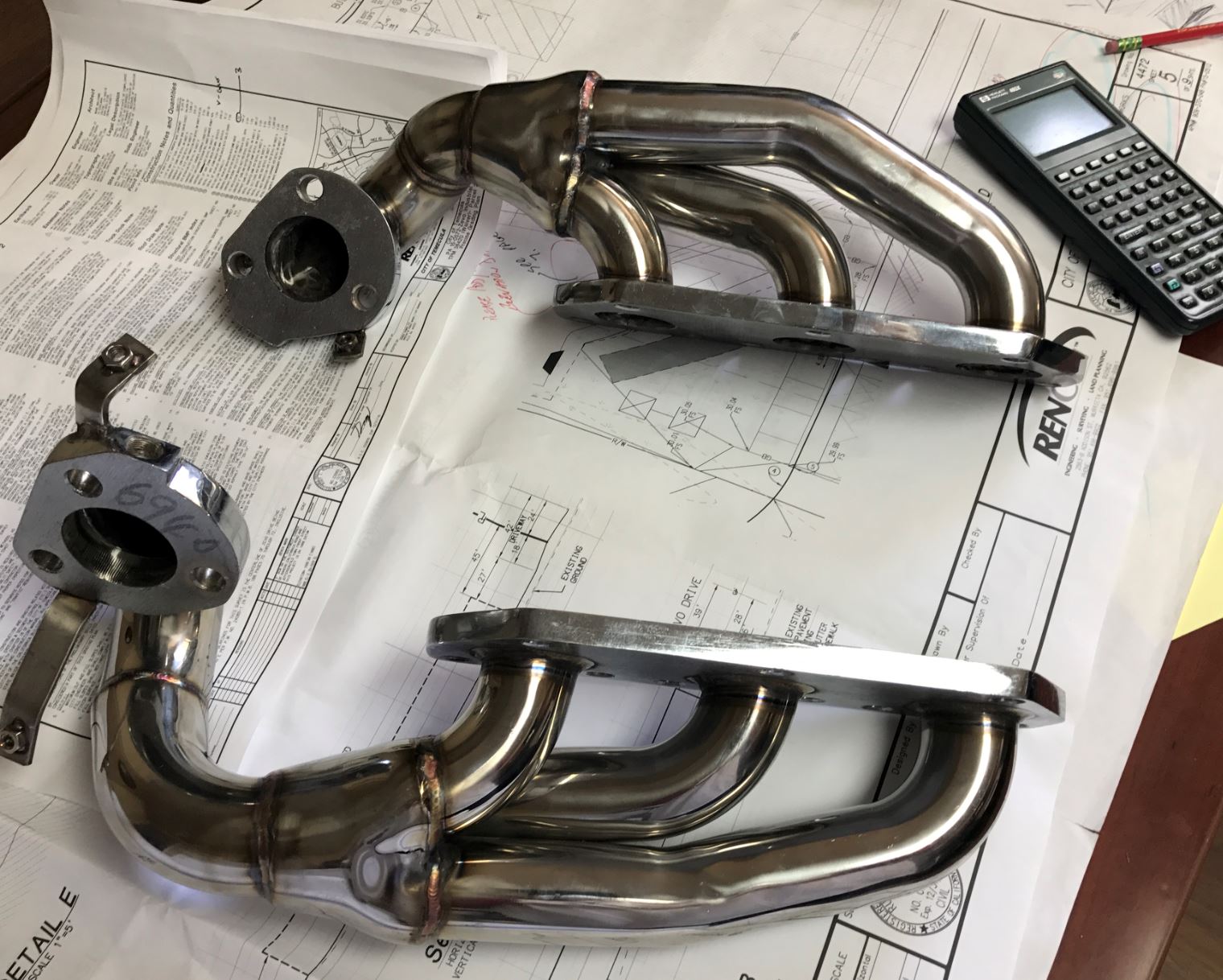

Well look what came in the mail today!

Those look like Chinese headers. (IMG:style_emoticons/default/sad.gif) Please tell me there not
You have a number of solid options, most go OEM but here is a list in no order..
1. OEM
2. Ported OEM
3. AWE $3k headers.
4. $1750 Wagner headers
5. $900 Custom built like Silly Rabbit Motorsports, Built from thick stock material.
Those OBX/XS/$150special headers crack. They simply cant stand the heat that the turbos produce, especially with the boost turned up.
AWE
https://www.3zero3motorsports.com/store/a-w...haust-manifolds
Wagner
http://www.andysautosport.com/products/wag..._150001009.html
My money would go with silly rabbit motorsports I've got a link to their flow charts as well below.
http://sillyrabbitmotorsport.com/b5-s4-exh...haust-manifolds
http://www.myaudis4.com/srm-exhaust-manifold-flow-test/
Unrelated Note on my setup I am running an APR Iconel manifold for a 1.8T, if there is one thing in my engine build that will never break, its that manifold.
