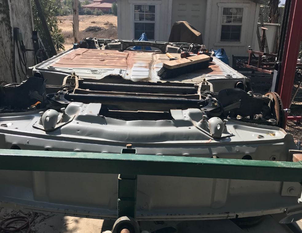

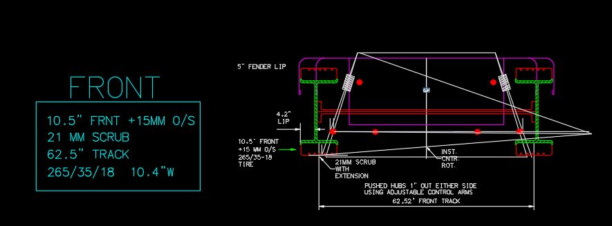

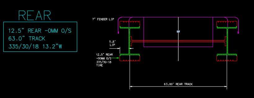

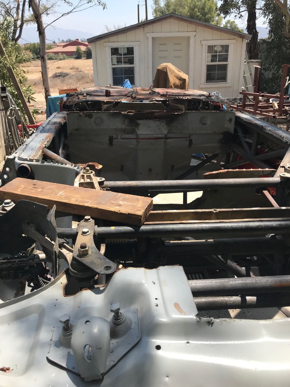

OK back on FINALLY! I started work on the floor. I removed it and now am waiting to get the replacements. I will be working on closing up the holes that I needed to put the struts through. Also, it's easier with the floor off. Should be getting a new set of shoes. 10.5 x 18 F, 15mm offset with 265/35/18 and 12.5x 18 rear, 0 mm offset with 335/35/18 Toyo R888R's. Track is 62.5" Front, Rear is 63.0".

Awesome! Whats the plan with the floor pan? Going to lower it some for headroom?

Thanks for the awesome welcome back. @andyrew @sb914 @76-914 @ValcoOscar @tygaboy Andy I'm just going to put the stock floor back in since the car is already low (4" clr) I don't want to expose my hindquarters and moneybags any more than it alreasy is. Kent, It would be better if you came by on the weekend after labor day. I should have the floor by then and will be installing it. Hopefully the new wheels will be in at that time as well. The break has been good, I've though over some things, changed my mind over and over but now I feel way better about some of the design changes. I am going with the radiators in the quarter panels and I decided against (for the second time) the hollow spokes.
By the way did you guys notice the front and rear track dimensions. It's a half inch from being 63" Square. (IMG:style_emoticons/default/piratenanner.gif) (IMG:style_emoticons/default/piratenanner.gif) (IMG:style_emoticons/default/piratenanner.gif) (IMG:style_emoticons/default/w00t.gif) (IMG:style_emoticons/default/w00t.gif) (IMG:style_emoticons/default/aktion035.gif) (IMG:style_emoticons/default/aktion035.gif) (IMG:style_emoticons/default/aktion035.gif) (IMG:style_emoticons/default/aktion035.gif)

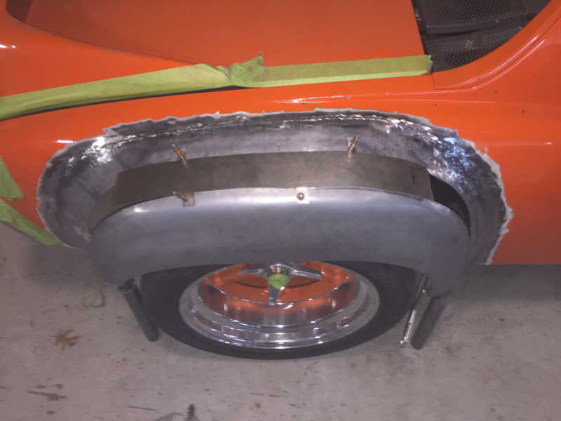

BTW does someone have the link to the guy that shows how to widen the steel gt flares? I've checked using the search but I was not successful. I remember that he cut the whole thing and added a strip to it. I will need to do the same thing and is the next thing on my agenda after the floor is welded back in.

Rudy - here's a pic that @ChrisFoley posted on my thread about a flare widening update he did. Maybe check in with him.

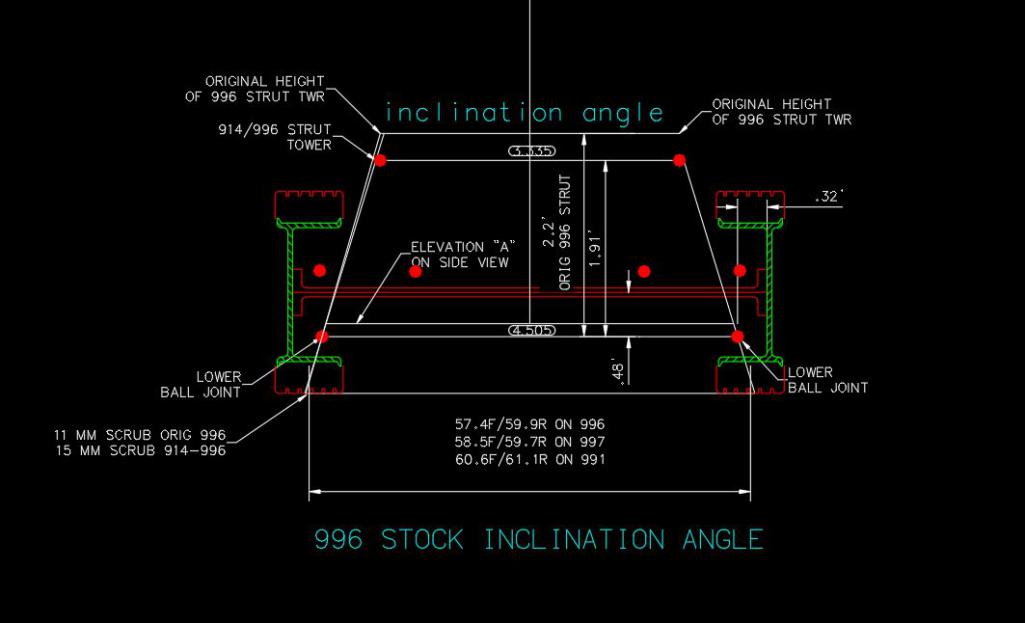

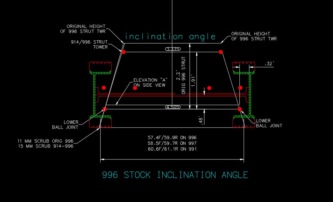

Sweet - looks good. What software are you using for the front/rear track diagrams?
-Steve
Curbandgutter
post Aug 24 2018, 04:30 PM
Post #456
Posts: 566
Joined: 8-March 13
From: Murrieta CA
Member No.: 15,637
QUOTE(siverson @ Aug 24 2018, 03:05 PM) *
-Steve
Autocad

Thanks I will look him up.

@chrisfoley would you happen to have more pictures of that flare widening? I searched your name and widen flares and did not come up with what I was looking for.

ChrisFoley
post Aug 24 2018, 07:56 PM
Post #460
I am Tangerine Racing
Posts: 8,034
Joined: 29-January 03
From: Bolton, CT
Member No.: 209
QUOTE(Curbandgutter @ Aug 24 2018, 07:12 PM) *
I have a collection of pics in my office computer showing more details. I don't recall if I ever posted more of them on the forum. Just checked my facebook company page but only a couple incidental pics of that car in the timeline photos.
