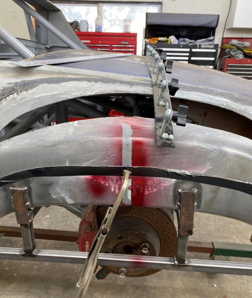

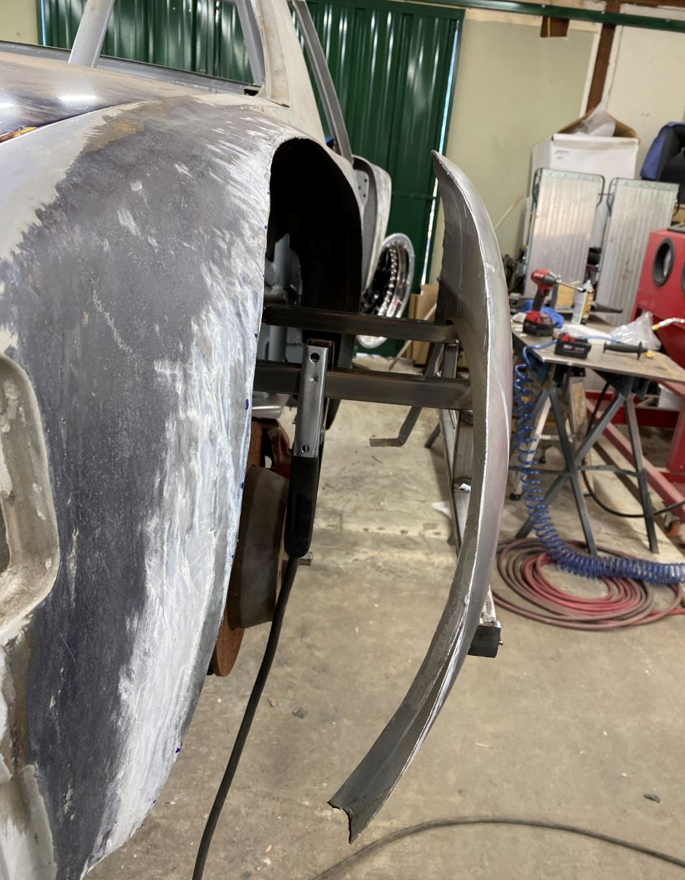

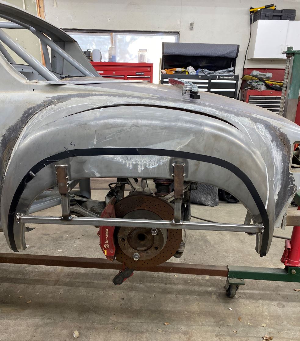

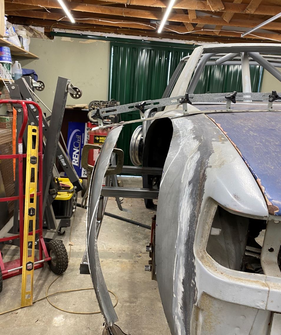

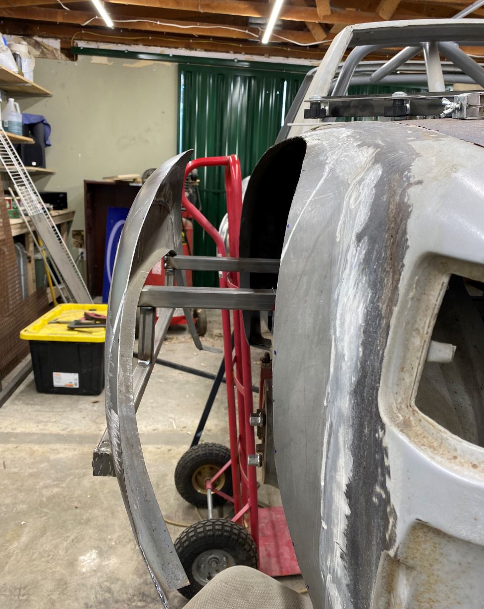

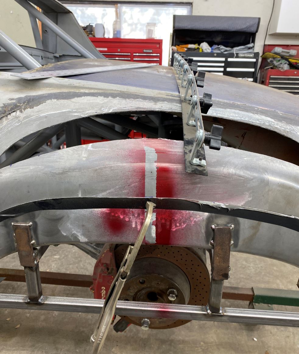

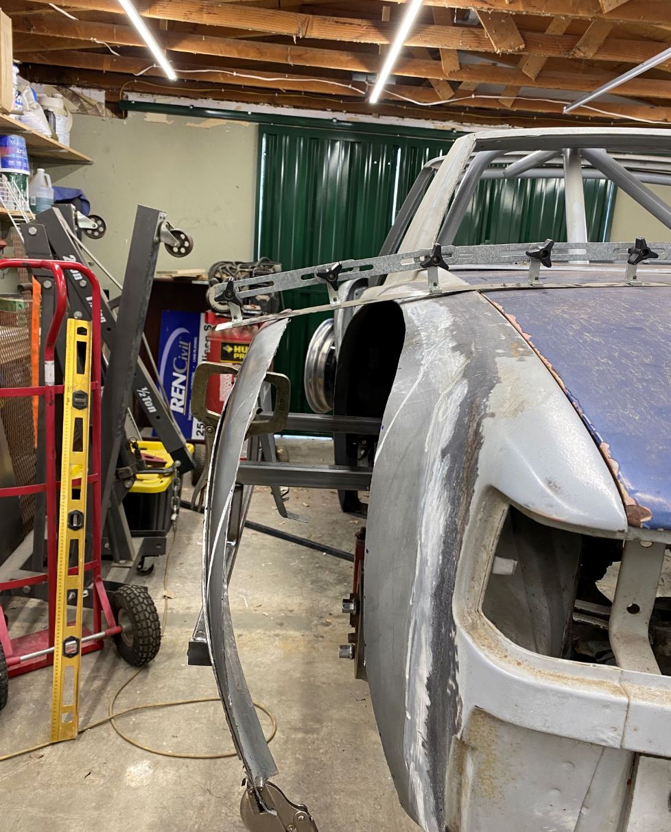

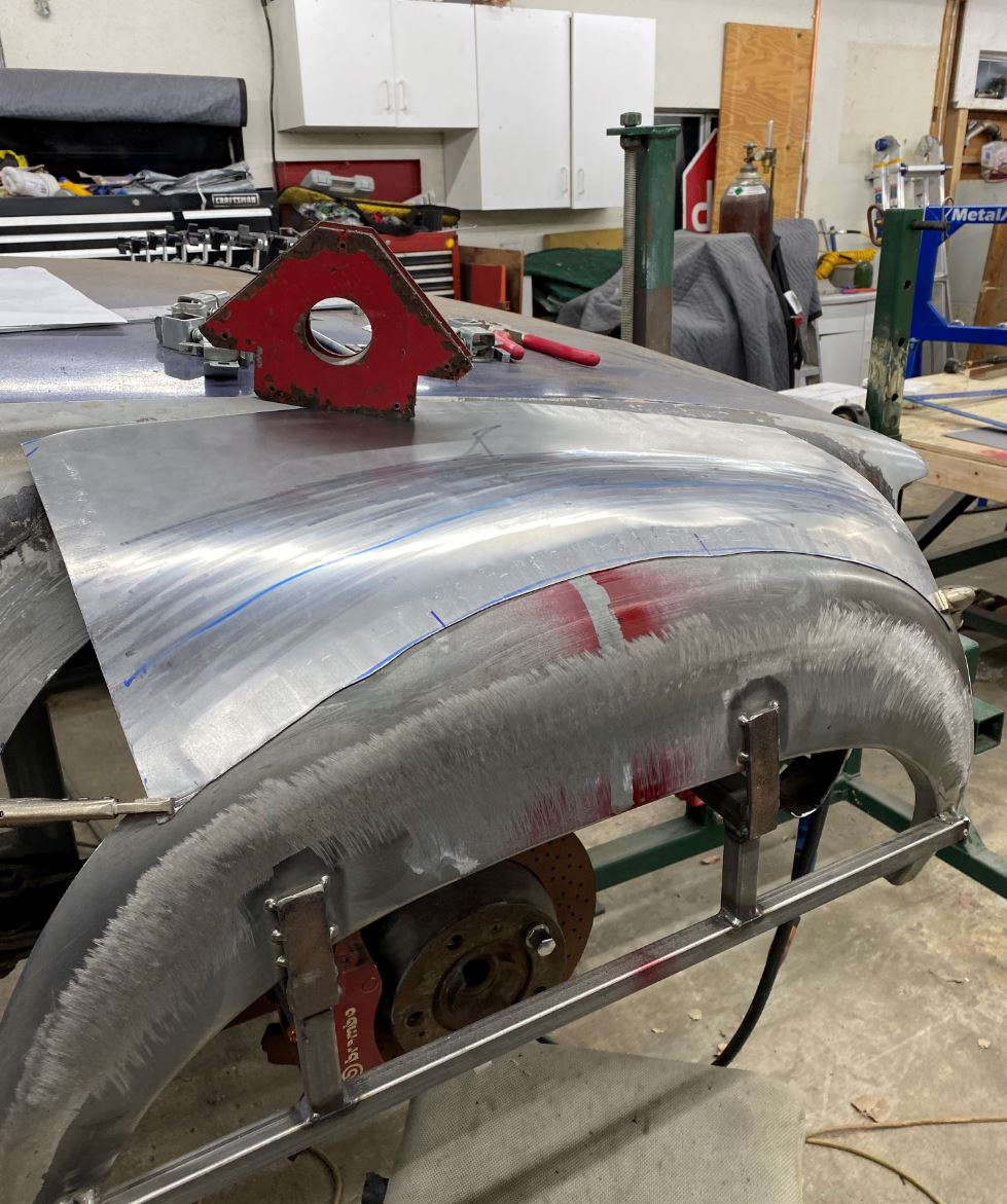

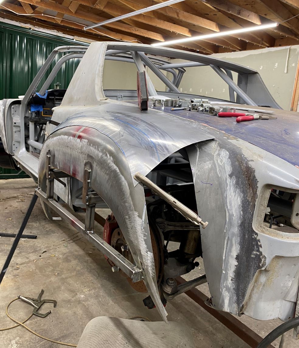

UPDATE ON REAR FLARES
Mark to cut and slide downAttached Image
cut and slide down 1 inch Attached Image
This is how high the edge is prior to lowering 1 inch Attached Image
Post loweringAttached Image Attached Image
fitting the top piece Attached Image Attached Image

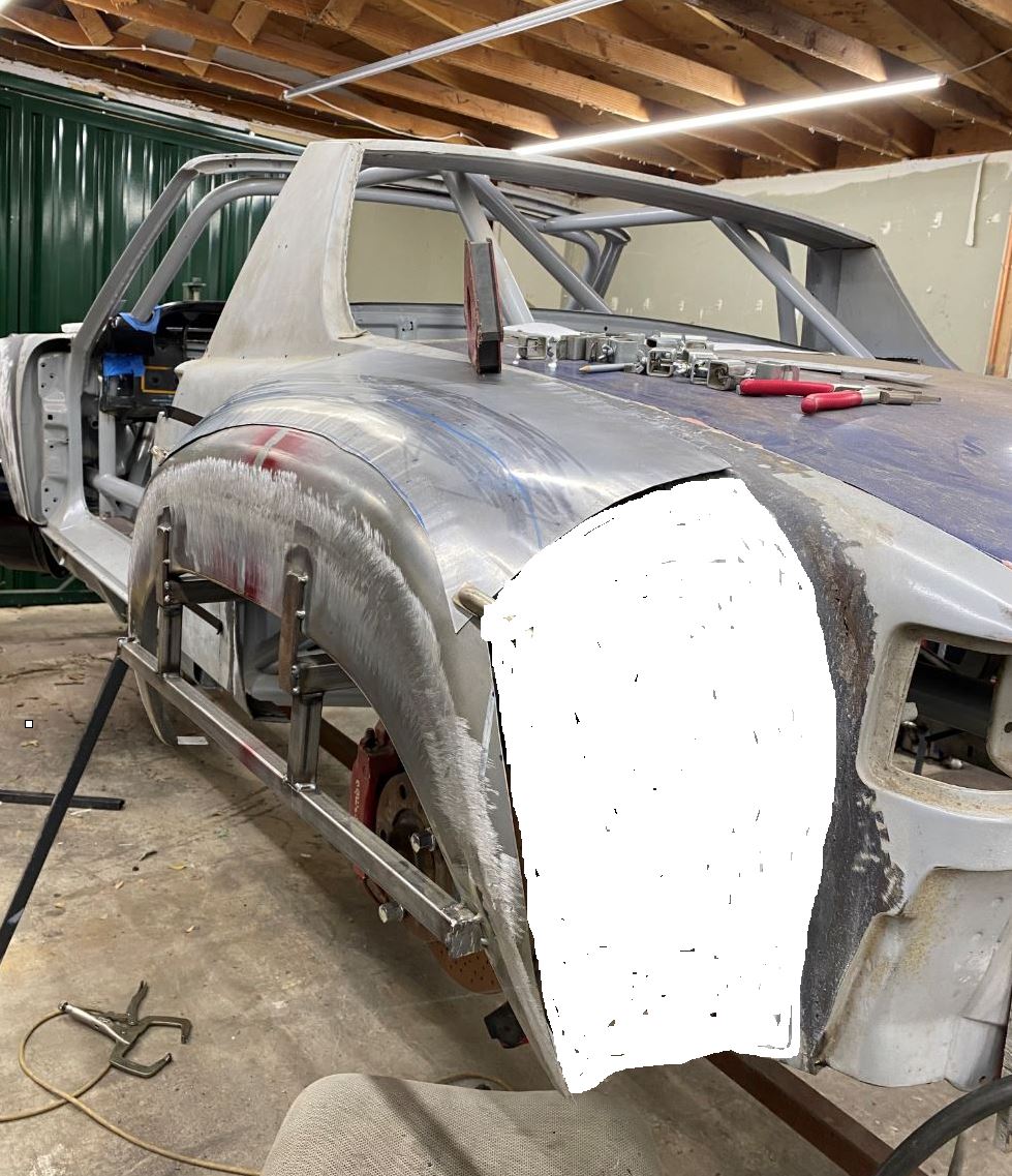

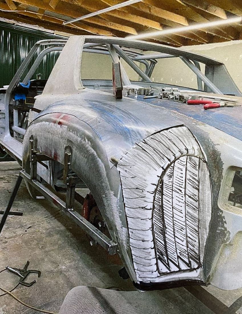

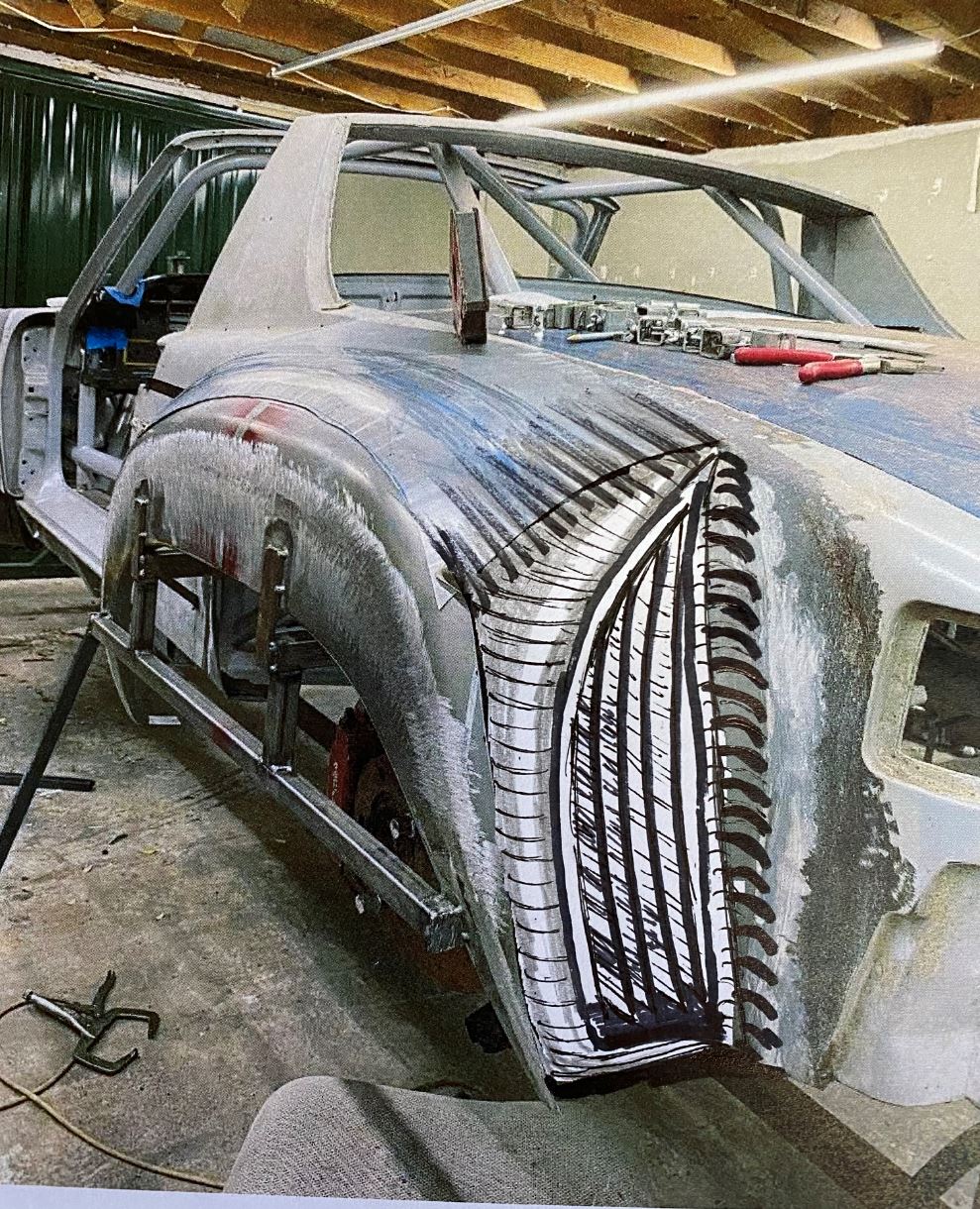

Hey this is what I'm thinking for the rear. I'm open to suggestions.
I'm thinking of something like this. It's hard to illustrate it, but it won't look like horns or cat eyes. I'm thinking of 3d printing the louvers and then dipping in that paint that makes it look like carbon fiber. Where it attaches to the rea by the light will follow the contour of the fender Attached Image
do nothing Attached Image

I say you get the fender done, put a tire under it and see how it looks.
What other things are you doing to the rear that is non standard? Having these vents will help performance wise but its going to look really odd on this car if nothing else "modern" is being done besides wheels (And obviously the whole chassis but thats not visible from the outside).
DO you prefer form or function here? (IMG:style_emoticons/default/smile.gif)
There is a lot of trapped air in the back of a 914, but if for example you use a diffuser, there likely wont be much at all. And there is so little area behind the 914 rear tire that there wont be much air flowing into it.

Andrew I'm cutting in a vent opening in the 1/4 panel.......my pseudo luggage rack (IMG:style_emoticons/default/evilgrin.gif) , this will bring air into the intercoolers and so I need an exhaust. So, yes, there will be a lot of air in the wheel well. As for the diffuser yes I'm making one that doubles as the stiffening panel along the entire engine bay bottom. I'm using it to tie everything together structurally along the bottom and then doubling as a diffuser.
Thinking of going with 1/8" aluminum plate. The diffuser fins will be maybe 20 gauge aluminum that is bolted on to the diffuser with some button head screws. That way they can easily be replaced when needed. I have 6 points of attachment made for that in the cage. I want to modernize the look of the car without going too far........maybe I already did but........I'm planning on using chrome bumpers but modernizing. I've good some ideas ruminating.
