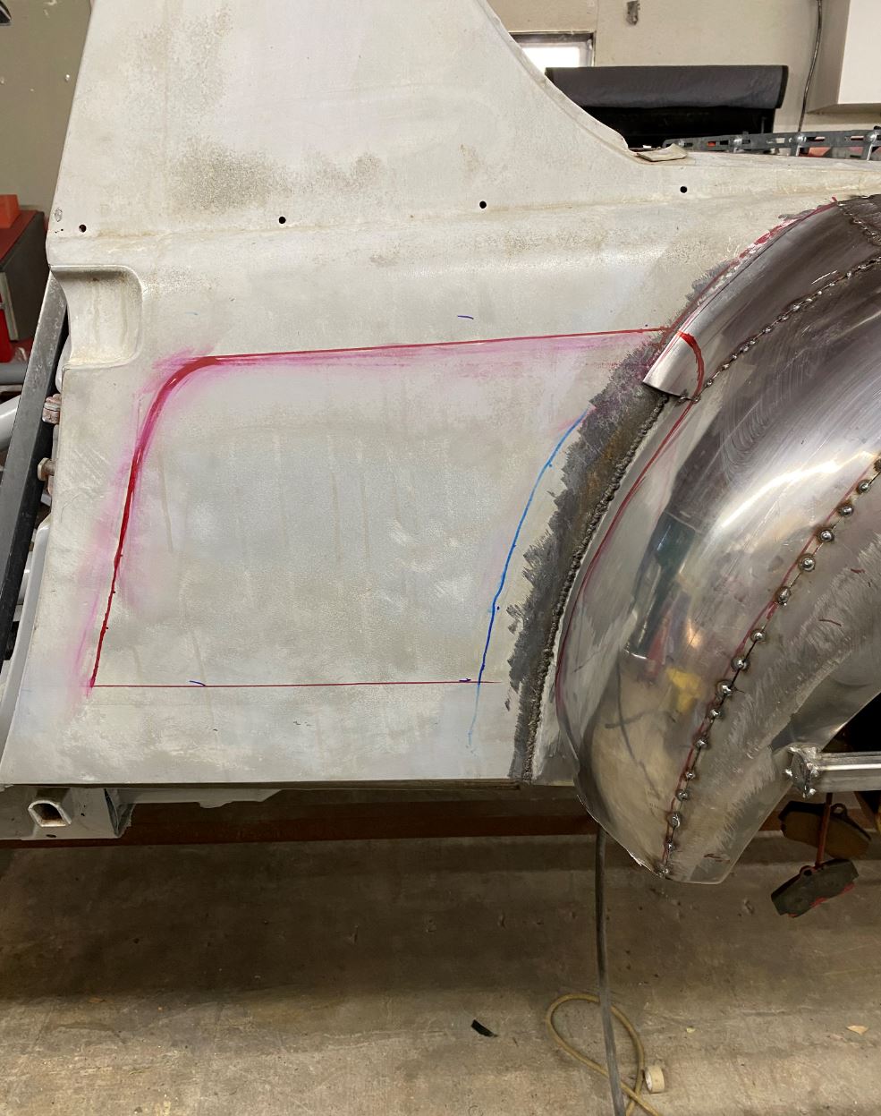

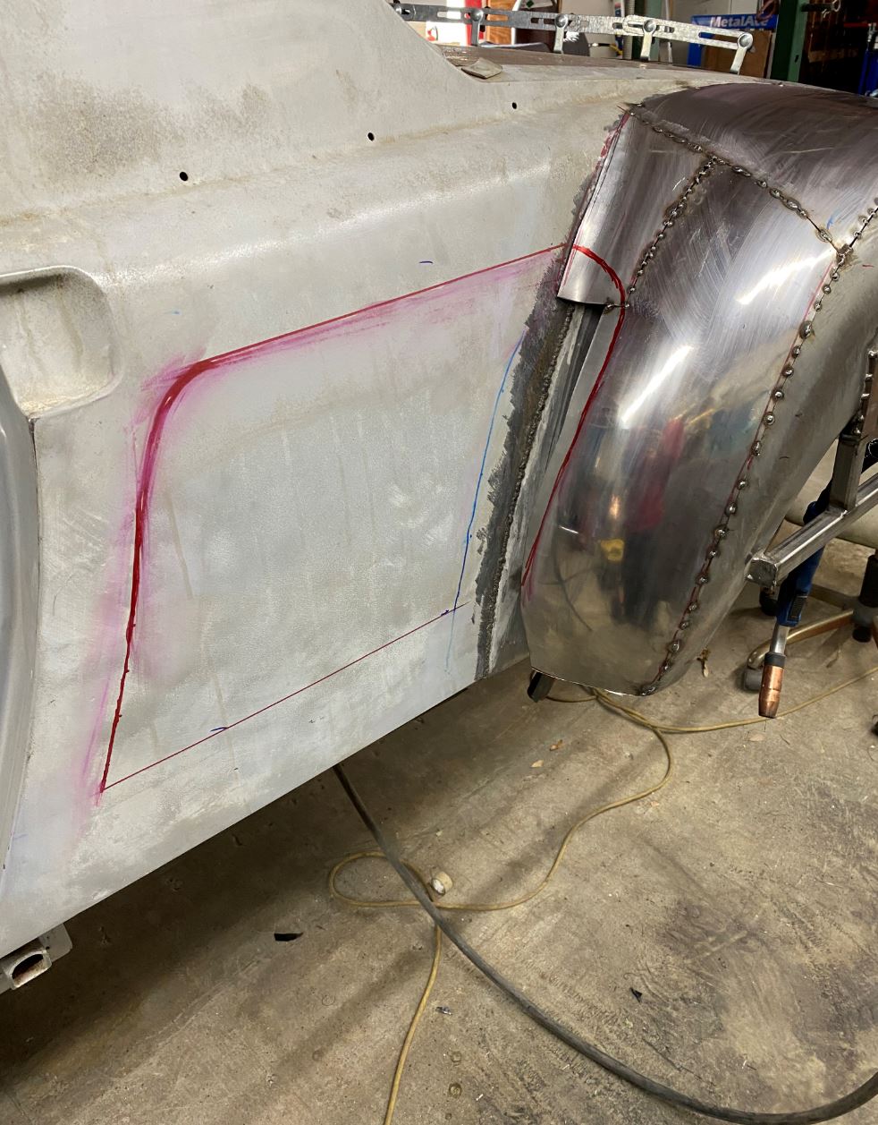

ON TO THE QUARTER PANEL
This is the direction that I'm going with to cut in the 1/4 panel to couch the air to water intercoolers as well as the cold air intakes. The cut will taper from o" depth at the door to 12" depth at the back. Notice how the top cut line is not level, it actually tapers up to follow that ever so slight rise in the 914 silhouette. The bottom line is parallel with the rocker panel.
By the way does anyone know how tall those Porsche side panel stickers are? The ones that go along the bottom of the door. I need a pair but in the negative. I'm thinking of dark metallic charcoal grey for the entirety of the car and then spraying the Porsche sticker logo in a Carrera silver along the bottom of the doors, like the stickers. I may continue that silver into the intake at the 1/4 panels. The rockers will be in black and they will follow the silhouette of the fenders.

Member No.: 1,659
Looking awesome!!
When you say 12" depth at the back is that measured off the OEM quarter panel or from the corresponding point on your flares? Asking since it looks like the heat exchangers will be in the wheel wells.

QUOTE(jd74914 @ Feb 11 2021, 11:55 AM) *
Looking awesome!!
From the OEM 1/4 panel. The heat exchangers will not be in the wheel wells.

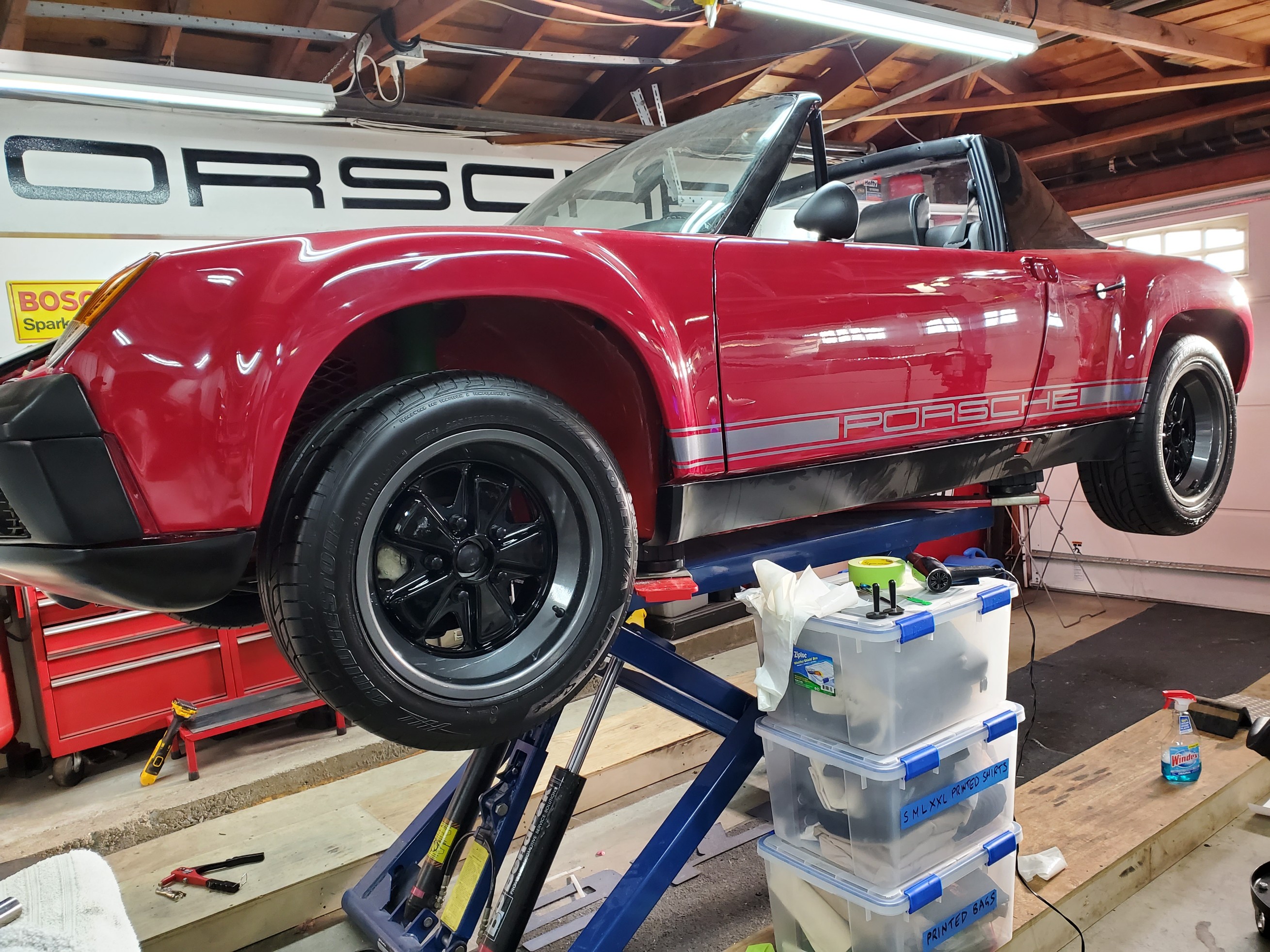

QUOTE(Curbandgutter @ Feb 11 2021, 09:35 AM) *
Hey Rudy, here are my dark silver side panel decals on Chucky
~ $70 (set)

<b>@ValcoOscar </b> that's what I'm looking for. But I need the silver part to be open. I would use the sticker to spray the silver portion onto the car then pull the sticker off. How tall is the sticker? I need to know so that I don't cut the 1/4 panel too tall. By the way what is Chucky's. I google it and all I get is the chucky doll. (IMG:style_emoticons/default/screwy.gif)

QUOTE(Curbandgutter @ Feb 11 2021, 01:38 PM) *
Oscar that's what I'm looking for. But I need the silver part to be open. I would use the sticker to spray the silver portion onto the car then pull the sticker off. How tall is the sticker? I need to know so that I don't cut the 1/4 panel to tall. By the way what is Chucky's. I google it and all I get is the chucky doll. (IMG:style_emoticons/default/screwy.gif)
I will get you height later today, Chucky is my latest 914, LSV8 powered.
But next to your car I may have to rename it Barney (IMG:style_emoticons/default/headbang.gif)

I have these coming in dark silver as a back up.
Not sure if I'll swap out (IMG:style_emoticons/default/idea.gif)

Hey Rudy
My side decals measure 3.00 tall
@curbandgutter
0
Curbandgutter
post Feb 12 2021, 11:33 AM
Post #654
Posts: 566
Joined: 8-March 13
From: Murrieta CA
Member No.: 15,637
QUOTE(ValcoOscar @ Feb 12 2021, 07:33 AM) *
Hey Rudy
@curbandgutter
0
Thanks bud. I gave myself 4" so I'm free and clear to cut in.

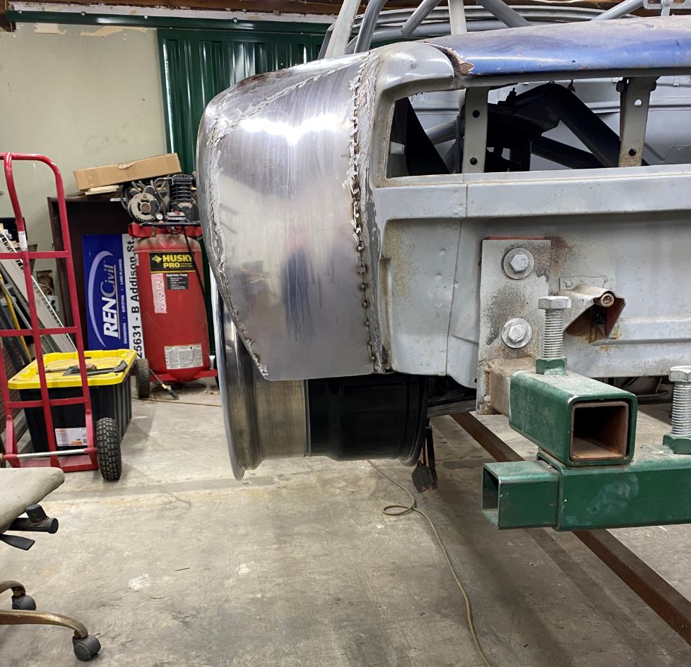

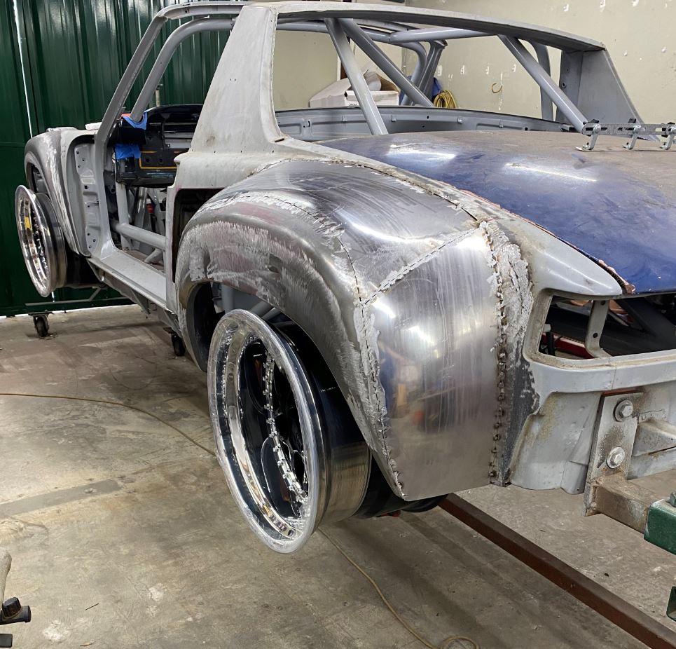

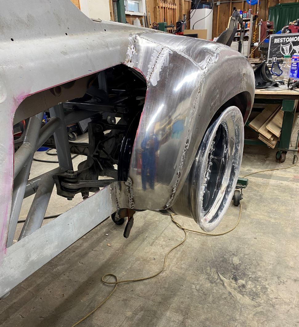

LEFT REAR PRETTY COMPLETE
INSERT SUIT CASE HERE Attached Image
sixnotfour
post Feb 13 2021, 05:46 PM
Post #656
Posts: 11,401
Joined: 12-September 04
Member No.: 2,744
you should jack the wheel to stance position... :trophy:

That's looking really awesome!!! Keep at it!!!
Are you making a wood buck or two for the pass side?
