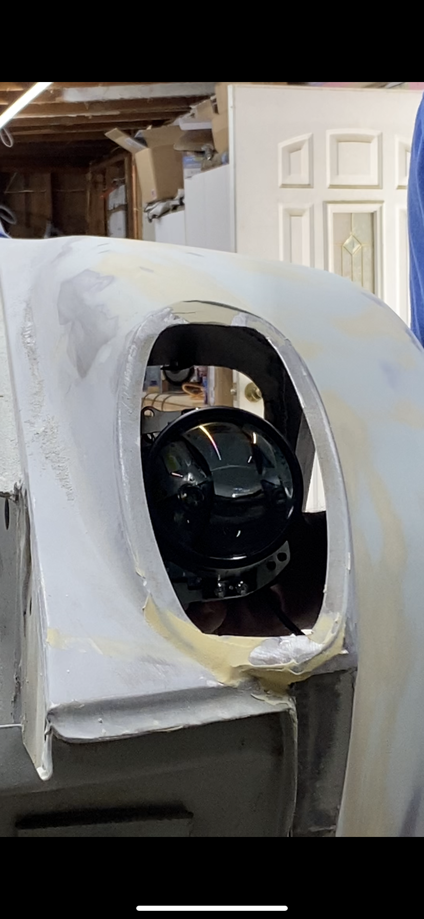

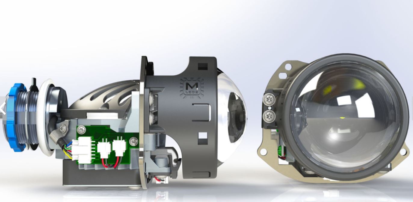

@mgarrison YES they are Morimoto LED 2.0 LED projectors with high and low beam integrated in one unit. These are supposed to be the bees knees. (IMG:style_emoticons/default/cheer.gif) (IMG:style_emoticons/default/cheer.gif) (IMG:style_emoticons/default/cheer.gif)
now I just need to build an assembly that is adjustable, that can bolt up into the fender well, that is waterproof and I need to print up a new lense cover...thats all (IMG:style_emoticons/default/biggrin.gif) (IMG:style_emoticons/default/biggrin.gif) Attached Image

Yes,
I will be making a custom headlight bucket. There's really nothing out there that can be easily modified to hold those LEDs.

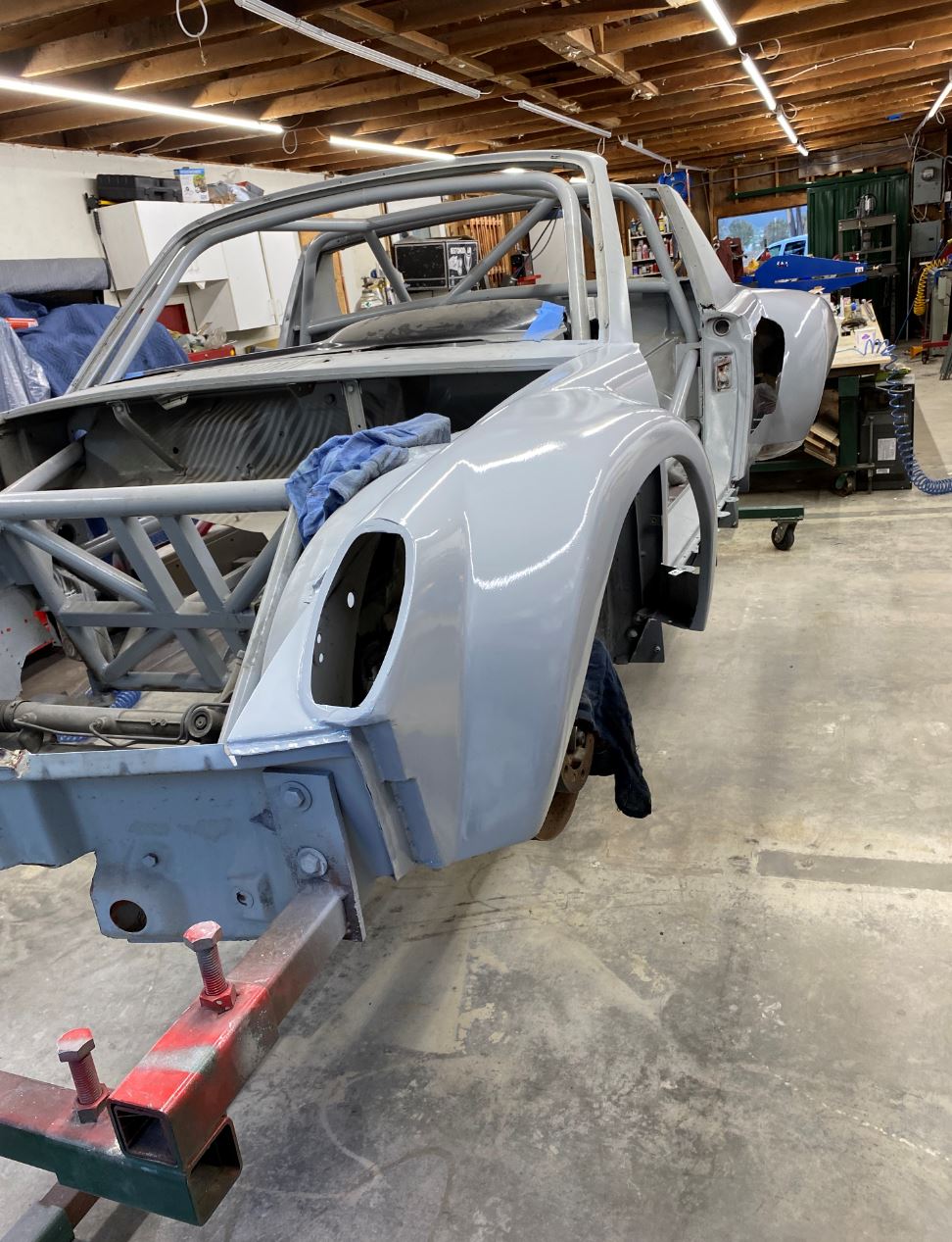

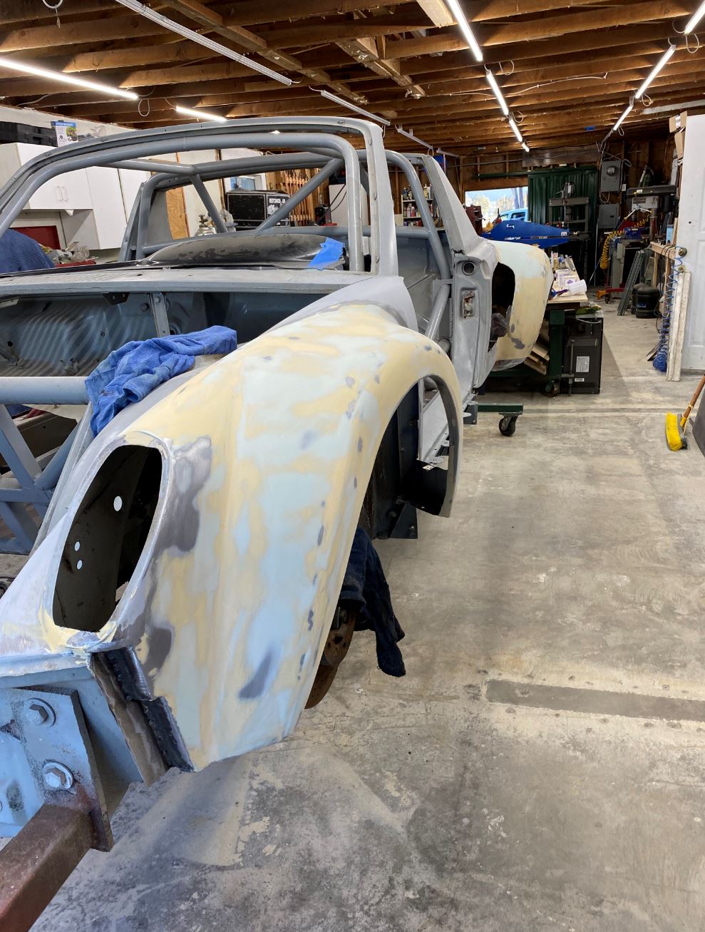

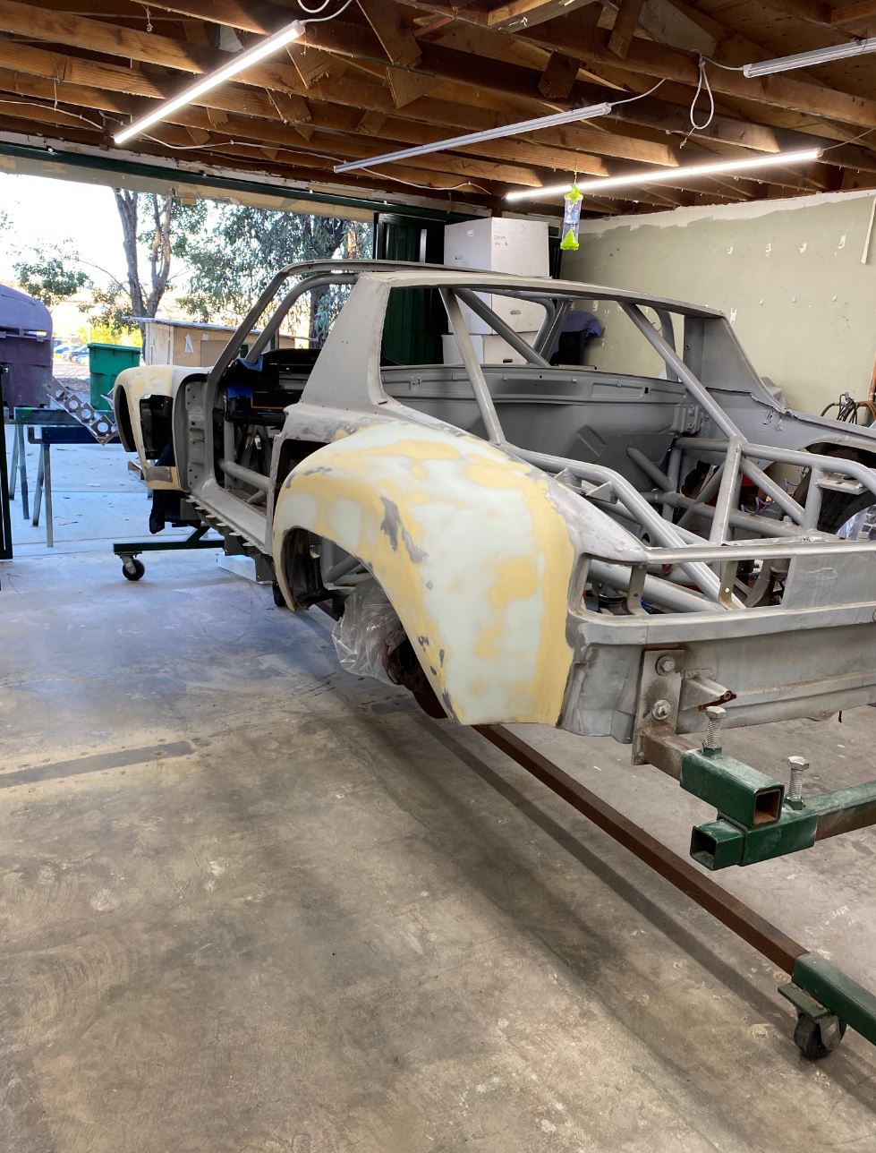

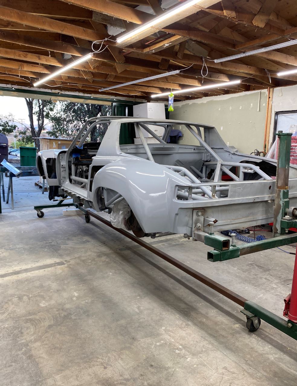

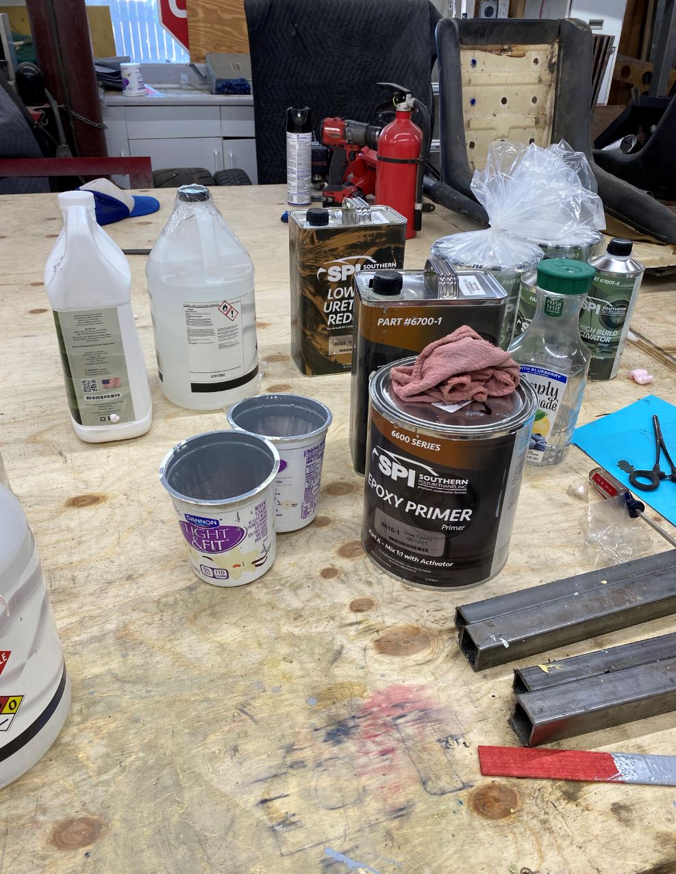

I was finally able to get a coat of epoxy primer on the fenders. The epoxy is supposed to seal the work so that water can't get to the metal and bodywork. Then I will shoot with 3 coats of high fill 2 part primer. Then block sand and get all mini waves out. I'm very happy with the body work. By the way, the primer I'm using is SPI........amazing stuff.
It's all made in the USA, and their epoxy primer happens to be sandable.
Before Attached Image
After Attached Image
Primers Attached Image
