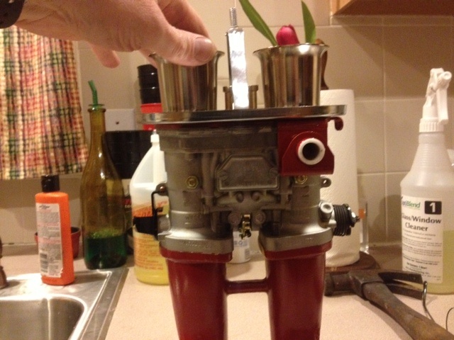

May not be apparent but if you do the bench install as indicated, the connection on the throttle plate for the cross bar link winds up on the wrong side. Meaning the cross bar is to the rear and the connection point is in the front. Attached Image

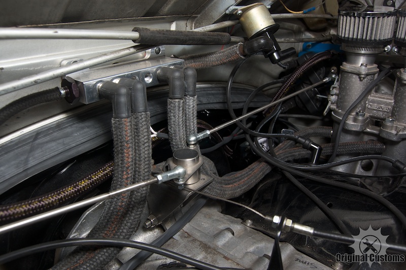

QUOTE(Mblizzard @ Apr 6 2013, 03:54 AM) *
So if I "Call McMark for some good linkage" where do I call and what is good linkage?
Mark DeBernardi is McMark here. He owns Original Customs and you may see the banner ad at the top or bottom of the page. The hex bar linkage is a bitch to work with. It is hard to synch and once it is synched will wear and go out of synch fairly soon. I even had one 'arm' break off and had to have my car towed because it was only running on one carb... Mark recommends an imported linkage setup that I have found to be very accurate, easy to synch, and stays tuned... Pic below...

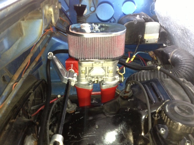

Installation looks pretty good. Some set up still to come. Attached Image
