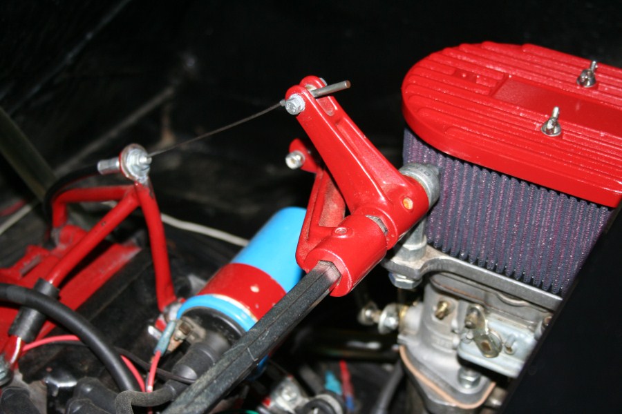

I've had problems like that and it was idle jets. It doesn't take much to clog them. By the way there is nothing wrong with the cross bar linkage if it's set up correctly.

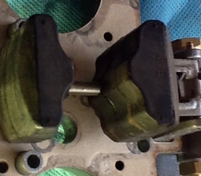

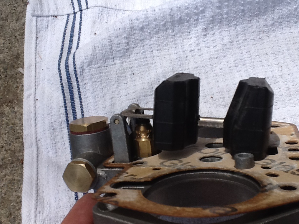

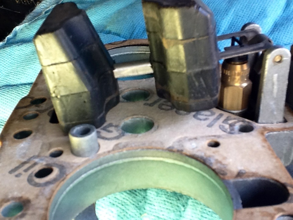

The more I think about this I am coming to believe it is the idle jets and I think I know why. Maybe hard to see but I happened to be checking the float level again and had the floats side by side. Side by side one looks brand new as it should and one looks used.
The first two photos are of the float that looks used.
Look at the brown rings on the float and note that it appears to be quite scuffed up. In fact, I think that small pieces are coming off this float and clogging the idle jets or other parts of the carb. If you zoom in on the photo on top to the lower right hand side on top of the float you can see a small opening in the covering of the float which releases small pieces when touched.
The last picture is of the new appearing float. I think someone owes new a new float, possibly new carbs, and a week of my life back!
