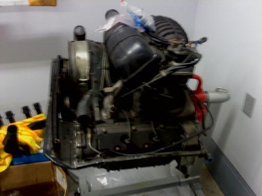

I have a 1977 2.7CIS engine on an engine yoke for the past year or so (while I gathered up parts for my conversion).
Well, the guy that owns the yoke needs it back this weekend. What's the best way to store this engine for the next 6-months+ ? I still have the stand but won't have the approved yoke to attach it with. Thanks for the suggestions. Sorry for the OLD crappy mobile phone picture, but I figured I'd post a picture of the engine for the first time on this board. Attached image(s)

AZ914 Well you could buy a yoke I guess ;) I got mine... Apr 9 2013, 09:45 AM
mepstein Drop it on a $10 furniture cart so it's e... Apr 9 2013, 09:54 AM
JmuRiz Good idea, I guess if it's good enough for my ... Apr 9 2013, 10:02 AM
toolguy be careful not to crush the oil return tubes Apr 9 2013, 10:56 AM
Jeffs9146 You can get universal yokes cheep from your FLAPS ... Apr 9 2013, 10:58 AM![]() ![]() |
