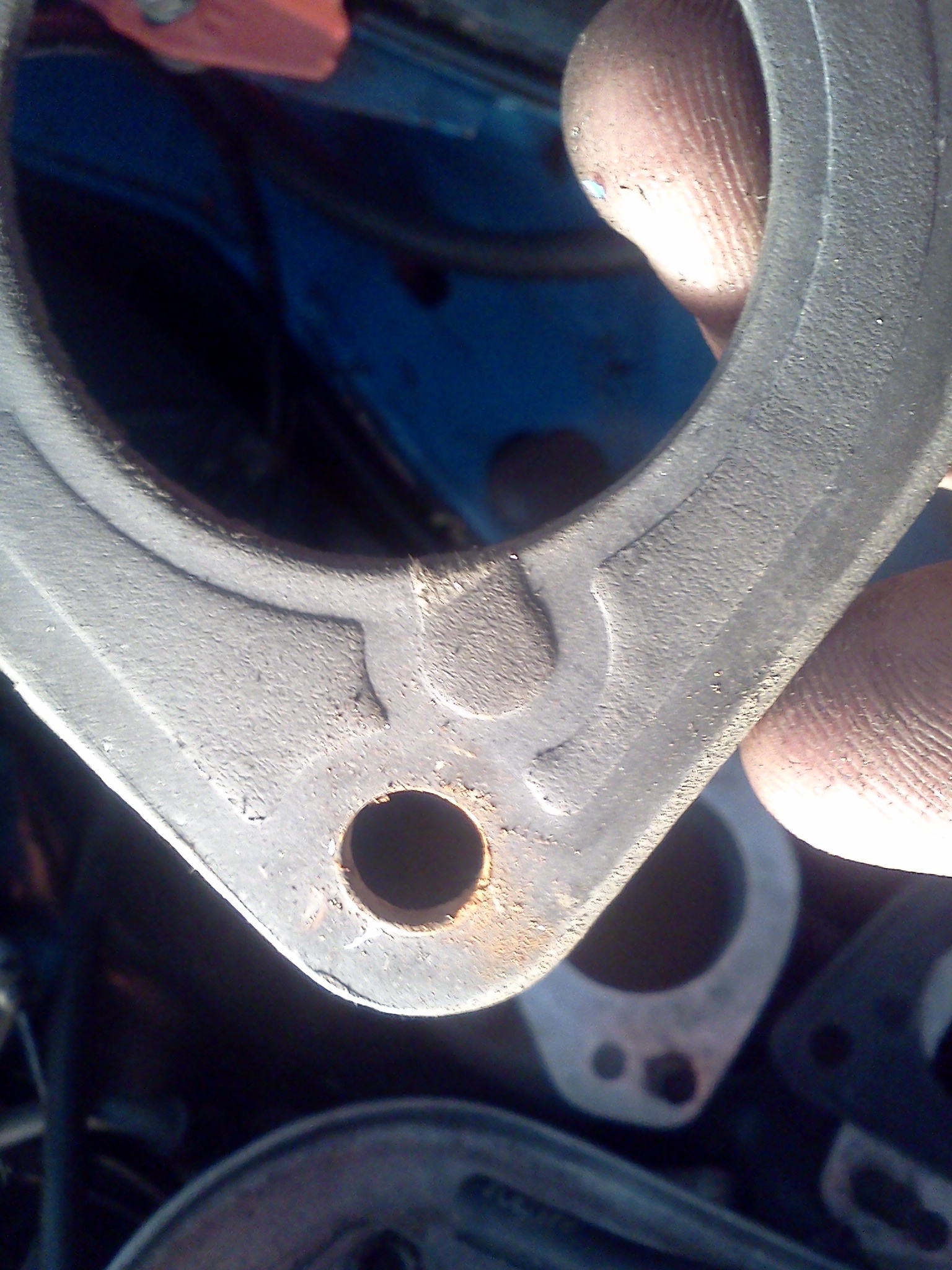

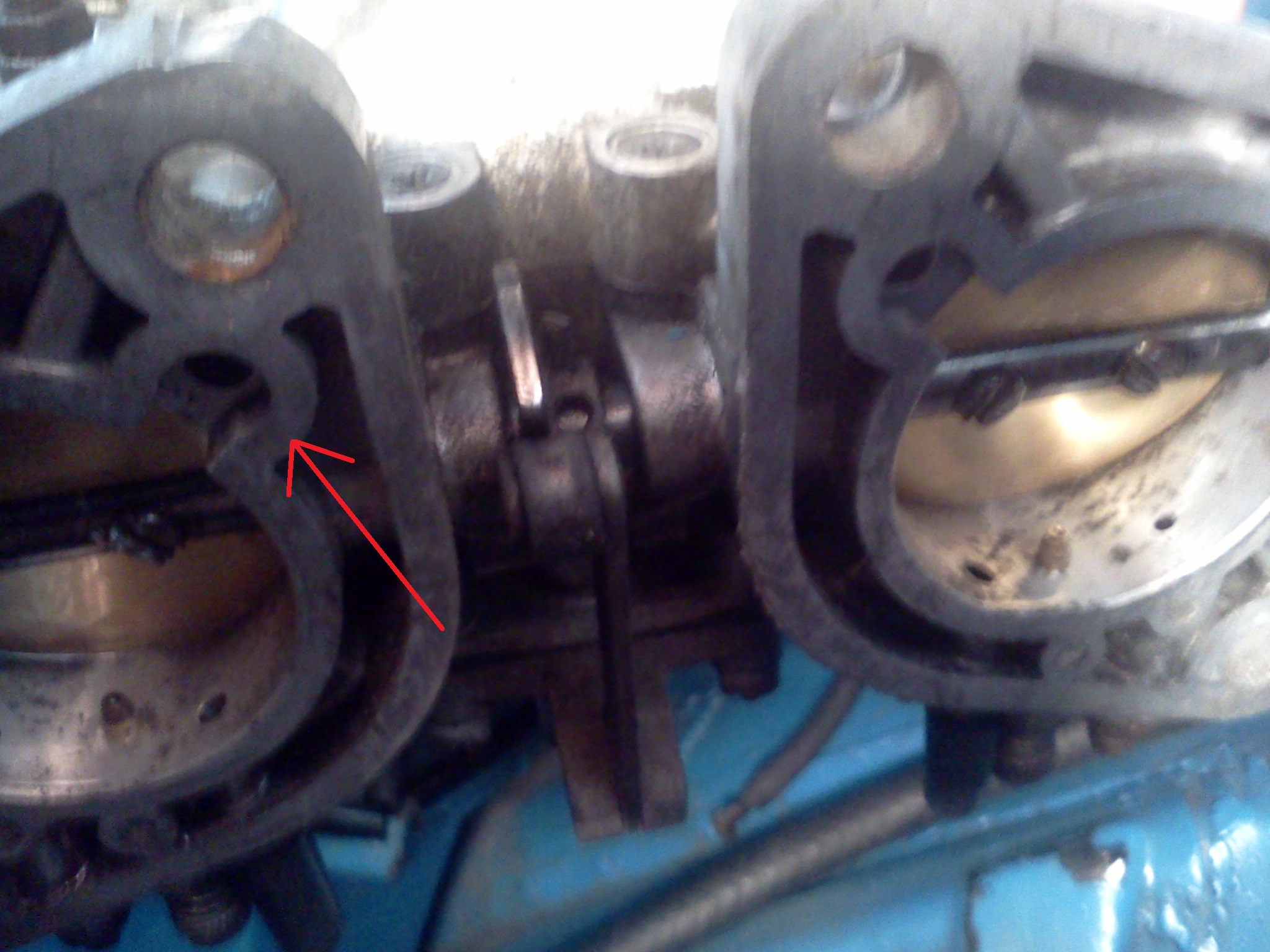

Hi guys,
Running out of time, but at least I think this is a simple problem. "Old dog" had it right. Vacuum leak at the base of the carb. Gaskets are all new, but check the pictures below. Any of you familiar with Weber IDFs know if this passage is supposed to be open? Are the gaskets supposed to cover up these holes? I've noticed it before, but figured they were supposed to be open to the manifold. I can't quite tell if they are compressed all the way, or if there is really a vacuum in this location. You can see the indentations in the gasket below.
Leaving for the DE tomorrow, so I'm hoping to get it fixed tonight. If the leak isn't coming from here, I can't figure out where it would be coming from. (IMG:style_emoticons/default/confused24.gif) Nothing else stood out to me.
On that note, can anyone think of a quick fit that would get me through the weekend? I think Permatext grey is gasoline resistant. (IMG:style_emoticons/default/idea.gif)

Gasket is correct. Hole is correct. A vacuum leak would show up at idle and not 4K. I'd also take a close look at your linkage. If it's wonky you'll get pops. Show us a picture of your linkage.

QUOTE(jmill @ May 9 2013, 10:30 PM) *
John,
Its pretty dark here, so pics would be difficult. But it's a Tangerine Racing cable setup that has worked great so far. Carbs were still synched, both at idle and at 3,000 RPM after checking with my snail gauge.
I though that port was correct on the bottom, but could never tell if a PO had messed with them. The reason I'm suspecting a leak between intake and carb is via the old carb cleaner trick. Sprayed the base of the carb with cleaner and the idle dropped noticably. I'm going to look at other areas of the carb and inspect for potential leaks, possibly the manifold vacuum tubes (these are an older set of carbs that actually have two brass tubes protruding from the base of the carb for manifold vac.) It's possible that the throttle shaft is leaking as well, since these are very, very old. One carb has already been re-bushed, but I can't remember which one.
