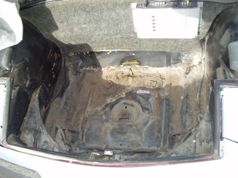

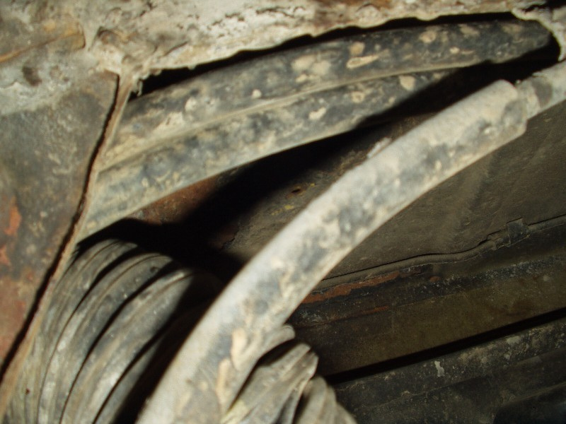

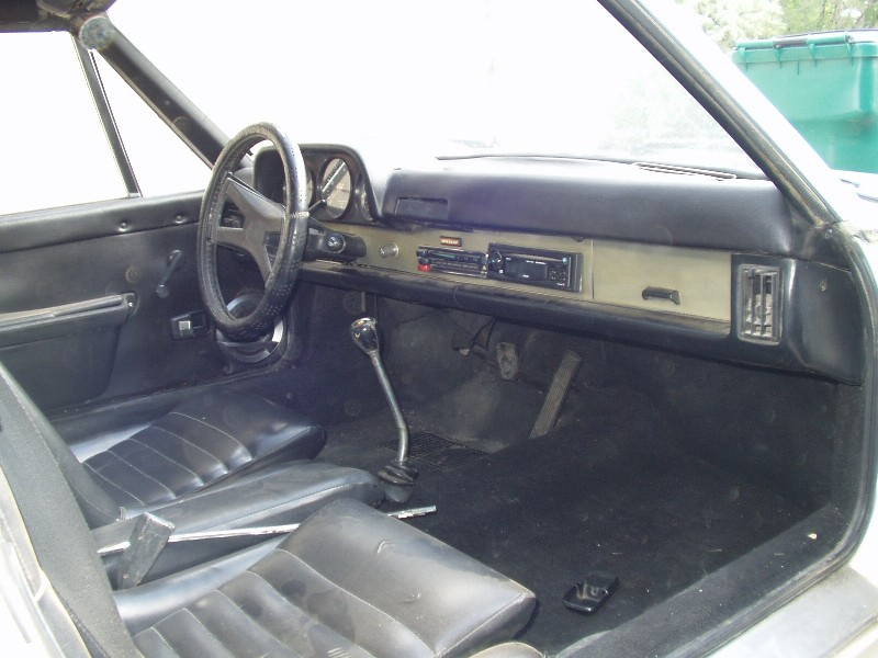

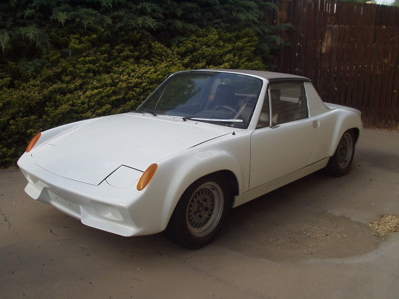

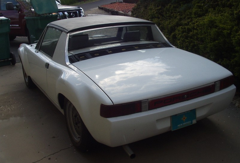

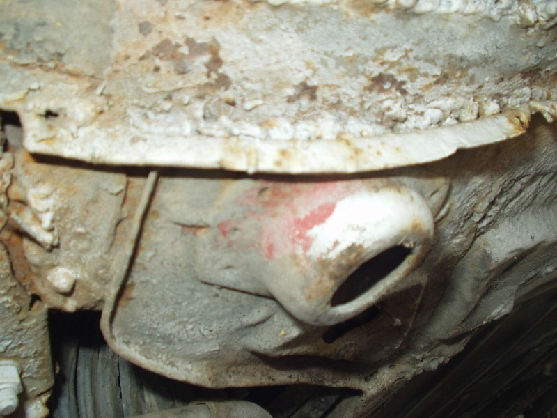

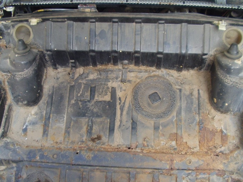

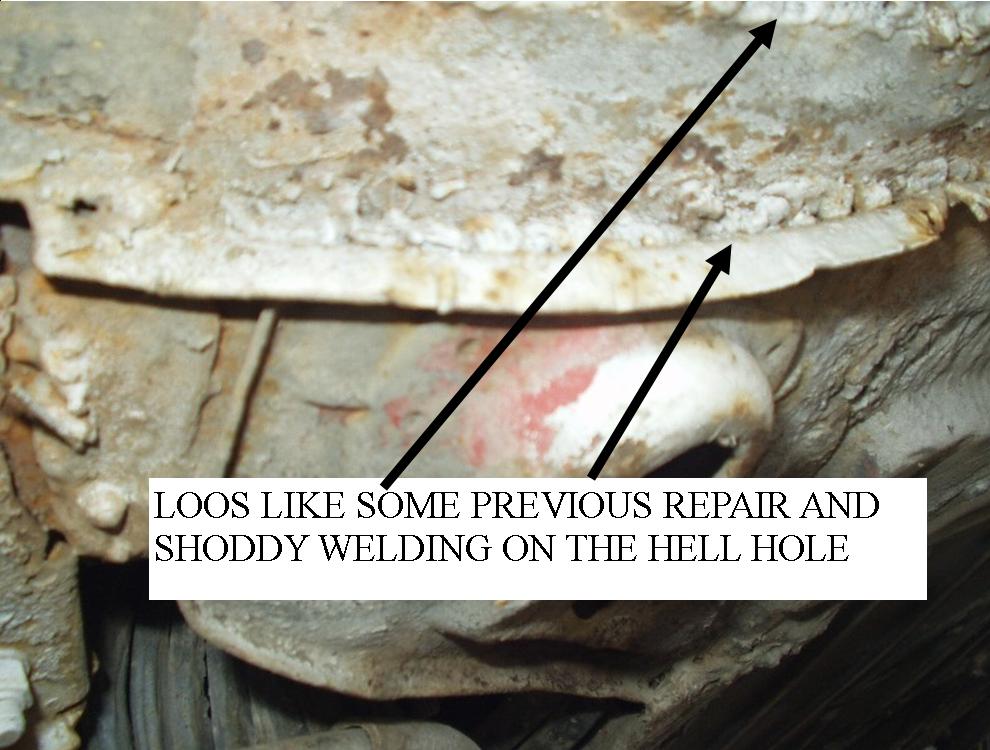

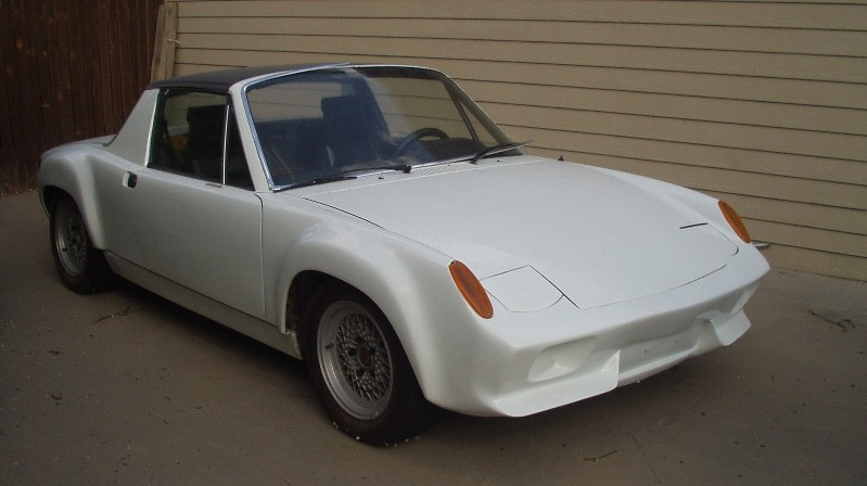

Here's pics.
(IMG:http://www.914world.com/bbs2/uploads_offsite/farm8.staticflickr.com-15842-1368422170.1.jpg)
(IMG:http://www.914world.com/bbs2/uploads_offsite/farm8.staticflickr.com-15842-1368422170.2.jpg)
(IMG:http://www.914world.com/bbs2/uploads_offsite/farm8.staticflickr.com-15842-1368422170.3.jpg)
(IMG:http://www.914world.com/bbs2/uploads_offsite/farm8.staticflickr.com-15842-1368422171.4.jpg)
(IMG:http://www.914world.com/bbs2/uploads_offsite/farm8.staticflickr.com-15842-1368422171.5.jpg)
(IMG:http://www.914world.com/bbs2/uploads_offsite/farm8.staticflickr.com-15842-1368422171.6.jpg)
(IMG:http://www.914world.com/bbs2/uploads_offsite/farm8.staticflickr.com-15842-1368422171.7.jpg)
(IMG:http://www.914world.com/bbs2/uploads_offsite/farm8.staticflickr.com-15842-1368422172.8.jpg)
Last 2 are underside 1 in front of passenger rear wheel, the other closer to center looking forward.

If you don't buy it, I will! Someone did a nice job on the body work.

Looks like a good deal - if the rust is bad, you could always make money parting it out.
While the body looks good, I don't like when bumpers are molded in - too many chances for cracking! IMHO

the rust in the rear trunk worries me.
you need to reach down into the hell hole below the battery...
and pull the rockers to check the jack points/longitudinal

A pair of flared rocker panels would finish that fine.

I have looked at a lot of 914s over the last few months trying to find a good project car, and have seen a lot of so called "daily-drivers," beware indeed. From the pictures it looks like a $1000 is not a bad price. (IMG:style_emoticons/default/welcome.png)

I see some long repair...

I agree.
Bought it yesterday and drove it 15 miles home. Goes down the road OK. Will cruise at 65-70 seems like no problems. As I dig into it I'll let y'all know what I find - probably will be searching for more info.

Look to the far left on the photo with arrows. Is that a rust crack to the far left of the jack donut?
Hard to tell from the picture but needs a look over.
