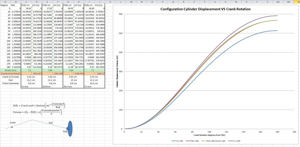

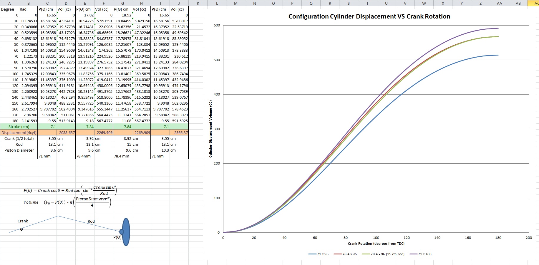

AE354803
post May 17 2013, 03:25 PM
Posts: 238
Joined: 13-August 12
From: Southern California
Member No.: 14,801
QUOTE(r_towle @ May 16 2013, 10:33 AM) *
Djet can go up to 2.4 liter with the 71mm stroke (stock) crank.
That is 103mm pistons.
It cannot deal with a longer stroke.
rich
Rich, just a curiosity, why can't the Djet system deal with a longer stroke?
If the capacity of the engine is the same why would it matter whether it was because of a larger diameter or a longer stroke, the FI is most concerned with the flow of air into the engine? I would expect the flow rate of air into the cylinder to be essentially the same at a given RPM if everything else was identical.
You can see from the graph that the change in volume (flow) into cylinders follows the same basic path. (the 103 mm x 71 yields a larger displacement than 96 mm x 78.4 but even if it's changed to 101 mm it still follows approximately the same curve) You can see how the rod length affects the curve by essentially flattening it as length increases.
Again I have no idea, but this surprised me.
Andy
