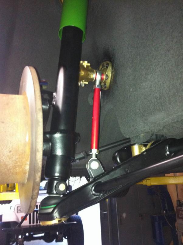

I put Lotus Joes car on a lift and checked all of it for play. none to be found.
