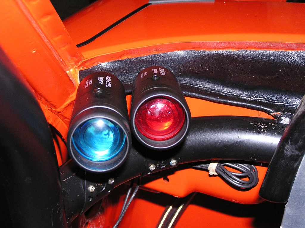

I use these for my oil pressure light and alternator light:

Those would get my attention!

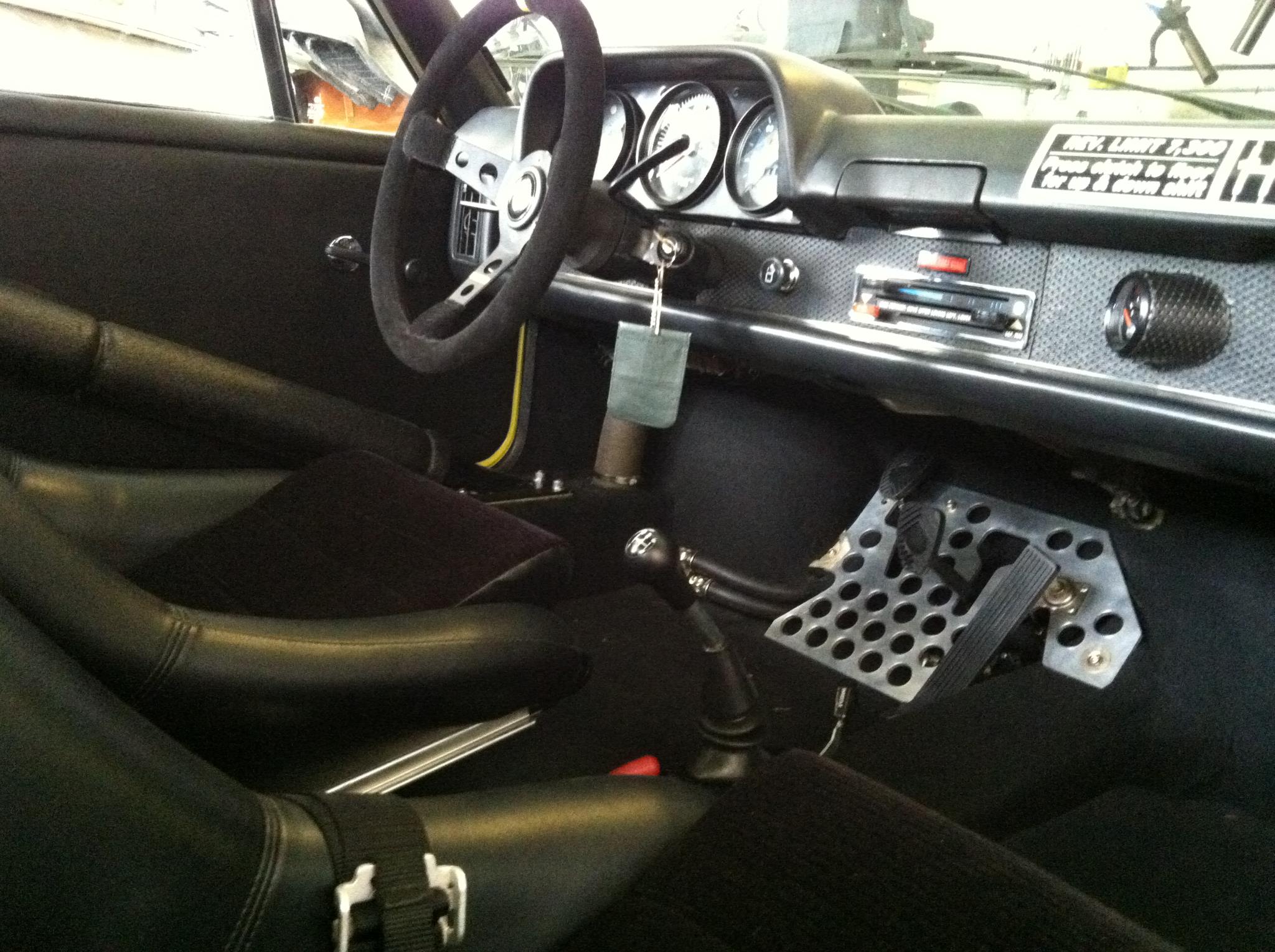

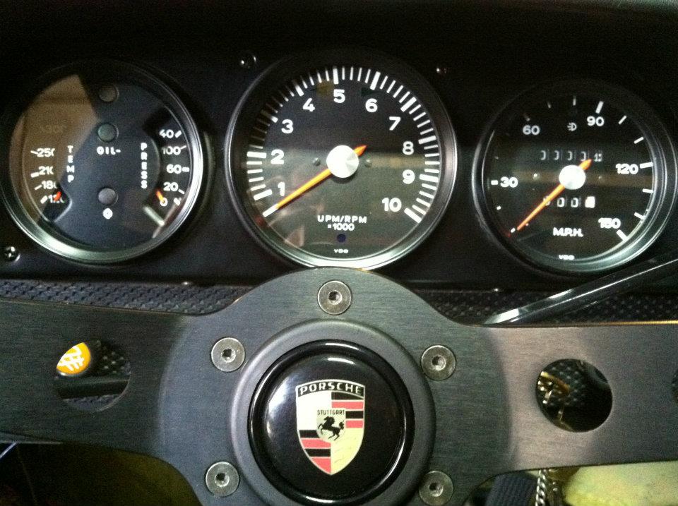

Stock(ish) has oil pressure and alternator lights:
(IMG:http://www.914world.com/bbs2/uploads_offsite/fbcdn-sphotos-f-a.akamaihd.net-1110-1369241699.1.jpg)
Fuel Gauge in the radio delete location:
(IMG:http://www.914world.com/bbs2/uploads_offsite/sphotos-b.xx.fbcdn.net-1110-1369241701.2.jpg)

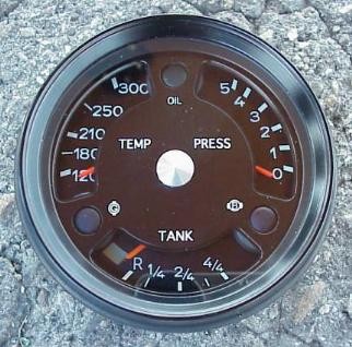

I like this gauge below. I just think that as expensive as these engines are you would want to monitor as many systems as possible,

Yep, that's the way to go, has the low fuel light, alternator light, and oil temp light....if only they were still making the kits....

Never liked the triple gauges I've seen because the face is stamped fairly crude. No beveled edges.
911 Combo gauge gives you all that except the fuel gauge.
