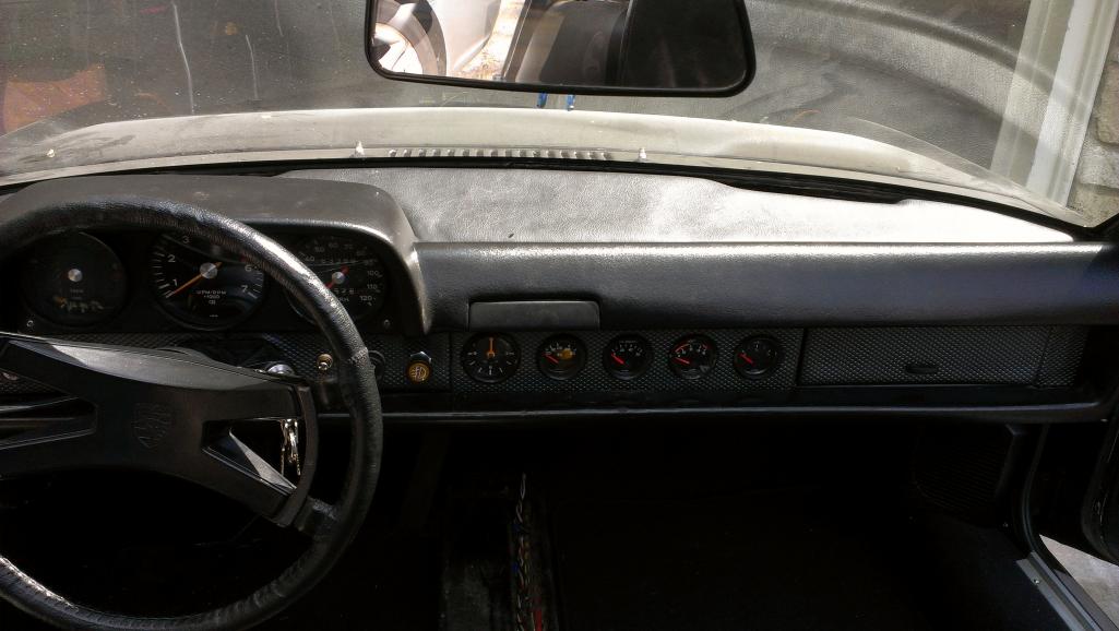

QUOTE(billh1963 @ May 21 2013, 06:20 PM) *
What gauges would you install for an air cooled 6?
(IMG:http://www.914world.com/bbs2/uploads/post-14538-1369266028.jpg)
