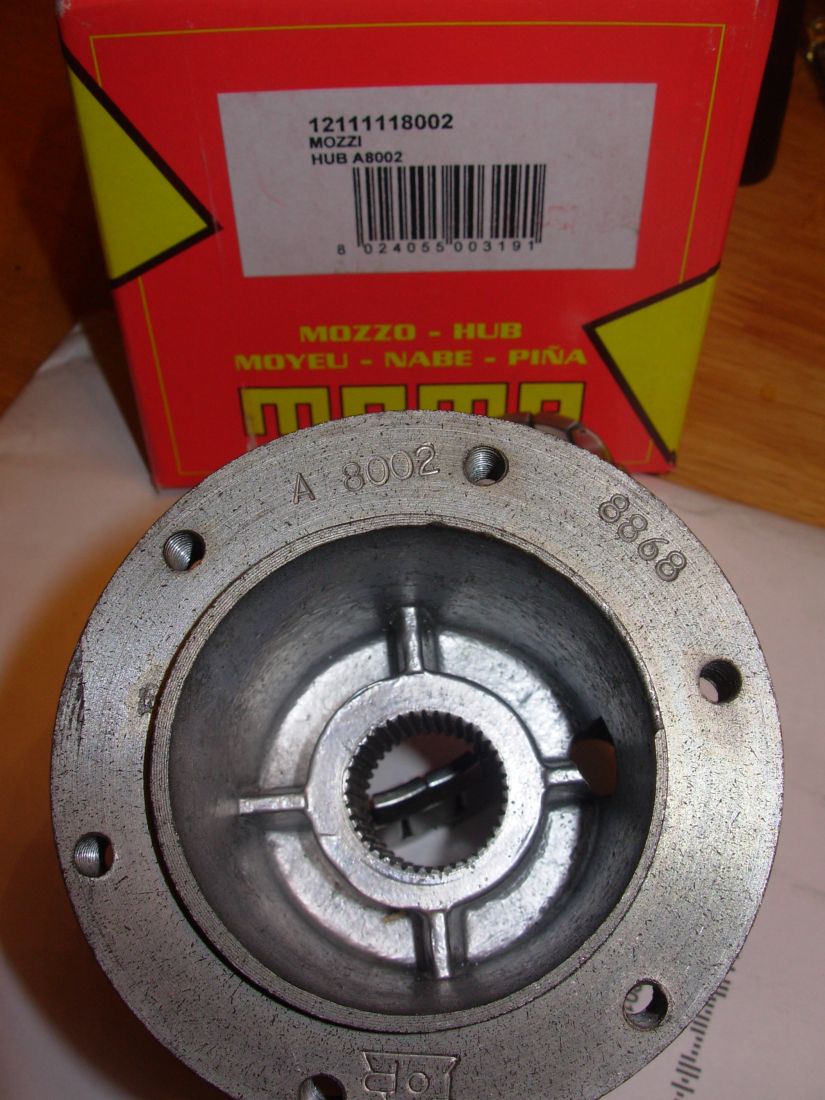

Got a Problem - I ordered a MOMO Steering Wheel & Adaptor for my 72 914 and the Adaptor doesn't fit! (IMG:style_emoticons/default/headbang.gif)
I know that the 70 & 71s have a different spline count & my 72 is not an early car. Could I have a Bad Adaptor ( it is the Correct MOMO #)? Anybody else experience this? |

If you look at the picture of my Adaptor, some of the Splines have a Sharp V-Shaped Edge & some are squared off - wondering if I got a Bad Casting or ?

Someone could have mangled it on the wrong car and returned it, where it was resold.
Is it too late to return? I have to say mine goes on smoothly. |

Someone could have mangled it on the wrong car and returned it, where it was resold. Is it too late to return? I have to say mine goes on smoothly. I can return it (but have to pay the Shipping). I have an oddball aftermarket steering wheel/adaptor & it goes on smoothly. |

Spacer adapters are cheap,, if you have a hub look for one of those

Spacer adapters are cheap,, if you have a hub look for one of those The Problem is the MOMO Hub - I'm going to take it over to URY's on Saturday to see if it fits his 73 - Maybe my Steering Shaft has been changed out (IMG:style_emoticons/default/confused24.gif) |

Well, I confirmed I have a Bad Hub - I went by URY's and it didn't fit his 73.
So Monday it goes back to the Vendor & I'll try another one |
