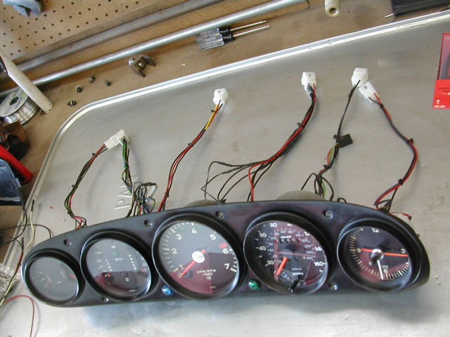

I am going to a 911 dash and saw awhile back a members picture where they used multi pin connectors to simplify things and i really like the idea and want to implement it myself in my conversion and other spots like the turn signal buckets. I have looked on digi-key but quickly get lost in the lingo used in their catalog since i am not super familiar with the electrical side of things. Can someone please help me out with this one. will need the male and matching female connectors along with the proper type of male and female terminals used that are soldered to the wires.

Those look like Molex brand. You would have to measure the pins but they look like .062 not the .093

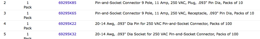

Check out McMaster ( http://www.mcmaster.com/#connector-plugs/=mv7k0d )
The "Compact Push-In" connectors are dirt cheap.
Mouser.com is an awesome site for connectors, they can be a little overwhelming, but if you want a 47 pin circular connector with gold connector and a cadmium finish, they will have it. You could honestly hook then entire dash to one connector if you want to.

Awesome! thank you gentlemen (IMG:style_emoticons/default/beerchug.gif)
I dont know why i didnt look on McMaster for these before!! they make it so simple by only giving me a few options. (IMG:style_emoticons/default/piratenanner.gif)
Do you agree that the space saver 250V should work for my application?

I would get the 250V non space saver, the 0.093" pin will be much easier to work with and you should have excess amperage to stay on the safe side. The amount of space saved isn't much if you look at dimensions. Don't forget pins and sockets.
Just make sure you aren't going over the amp rating, but I can't think of anything in the gauge cluster that would draw that much...

I was just about to post a double reply saying i just saw the space saver ones are only rated for 5 amps! Thank you for pointing that out as well!
What AWG are the cluster wires typically, 30-24 or 24-18??

QUOTE(dfelz @ May 22 2013, 04:41 PM) *
Since this is a picture of my gauge cluster ... (IMG:style_emoticons/default/biggrin.gif)
PM McMark, he actually ordered these for me.
They were very easy to work with and have been holding up just fine.
(IMG:style_emoticons/default/chowtime.gif)

Here's the PN for the ones pictured above. I've found more advanced connectors that I like better than these, but it takes me an hour or more to search out all the correct PNs for all the pieces. These will work though.
