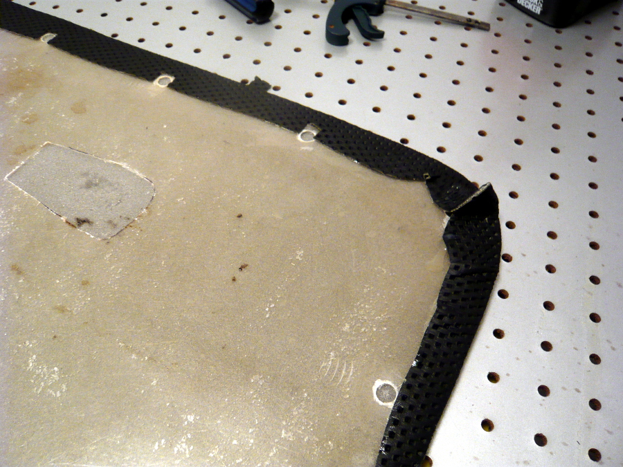

I admit I'm lost without a stapler. There are two things I don't know how to do. I have the aluminum strip riveted in and the bolster is nicely aligned with positive lock. But I don't know exactly how to attach the vinyl on the backside without a stapler. Sure there's contact cement, but it doesn't seem like that would work conveniently because you can't just inch your way along and keep the vinyl nice and and tight around the corners.
Any ideas from those smarter than I?
-marcus
r3dplanet
post May 23 2013, 11:54 PM
Posts: 679
Joined: 3-September 05
From: Portland, Oregon
Member No.: 4,741

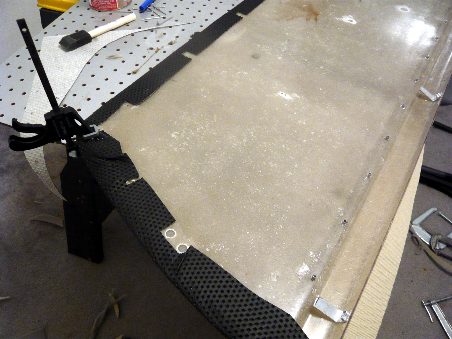

Well, I *think* the answer is contact cement. Yes, it's just glue. Yes, I wonder about how long it will last. Yes, the manufacturer website says that it won't actually hold forever. Yes, I would feel better with some sort of metal fastener.
But here it is. The contact cement had a different behavior than I was expecting. I glued up both the fiberglass and the vinyl back and let them sit for 15 minutes, just as the can says to do. It felt weird because after this period the glue was not tacky at all. But after squishing the parts together they held quite well, and allowed me to inch along as I had hoped. I actually split this job into three sections just to keep from being stupid.
Problem-o solved-o.
At least for now.

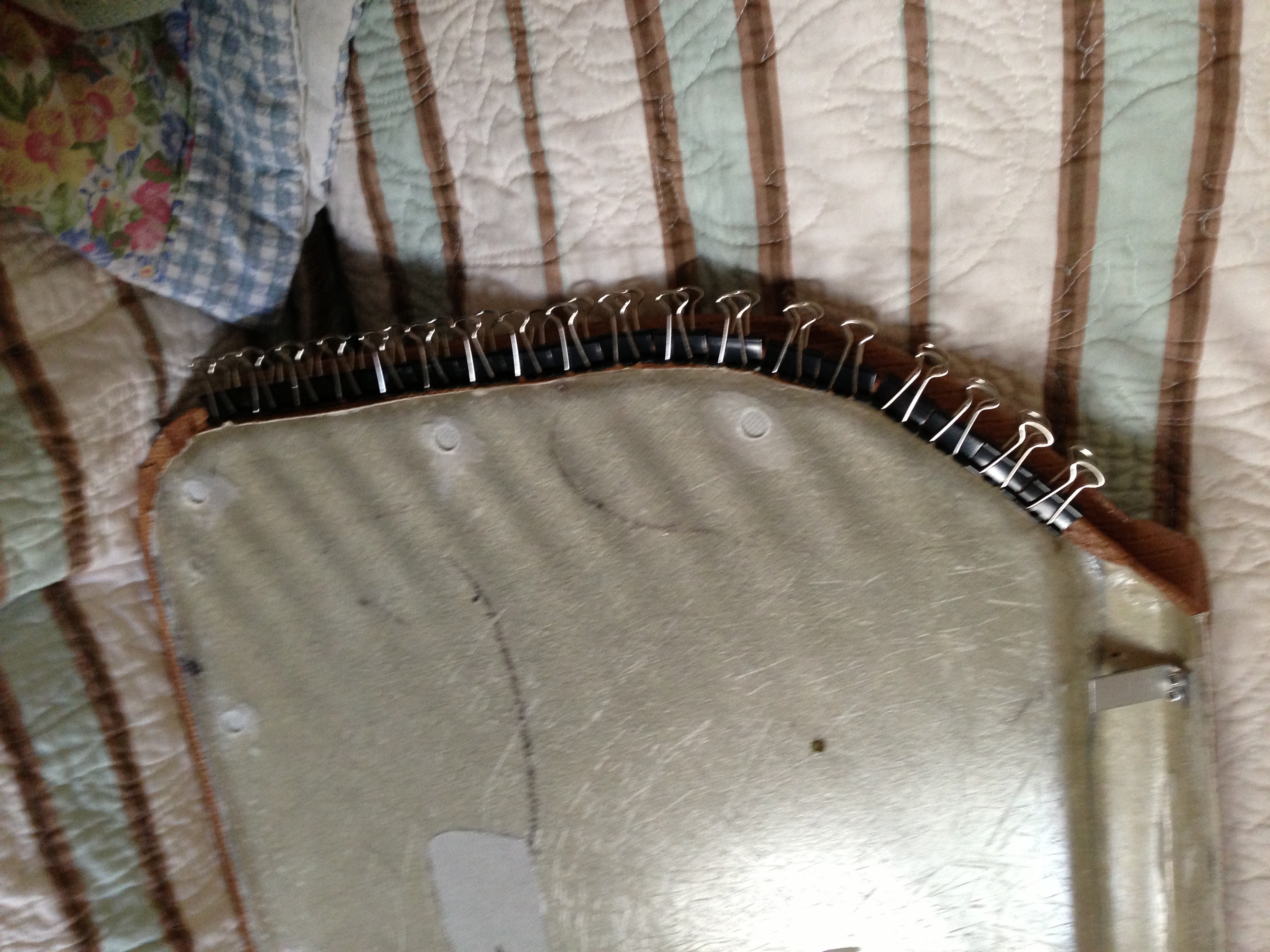

Mikey914 had posted that he only used glue. I used a 3M spray adhesive and I used small binder clips around the perimeter to hold the vinyl to the fiberglass. The fiberglass is much harder and thinner than the Origional fiber board. This may be why he recommends glue only. I will post some photos of mine once I get home

Here are the binder clips that I used to hold the vinyl while the glue was drying

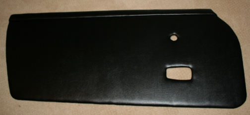

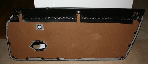

$25 for all materials per panel including a new panel cut from fiberboard I picked up at home depot. (just a hair thicker than the stock fiberboard) No glueing required. Not as durable as fiberglass but for a car that doesn't often see rain I wasn't concerned.

The problem with just using a flat piece of fiberboard is the top bolster. Just curious how you address that as there is a curve in it. Looks like you may have taken the top off the old panel and attached it somehow?

The early door panels, the top is actually metal, so the whole board part is flat.
Yup. I re-used the metal top part from an early model door panel and attached it in the same way to the new panel I made. On the later cars ('75-'76) the whole thing was fiberboard. So if you've got a later car and want new panels you either use the fiberglass version shown in this thread or find a set of cores from an early car.
