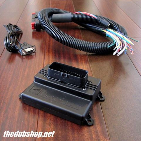

From Mario at thedubshop.net:
(IMG:http://www.914world.com/bbs2/uploads_offsite/fbcdn-sphotos-b-a.akamaihd.net-2618-1370613617.1.jpg)

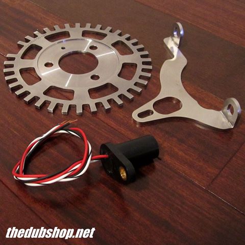

And:
(IMG:http://www.914world.com/bbs2/uploads_offsite/sphotos-a.xx.fbcdn.net-2618-1370613619.2.jpg)

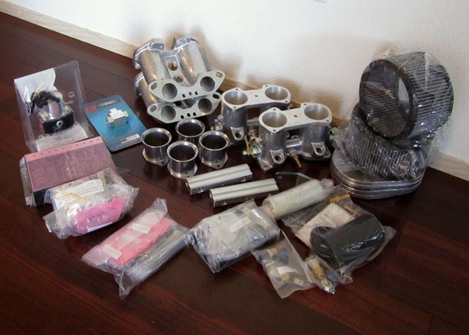

And CB ITB's:
(IMG:http://www.914world.com/bbs2/uploads_offsite/sphotos-b.xx.fbcdn.net-2618-1370613619.3.jpg)
He's done some good work for my son's turbo-Subaru bug. I don't know cost or anything, just noticed those while looking for some other things.

That is cool. It must be new because I don't remember their having an option for a 36-1 trigger wheel when I started my edis project back in February. I had to fab my own bracket and modify a stock trigger wheel.
(IMG:http://www.914world.com/bbs2/uploads_offsite/images.thesamba.com-11782-1370615044.1.jpg)
(IMG:http://www.914world.com/bbs2/uploads_offsite/images.thesamba.com-11782-1370615045.2.jpg)
I wonder where that sensor mount is supposed to go? It looks like maybe off the fan housing. I wonder if you have to make holes or if there is any adjustability. Mine is still a work in progress. I am thinking of trying it in gimp mode this weekend. Got to wire keyed power, ground, and put new plugs with the nubbies for the wires I custom crimped, start it up in limp home mode I hope.

The bolt pattern is definitely for the fan, to fit where an air conditioner pulley would, but it may not fit with stock cooling - a lot of the type 4 builds I have seen had to be upright conversion cooling, that's how most people do it.

Those intakes and throttle bodies are CB Performance units. Don't know about everything else.

It's hard for me to tell but, if that bracket for the hall sensor is going between the case and the fan shroud there will be some machining needed on the shroud or it will sit wrong. I had to take about an eighth off 2 of the bosses on the fan shroud to mount my sensor.
