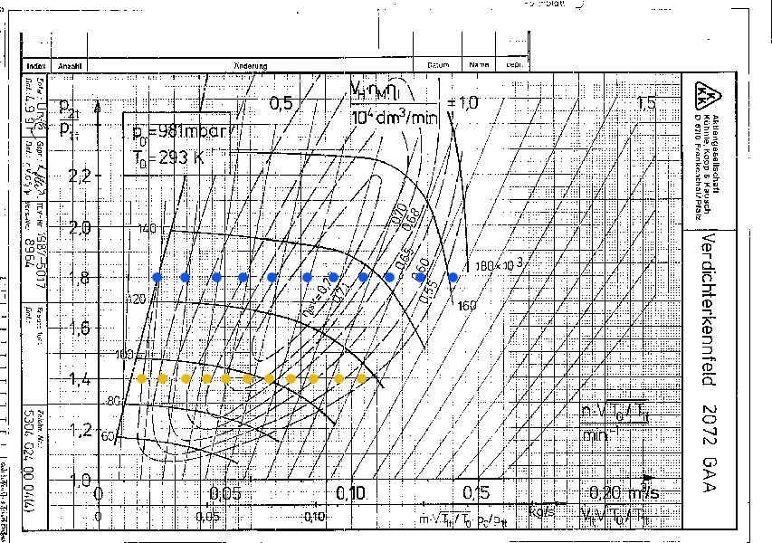

Looked up the compressor map for the K03 and overlaid flow calculations at my current 5psi (yellow) and at 12psi (blue). At my current boost, I'm missing the most efficient part of the map.
I wonder if I could be inducing extra heat in the intake charge because I'm not in the best area. Could this setup run better on more boost? (IMG:style_emoticons/default/confused24.gif)

You need to know your actual air temp. I'm sure you're leaving hp on the table. GM sensors are cheap and pretty accurate.
You also may have too much heat soak in the intercooler to be effective. Do you have pics of the mounting?
Air to water intercoolers are 7X more efficient. Maybe you could incorporate one into your system. I have an extra pump I'll give you if you go that route.
