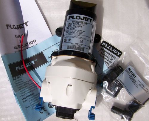

I got a few pieces for my water injection project. I ordered a FloJet pump that works with water (fuel pumps won't work), has a run-dry safety feature and is self regulating so it only runs if the pressure drops.
I got the nozzle and pressure hose. The nozzle is sized, so I got the smallest one, and I'll go up if I need to. I hooked it all up on the bench to test and the spray is identical to a patio-mister. I learned from this test that the water keeps spraying quite awhile after the pump turns off. I was originally going to set up the system to power the pump whenever I got boost pressure. But after this test I'm going to order a solenoid valve and keep the pump powered 'full time' and just open the valve under boost. This is where the pressure shutoff on the pump comes in handy. (IMG:style_emoticons/default/wink.gif)

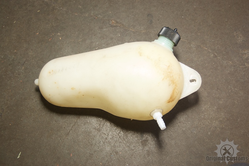

I'm going to run the pump up in the front trunk, just sitting loosely for now. Since the turbo motor isn't going to be in this car permanently I don't want to drill any holes. I also decided to use the washer bottle as my water/meth reservoir. It wasn't doing anything anyway. (IMG:style_emoticons/default/laugh.gif) I drilled the bottom so I could screw a 1/4" hose barb into the bottom and drilled the cap (it's sealed on a 914/4) to allow air in.
I still need to order the solenoid valve and build the nozzle mount then do all the wiring.
