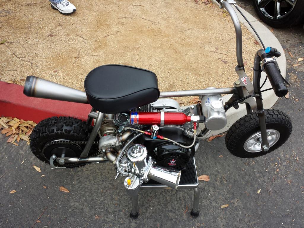

QUOTE(kg6dxn @ Jul 17 2013, 06:02 PM) *
You should be able to get 25psi out of that K03... (IMG:style_emoticons/default/happy11.gif)
Or you can use a turbo like this..
