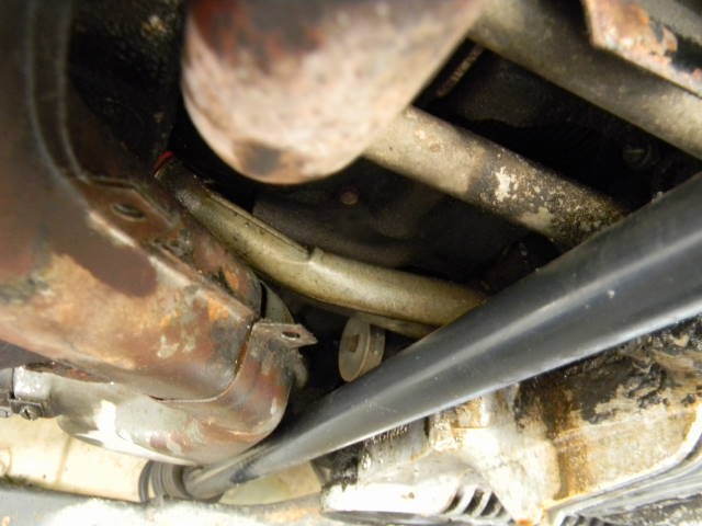

On close inspection, this is what I found in the photo below. #2 INTAKE pushrod is bent. Any idea what might have caused this situation? I pulled the engine this
evening, and will start pulling it apart tomorrow. Curious as to what I might find...

Wow, never seen that. I'm REAL curious to know what you find.

I tore down an old 1.7 where a couple of the valves had completly seized in their guides after sitting a long time. Guessing valve seized for whatever reason (crud or dropped seat maybe) or the pushrod sliped out of the rocker and jamed.

Pulled the head, and it was the valves that were seized in the guides. The damaged looks to be contained to the push rod. Probably the thing bent when it was turning over prior to starting. When it started on 3 cylinders, that is when the
noise really kicked in, and the extra force bent it to the point that it cased the cam follower to press up against the cam to the point it would no longer turn over. Once everything was off, everything spins like it should.
Took the head to the shop, and we took them apart. Had to drive the valves out with lots of force. Hopefully by the end of the week, everything will be rebuilt, and with a new top end on the motor, we should be back in business! New set of rings as well.
Thanks to everyone for your comments. It is always an experience to find out what happens with these cars. Based on what I saw, it looks like the previous owner ran it for too long with a bad thermostat, and the MPS was also on its way out. The extra moisture, combined with the extra carbon from running rich, was probably a huge part of the problem.

Check the condition of the cam lobe and lifter.
I had an engine with a valve/spring problem that kept the valves from opening as far as the cam was trying to open them and it wiped out my cam & lifters.
With the push rod as bent as that, the cam was trying hard to open that valve.
Jim
