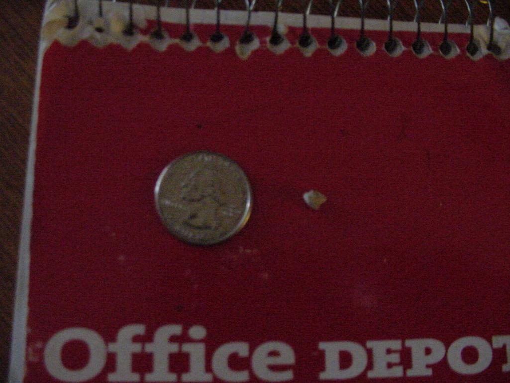

rhodyguy   took the top off. big goober of debris was lying o...   Jun 9 2013, 05:41 PM

rhodyguy   a portion of the crap that was in the bowl. was ab...   Jun 9 2013, 06:11 PM
sixnotfour   Carb Stone, It wont pass though..   Jun 9 2013, 06:29 PM
