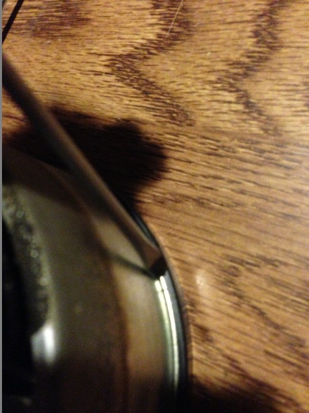

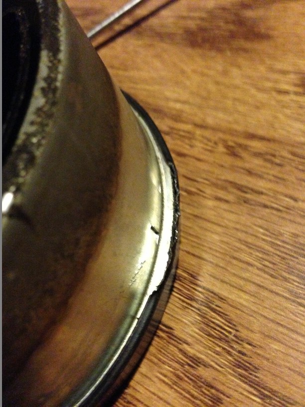

1st step, remove the combo/speedometer/tach from your car. Alrighty, easy enough.

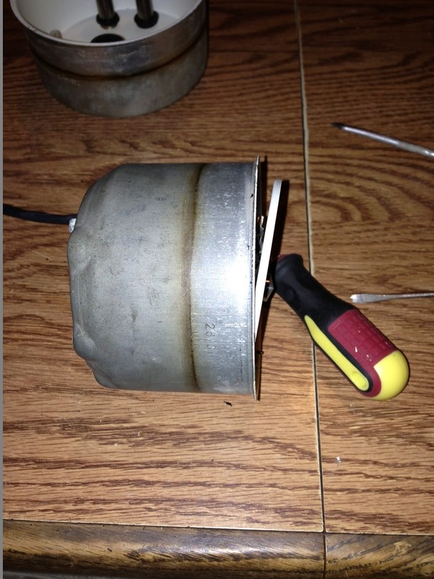

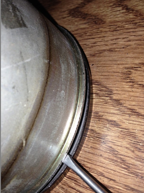

2nd step, drink a beer or two. This is somewhat unnerving and for the few it may turn you off. However, this isn't all that bad. We need to remove the bezel trim rings. I'm sure there is a machine out there that cost 15k, that will do this in about 10 seconds but we will use a small screwdriver. The first time I did this (my gauges) it took around 40 mins each, and I had a good size blister on my index finger. You will get a feeling that you are absolutely ruining these rings, but your not. Wedge the screw driver in between the bezel and the gauge can. Once your in, lightly twist back and forth the screw drive in situ pushing in a forward direction. By the time you get to the third gauge, you'll be a pro! I also found that it is unnecessary to uncrimp the entire circumference of the bezel ring. Once you get 3/4 around, the last 1/4 will pop off.

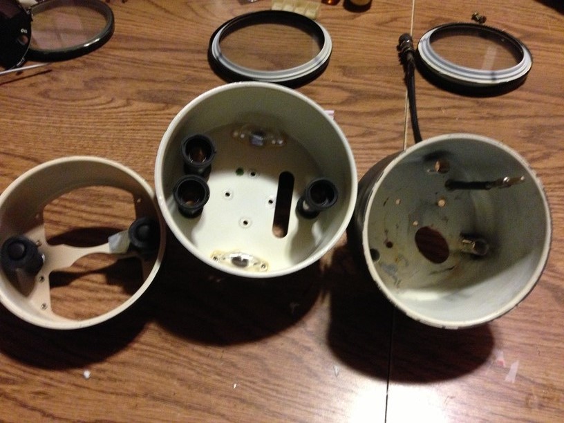

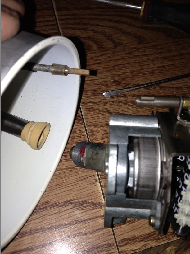

Now that these ring are off, go ahead and remove the insides. The tach will have 4 brass screws and the odometer will have 2. The combo gauge will have either 4 or 8 screws depending on the year.

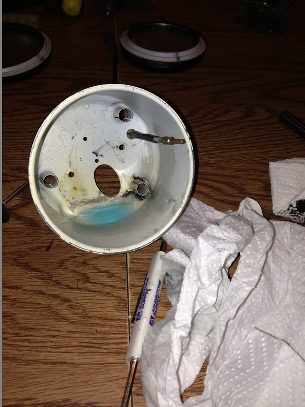

Now that the inner guts have been removed, you should have 3 empty cans like this
We will need to clean the inside of these cans, for the best adhesion of the LED lights in a future step. I didn't use anything special, good old windex spray should suffice.

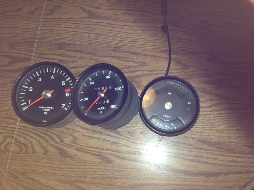

Step 2 made me forget to take pictures of reassembly, for that I apologize. After these LED strips are installed, go ahead and reassemble each gauge. You will need to hook in the bezel ring (the small area that you didn't uncrimp) and pop in the rest. With your screw driver, carefully push down and re-crimp the bezel to the gauge can. This step is pretty straight forward.
This is what it should look like after reassembly. Notice the pretty color on the needles

Here is the finished product. The camera made the pictures turn out abit blueish, however in person they look great and bright white. Using the car's stock rheostat, you can dim these down to a point, before they quit and go dark. Surprisingly they do dim down quite a bit. No need to add a PWM controller.
Hopefully you guys aren't intimidated with this project. The results will give you instant gratification. (IMG:style_emoticons/default/beerchug.gif)
