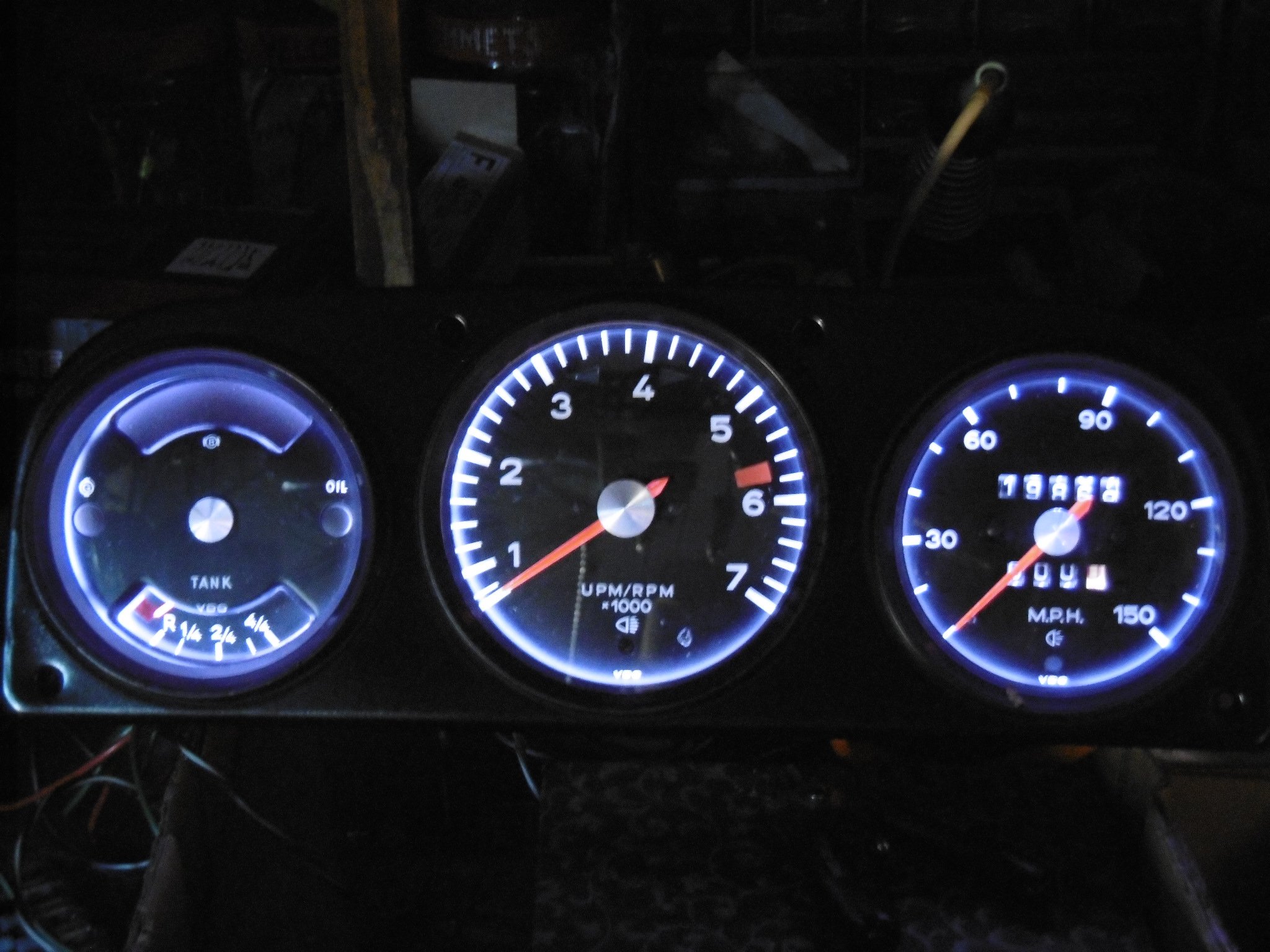

... and almost 2 years since Tim upgraded a set of gauges for me (the ones you saw him modify in this very thread), I finally installed them into a panel and applied power to them. These gauges are actually for my wife's '71, but I thought I'd try them out in the 'BB' until her car is ready for them (IMG:style_emoticons/default/happy11.gif)
These are sitting on my work bench right now and illuminated with 14 volts from a DC power supply.
They shut off at approx 9 volts and at 10~11 volts, they're very pleasant to look at, so I'll adjust the dimmer control to achieve that illumination setting after they're installed in the car.
Thanks again, Tim (IMG:style_emoticons/default/beerchug.gif) ... I'll finally be able to see these at night (IMG:style_emoticons/default/smile.gif)
