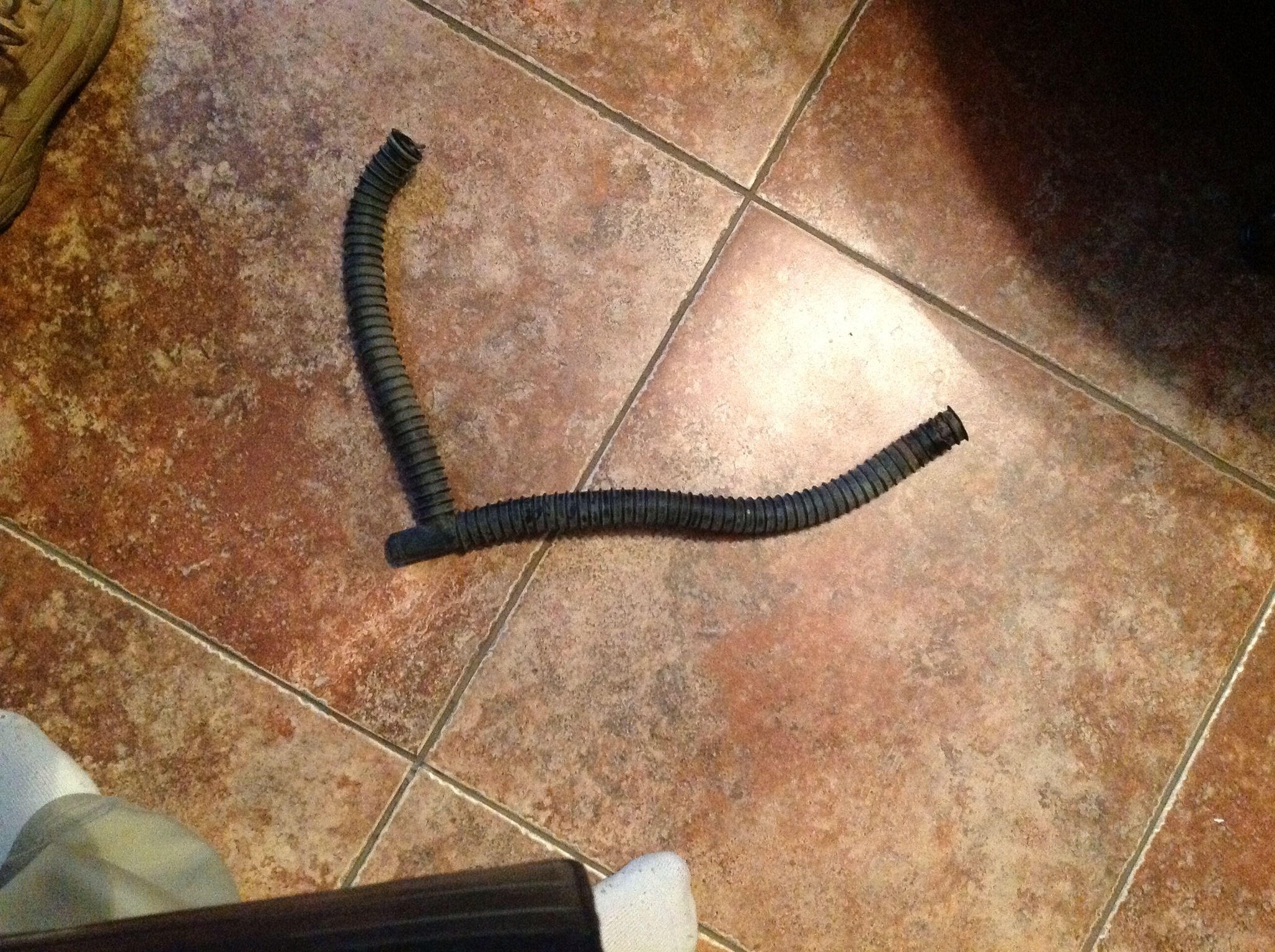

Put the gas tank back and only had this hose left, don't know where it goes.

QUOTE(martinef1963 @ Jun 11 2013, 08:22 PM) *
Water drain hoses.
Steve

It's the drain hose for the fresh air fan.

Fresh air box drain hose. If you want it back in,
You'll have to remove the tank again, I think. Never tried
to do it with the tank in.

QUOTE(The Cabinetmaker @ Jun 11 2013, 05:27 PM) *
I just tried a couple weeks ago and it will not fit if the tank is in, no matter how hard you try to force it.
