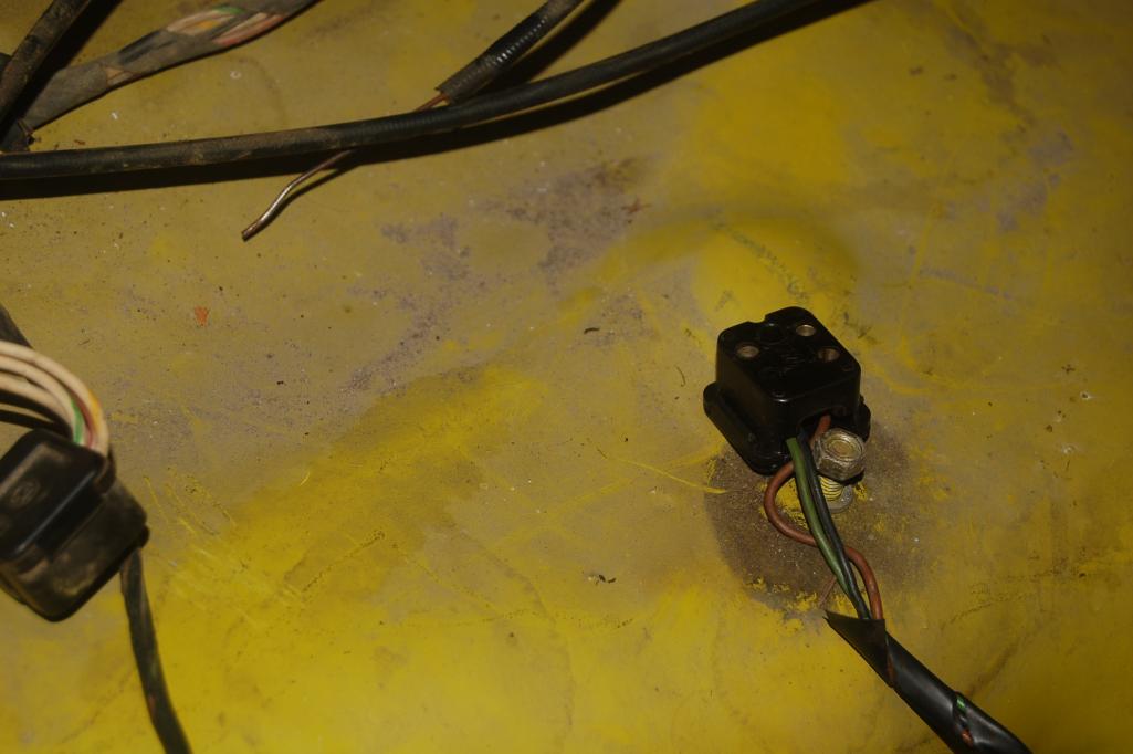

> Electric Connector - what does it go to?
lsintampa
post Jun 13 2013, 11:37 AM
Posts: 520
Joined: 28-January 13
From: Tampa, FL
Member No.: 15,441
75 914/4 2.0 CA car
See photo below.
Car did have A/C so I don't know if this connected to something to the A/C or something else.
Wire colors are green, brown, and either black or blue (hard to tell which)
I'm putting in an electric pump for the windshield washer. Found the brown/black wire (cut), and no relay for the interm wipers. SOP for this project.
Thanks,
Len
PS - the connector way to the left is for the blower motor assm. I don't see where it has but one connector. So the other connector (with three wires) remains a mystery.
Would not be totally shocked if I'm missing something, but it would be nice to know
bulitt
post Jun 13 2013, 11:44 AM
Achtzylinder
Posts: 4,189
Joined: 2-October 11
Member No.: 13,632
Fuel level sender.
Bowlsby.net or pelican parts have great diagrams.

QUOTE(bulitt @ Jun 13 2013, 01:44 PM) *
Fuel level sender?
(IMG:style_emoticons/default/pray.gif)
thanks....
just looked at the sending unit for the fuel tank - duh (on me).
My BMW only had one wire and a ground. Didn't expect that.
toolguy
post Jun 13 2013, 01:00 PM
Posts: 1,276
Joined: 2-April 11
From: San Diego / El Cajon
Member No.: 12,889
Brown is ground, the others are for fuel level gauge and the low fuel warning light
