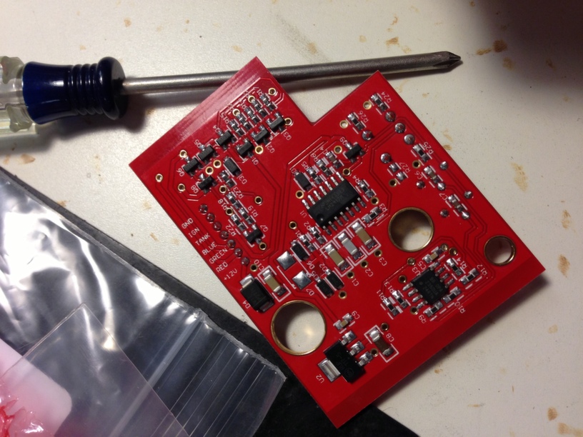

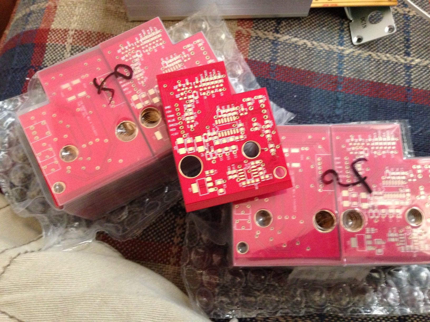

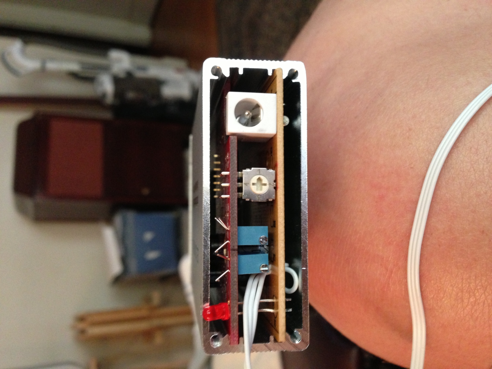

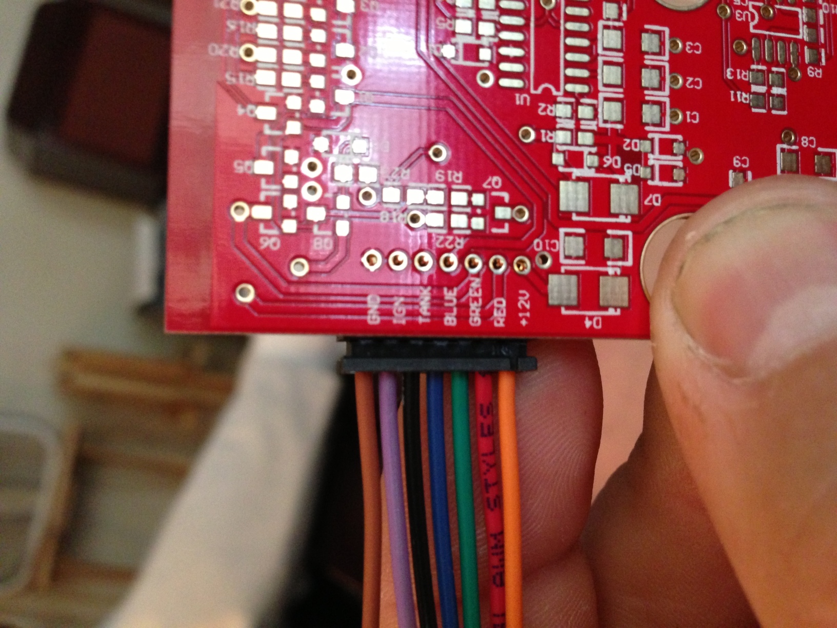

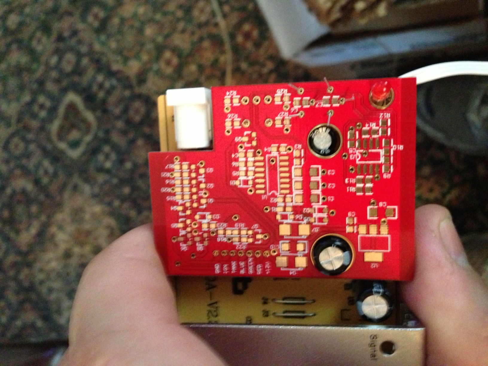

Some progress today, the circuit boards have arrived!
Our new board was designed to sit ontop the Chinese RGB controller circuit board and fit within the aluminum housing
The wires will all be internal, except for the tank empty wire and tach, this will make for a very clean install

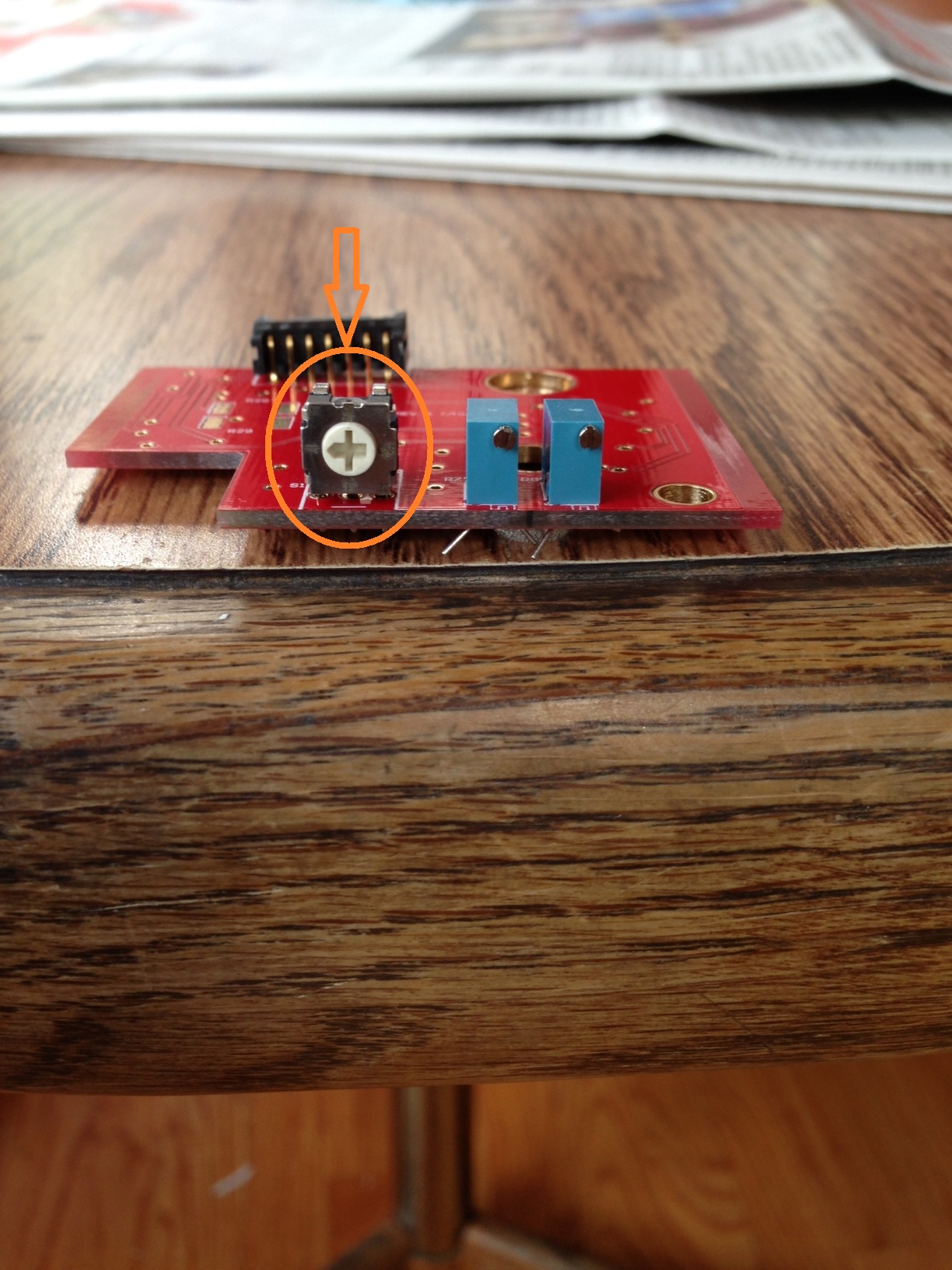

The business end. This is where you can adjust the RPM yellow or red indication lights or turn them off. The rotary switch is for 4, 6, 8 or 12 cylinder engines.
Exciting stuff, within a few days I'll have the first circuit all soldered up (IMG:style_emoticons/default/welder.gif) When this is done and the proof of concept does indeed work, I'll post a video of these gauges in action.

Got the prototype circuit board soldered up today. So far so good, it functions as designed on paper. Hopefully I will have this installed in my 914 tomorrow! (IMG:style_emoticons/default/piratenanner.gif)
I think when I get everything situated, I'll accept paypal to help streamline the whole process.
