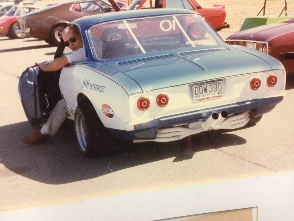

some Corvair humor.. 42 yrs ago
me 16yrs old ..first set of radial tires ..used of course, and my Dad

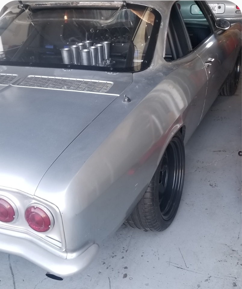

Friend of ours restoring this one, features a smallblock Chev with a period correct Crown conversion kit. I dig the velocity stacks in the back seat (IMG:style_emoticons/default/aktion035.gif) Attached Image

Malt and Six:
Sweet rides! Those are both very pretty cars. I'm reasonably jealous.
Six- I prefer the earlier Corvairs to the later ones in terms of looks. Just really like the lines and classiness of the body. But Malt, those velocity stacks are sexy. And I like that the engine is right where it is supposed to be - amidships.

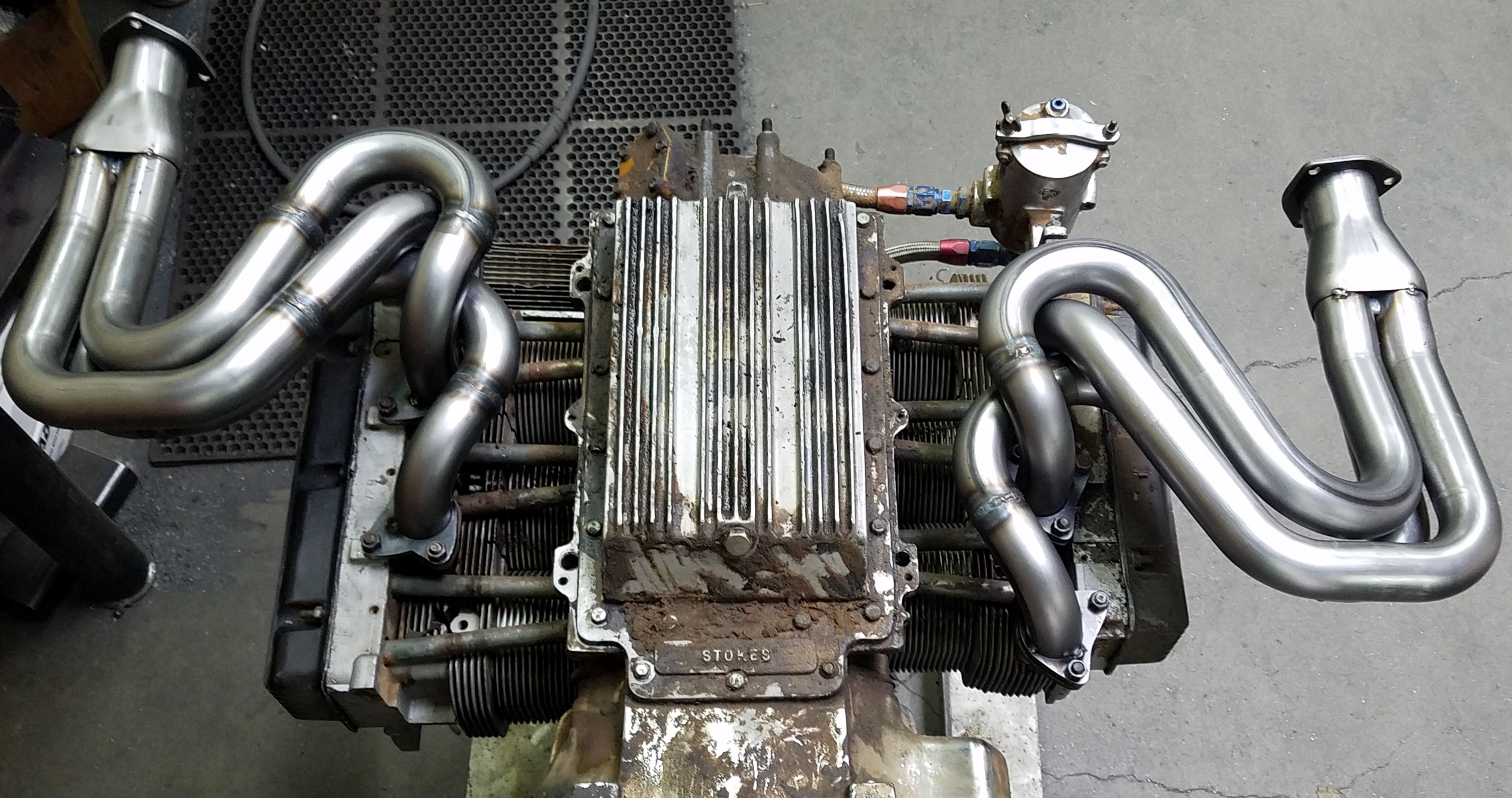

...also built this set of racing headers for the same guy, but another one of his Corvairs; this one has a hot rod 6cyl. !Attached Image

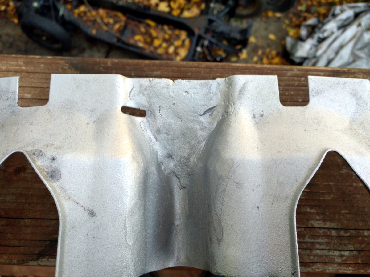

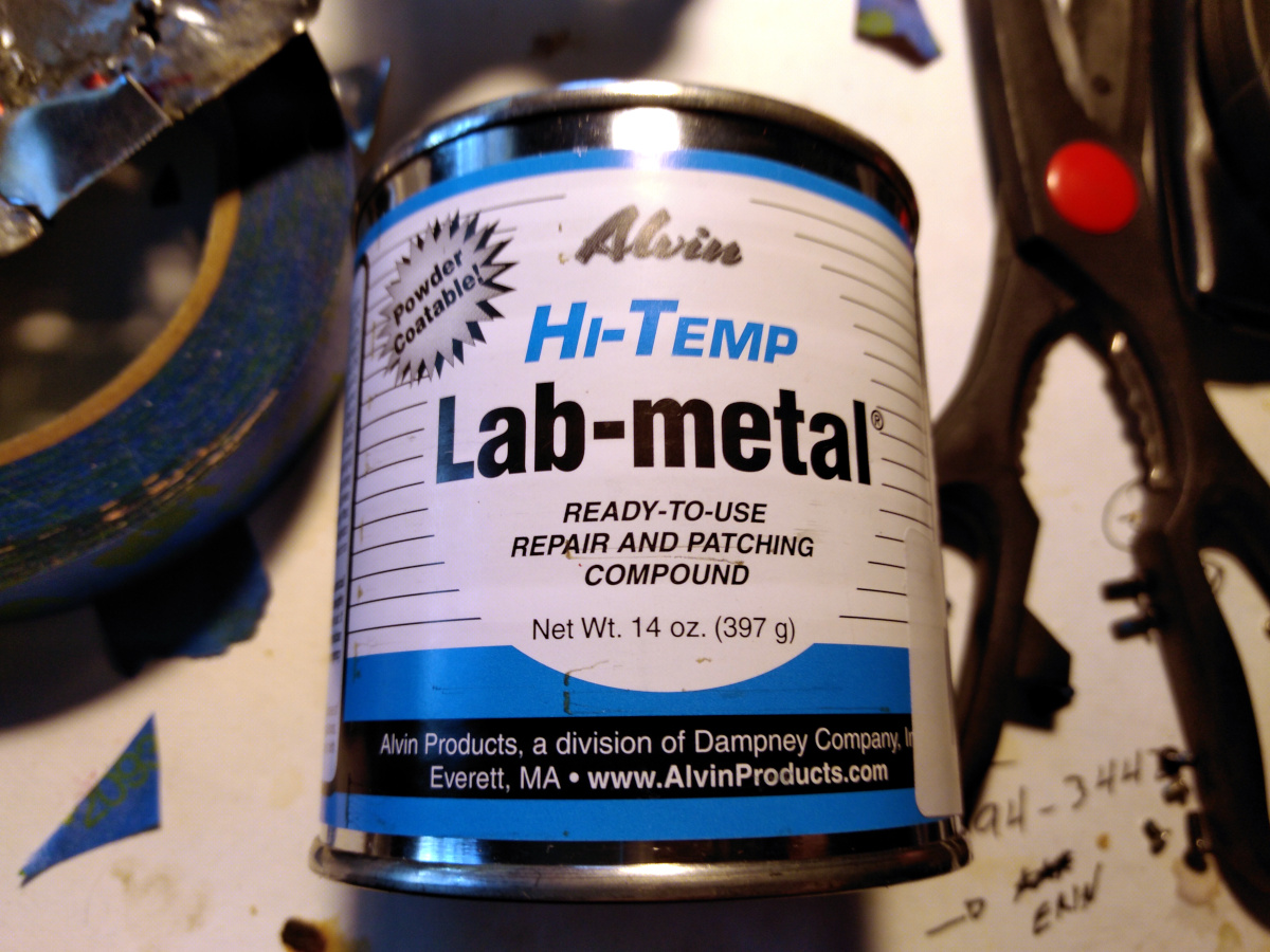

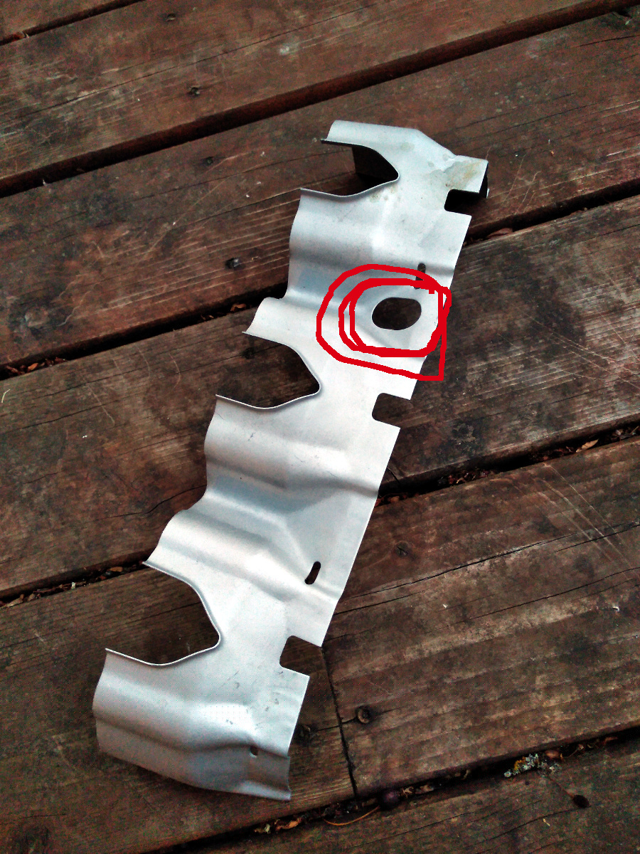

David brought up a point at exactly the right moment. The heat shields that lay underneath the cylinders are not exactly the same. There's an oval hole in one of them that here-to-fore I thought was to make way for the dipstick tube. Although I never did give it much thought at all. Then I went to install it and found that the hole is on the oppose side of the dipstick tube. Whaaaa?
The dipstick doesn't need a hole in the shield. That hole is only for '60-'62 cars that used a crankcase pressure relief tube to dump crankcase gasses underneath the car and out into the atmosphere. Nice. Starting in '63 GM started using a PCV valve instead. Long ago one could buy a plug for the hole but I'm not sure from which material it was made. I am sure that the plug is right next to the exhaust so if it were made of rubber it wouldn't last.

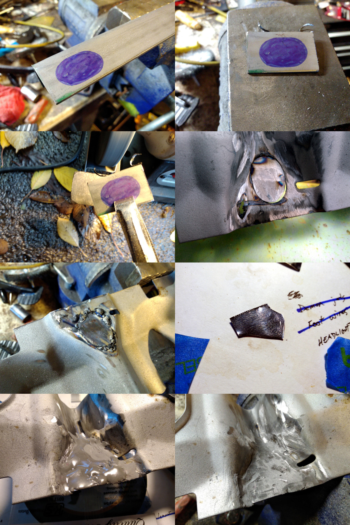

At first I was inclined to make a high-temp JB-Weld sandwich with a little bit of steel sheet. But then I decided to do a little experiment. Or rather, three at once. I wanted to see if I could weld a patch on the very thin shield sheet metal (I can't) and if such a patch could be powder coated on an otherwise already coated part. Long ago I coated the heat shields in high temp silver exhaust powder. I've never re-coated a piece, so why not? I also want to try out using Alvin's Hi-Temp Lab Metal. It's a high metal content putty that's supposed to withstand high temperature and is able to be powder coated.
Here's a little montage of the process. I cut a little oval patch and tried and failed to weld it in, but just burned right though the shield. I should have known but did it anyway. Then I had to cut another little patch and then puttied it all into place with the Lab Metal. After sitting for 24 hours the instructions say to bake it at 425F, which is exactly the powder coating temperature. I powder coated it with the same powder and baked it.
It looks terrible and I blame myself for the shoddy work. But the experiment was a a reasonable success. While being the opposite of pretty, the patch is strong and good to at least 450F (Alvin says a 1000F). The powder doesn't look great but it did the job. My plan, in its entirety, is to install and let someone else check the results at the next disassembly.
Here's the final product. It's PERFECT.

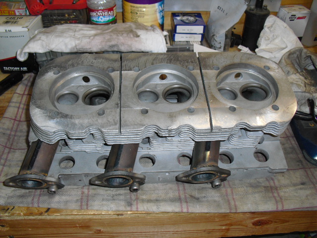

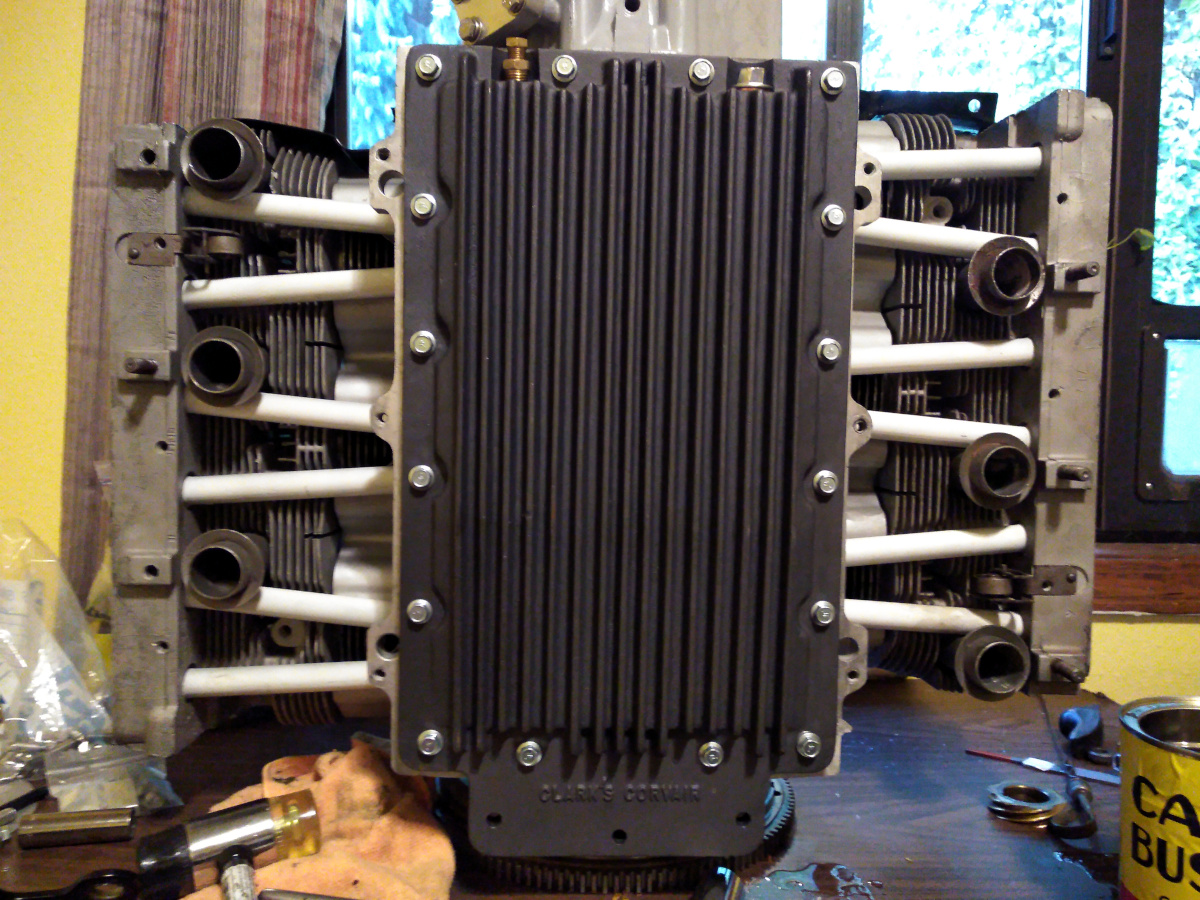

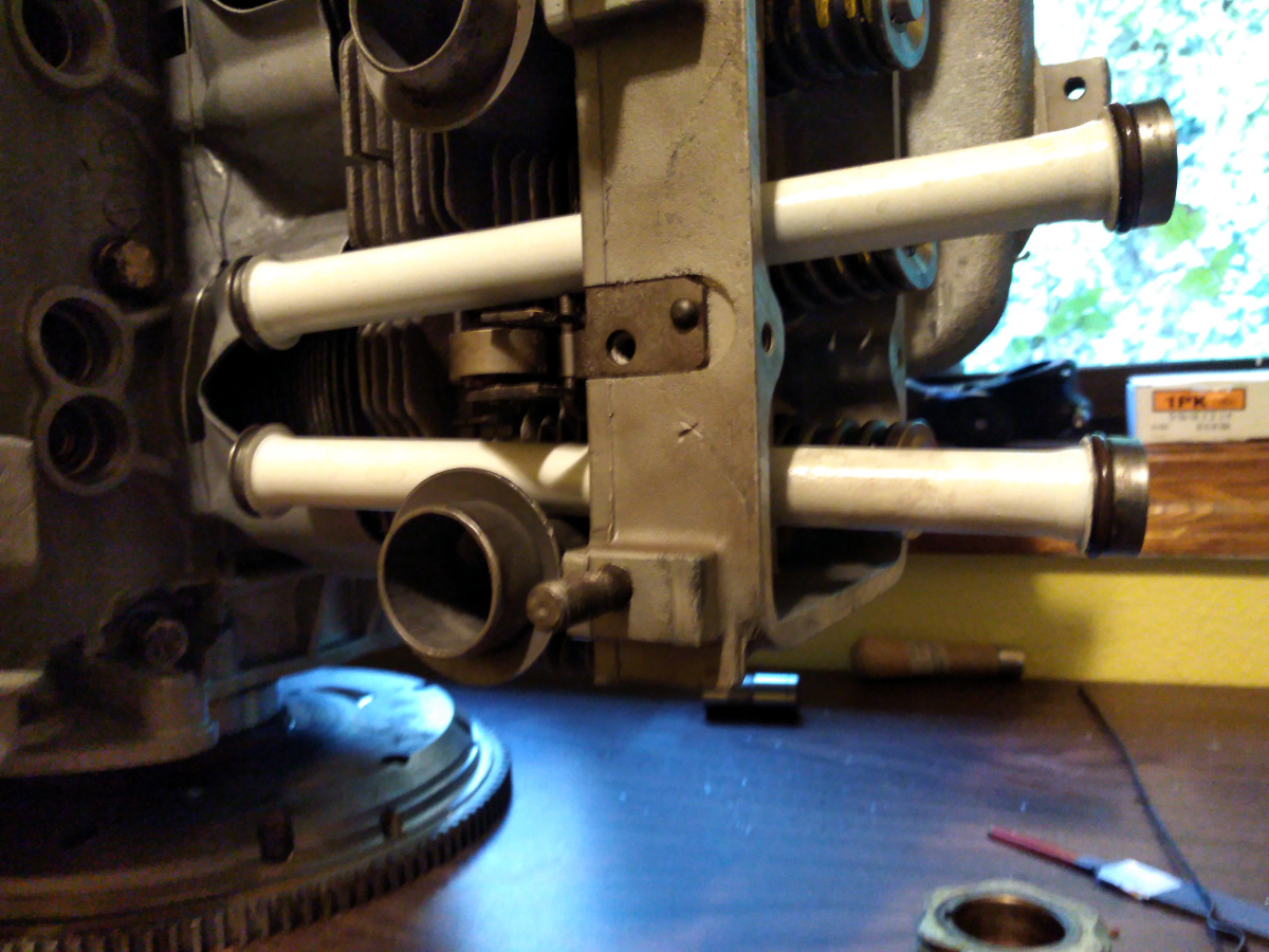

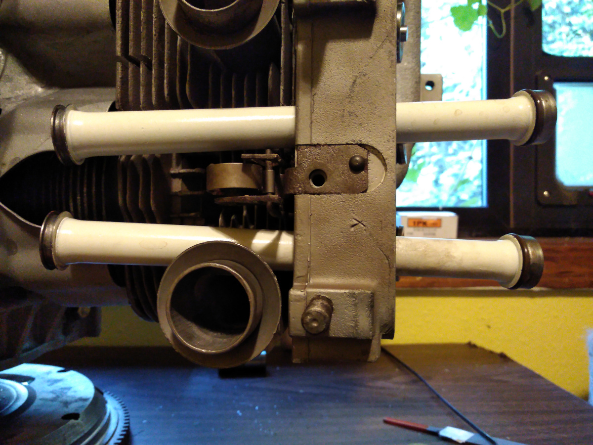

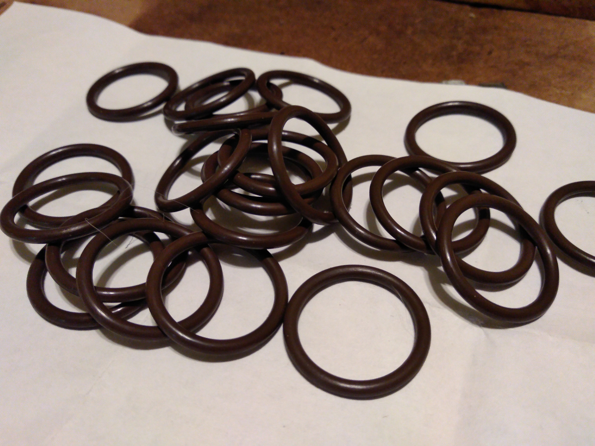

Right. Let's install the pushrod tubes.
A while back I made a little jig to prep the tubes. I coated the exterior in the same high temp silver powder as the heat shields and then painted them with a few coats of high temp ceramic paint in white. The ends are polished with my rotary tool to prevent damage to the seals.
The tubes get a Viton seal on each end of the tube, but the engine case side of the tube goes in through the head naked. Once through the head the seal is popped on and coated in engine oil. Then the tube can be shoved all the way in to the bore. I used a nylon hammer and a 16mm socket to drive them in all the way, as per the service manual instructions.
Note the orientation of the tube. The manual calls the case side the "long side of the tube." Odd way to describe one end of a tube, but okay. You can see in this photo that the ends are different. The larger end goes into the head.
Here are all twelve installed:

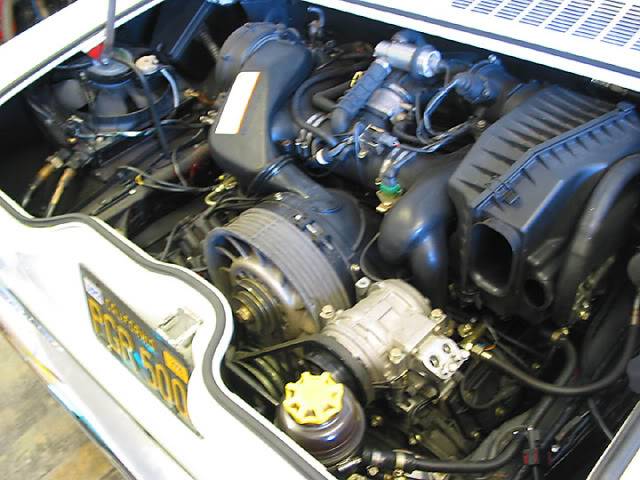

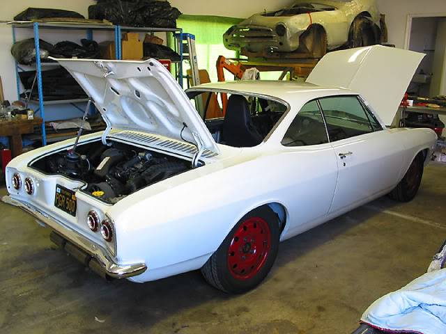

This guy might have a corvair engine for sale. All Porsche 993 awd running gear and interior in this Corvair

QUOTE(BIGKAT_83 @ Jan 15 2019, 02:35 PM) *
That's pretty sweet. I would like to have witnessed that project. I'm a huge fan of the unholy.
This guy might have a corvair engine for sale. All Porsche 993 awd running gear and interior in this Corvair ...
That Corvair is schweet, but I'd like to know what that project is on the rack? (IMG:style_emoticons/default/blink.gif)
