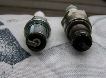

Should I be worried? Here is a picture of the two plugs out of #1. The Bosch is on the right and the NGK is on the left. Granted the Bosch is old but it doesn't look as bad as the picture. It has dark grey electrodes and some soot at the outer ring. It was in the car when I converted to the Megasquirt ECU and saw some rich mixtures averaging around 12.5/1.
The NGK is certainly seeing leaner conditions with the system now running in closed loop correcting to 13.8/1 for a target AFR.
Thanks,
Dave

I'm surprised by the difference in the size of the plug north of the threads. The NGK is much smaller (skinnier) than the Bosch.
Does that affect performance?

That's kind of misleading. Everything looks the same to me except the size of the hex on the Bosch is 13/16 and the NGK is 5/8. Also, the NGK sports a v groove in the electrode which they have all over their box. Gimmick?
Dave

The NGK looks lean to me. The V groove works.. not sure what we gain.. but we tested some AC Delco's with the groove and they showed better flame propagation than a non grooved plug.
Hum.. the Bosch is/was toast. I'm surprised it ran on all 4 cyl's.

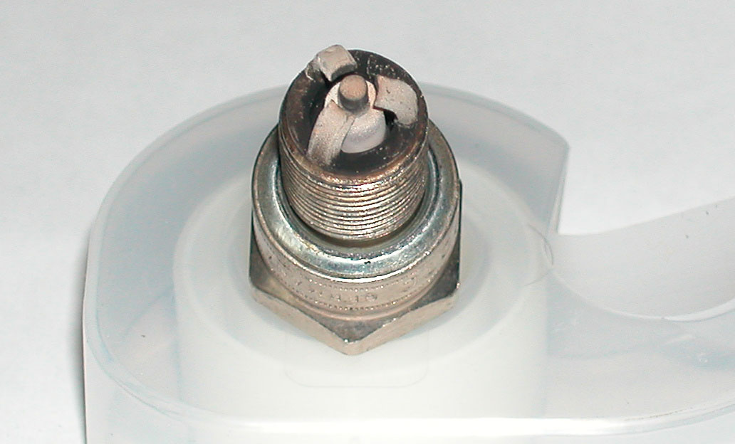

How about this one, Brad?
Geoff

That was so I could take a picture of it ya nitwit! Atleast I don't have my effin' shoes in the picture!
Geoff

It looks pretty damn good to me. A tad lean.. but no reason to change anything. What I dont want to see: WHITE. Tan with a light grey = good.

what spark kind of plug is that in the picture? Looks like the one I use in my VW Golf 1.8i, the Bosch N7BYC, and NOT a 914 (type 4 engine) plug.
Please tell me if such a multiple electrode plug can be used in a 914 (with standard ignition). Why else did you show the picture?
The spark is directed differently with such a multiple electrode plug, so combustion is more uniform. On the other hand, it would not surprise me if this only works with electronic spark units (MSD or whatever).
Anton
