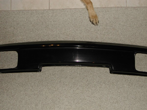

How about pics of dog paws?

You need a dog to hold your camera? (IMG:style_emoticons/default/tongue.gif)

Yes... only my German Shepherd can photograph my Porsche parts!
Why?... doesn't everyone have a picture-taking dog?

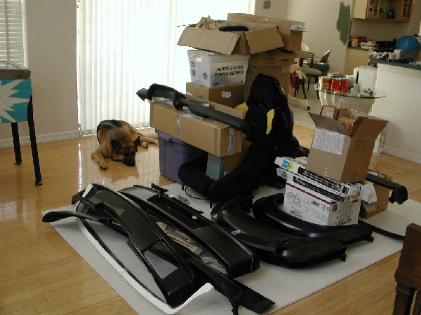

Here he is protecting the "stash" of parts...

Nice dog. Nice stash of parts too with the GT flares and other goodies.
I can see the dog has assumed the typical stable photographer's position so that the camera doesn't move... LOL
