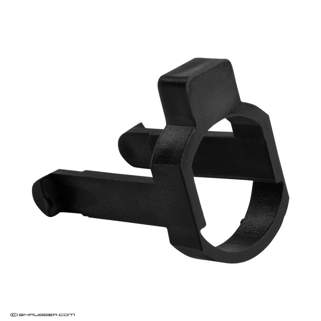

Are they available through 914rubber.com too?
Don't know if this is it because there is no picture.
http://shop.914rubber.com/door-cam-actuator-914DCA.htm
Yes,
I'll add the picture.
-Mark

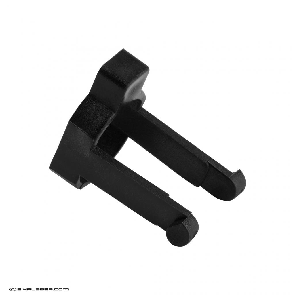

Mark,
The one I posted a picture of did not have a lot of strength in the "two legs". From a compression perspective (I guess compression is the right term) the "legs" will need to be pretty stiff or they will deform like the one I have shown in the picture. How stiff are the "legs" on the ones you sell?
Bronze may be overkill; however, at least you won't have many worries about the "legs" deforming under pressure. You may break the tabs off the door handle but your cam won't break! (IMG:style_emoticons/default/smile.gif)
Plastic is what the factory used, and will work ok as long as you don't deform it trying to put it on. that's what the notches are in the plastic.
-Mark

AA has replacement nylon cams.
Bronze cams were made at some point and I would like to have tried those. I couldn't find those.
The cams are made of plastic to be the part that breaks first. Bronze ones will apply more force to all the other parts of the door handle parts possible leading to the tab with the stud breaking.

QUOTE(macmike83151@yahoo.com @ Nov 25 2019, 11:32 AM) *
Hello there,
Are there any tips or tricks to getting the new cam on the door handle?
Note we made the cam with a cut out so that when the flap is lifted up you can slide it into place. Once assembled it will not come off.
Others have noted the nylon is soft and easily bendable. The part is intended to bend prior to placing stress on the flap. It is intended to operate with little friction, so if there is crud clean it and lubricate it. I prefer a dab of lithium grease. The release inside the door mechanism should not take much pressure to disengage. You may want to clean can lubricate it too. A little cleaning goes a long way here.
