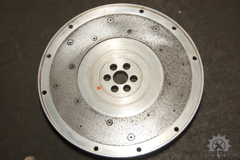

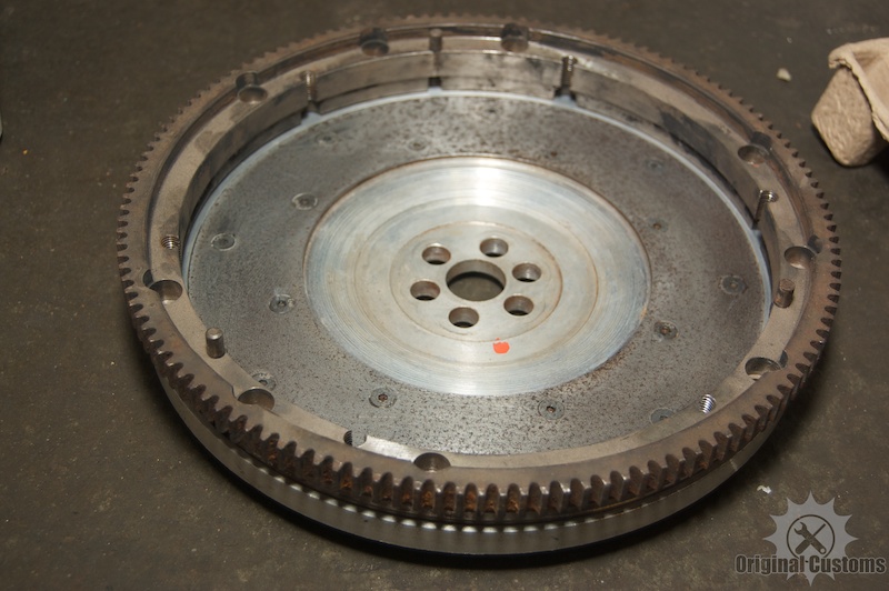

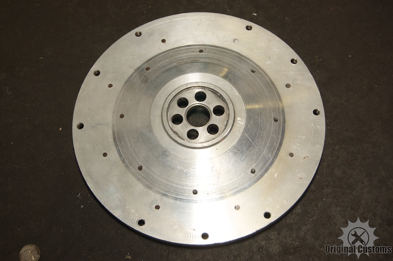

I picked up this 2.4 six awhile back and I'm gonna use this thread as I develop the engine which will eventually go in my gold car.
I'm starting a little out of order, but too bad. (IMG:style_emoticons/default/tongue.gif)
So I have this aluminum flywheel. No manufacturer stamps or numbers on it whatsoever. I'm thinking that it might be too light for a street car, so I may not use it. It's about 3lbs by itself. I've got a 914 clutch adapter (basically a cut down 914/4 flywheel that bolts to the outer edge) and that brings the total flywheel weight to about 10lbs.
I want a streetable car, is this thing too light?

Try it...

I have a lightened Patrick Motorsports flywheel on a 2.4 that I'm building. Its not aluminum and weighs 7.00 lbs. If yours is not less than 5 lbs, it should be fine, depending on cams.
I'm using e cams based on Dempseys book.
I am, by far, no expert tho. (IMG:style_emoticons/default/biggrin.gif)

your right at a stock 2.0 6 cylinder flywheel weight.. do you have an aluminum pressure plate the would be great, unless its for a LIMO, Then get a cast iron anchor..

I've had a 6.75lb Patrick Motorsports aluminum flywheel and a push-type clutch on this 993 engine since 1999. No problems. Clutch/pressure plate/flywheel assembly weighs in at about 18#.
Good luck

My daily driver 914 turned cafe racer AX weekend warrior turned semi-daily driver has a lightened flywheel. It's 12 lbs I recall, behind a stock 1.7 TIV. When the engine is cold, it dies more often than it should. When warm, usually no problem. If you rev up in neutral, the drop back down can sometimes cause the engine to die. It just doesn't have that rotating mass to keep it smooth. I am really good at re-starting the engine no matter where/what. I like that my 914 is so sensitive to driver inputs w the light flywheel, turbo tie rods etc etc (IMG:style_emoticons/default/biggrin.gif)
Go for it (IMG:style_emoticons/default/beerchug.gif)

Figure that the heavy outer starter ring is at the perimeter, I think this should work fine. Just don't put a 'puck' type clutch disc in the car if it's going to be a street driven car!

Cool. Sounds like this flywheel will be fine. I can always swap it out later if need be.
