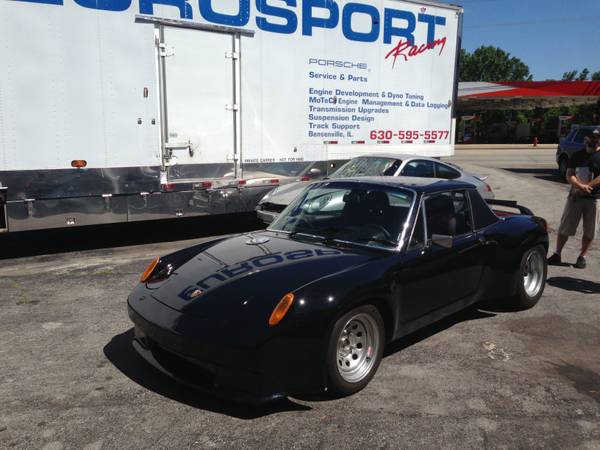

Im looking to buy a second car and saw a beautiful porsche at a car show the other week. I talked to the owner and discovered the 914, which I never saw before. Ive been searching craigslist and found this. He doesnt have a asking price, just BO. I havent got a clue about 914s and their value so what do you reckon this is worth? Heres the description
You looking at a 74 Porsche 914 dual webers 40mm 1.7 engine.
Aroung 74000 miles and running strong
Over $10,000 invested.
Wide body kit.
Upgraded suspension (bilstein) disk brakes with wide wheels.
make me an offer.. thanks for looking

kg6dxn   Depending on the underlying rust, $500-...   Jul 20 2013, 12:02 PM
euro911   It's hard to determine on the internet. Best t...   Jul 20 2013, 12:02 PM
Hine62   $10000 invested in what? It could easily cost...   Jul 20 2013, 12:27 PM

chadf7   He said there "are no bad rust areas like oth...   Jul 20 2013, 12:47 PM
Woodside914   He said there "are no bad rust areas like ot...   Jul 20 2013, 04:51 PM
Maltese Falcon   Suspension upgrades? Disk brakes? Every 914 came f...   Jul 20 2013, 01:08 PM

walterolin   "No bad rust areas" is a big time red fl...   Jul 20 2013, 02:03 PM
type47   And another oddity. The 1.7 liter engine is a fi...   Jul 20 2013, 02:12 PM

ellisor3   If that car was raced, without additional structur...   Jul 20 2013, 03:39 PM

rick 918-S   :agree: with the others here. Check the underside...   Jul 21 2013, 10:17 PM
chadf7   I got a little more information. Here's what h...   Jul 21 2013, 11:34 PM
euro911   Sounds like the seller isn't that knowledgeabl...   Jul 22 2013, 12:11 AM
ellisor3   You will definitely want to see what is under that...   Jul 22 2013, 06:54 AM

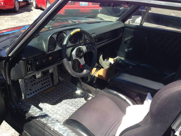

steuspeed   That diamond plate could be a cover-up. Red flag f...   Jul 22 2013, 01:32 PM
