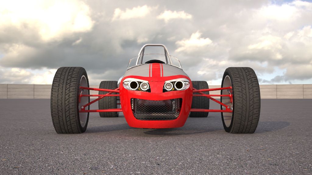

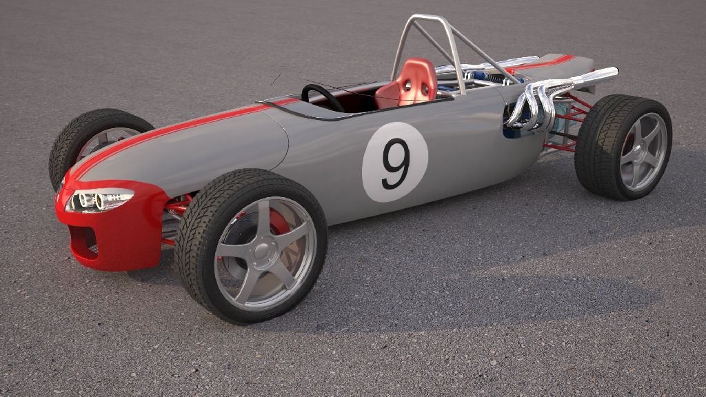

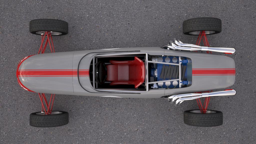

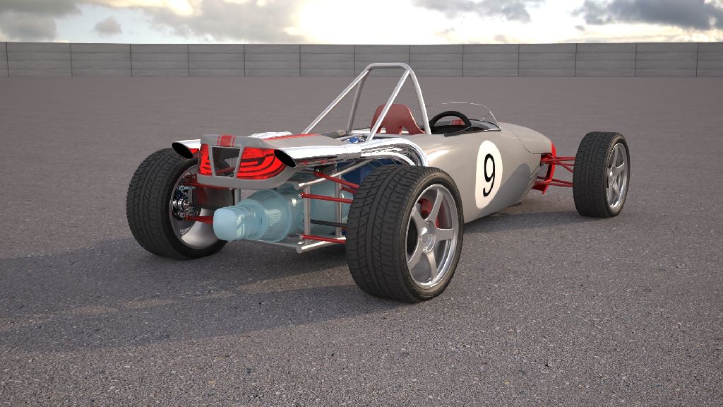

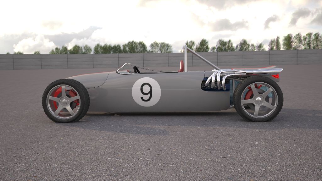

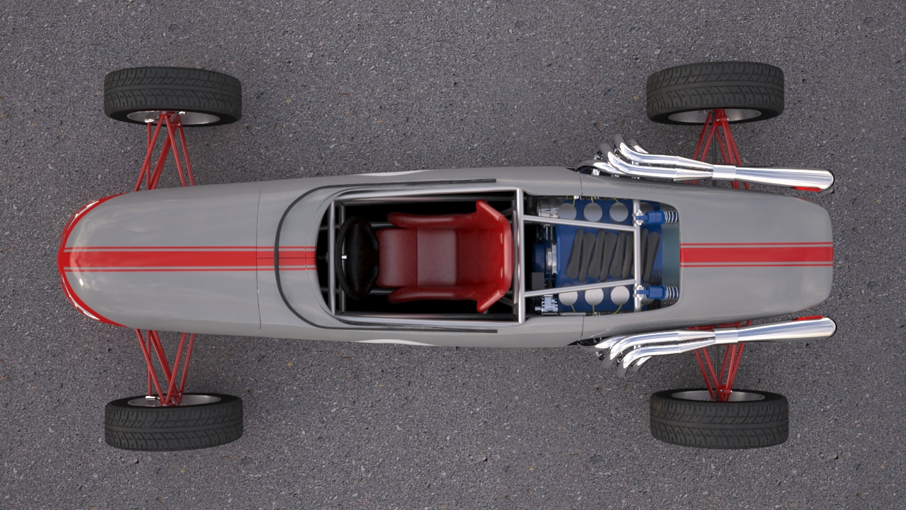

Hi all,
This thread:
http://www.914world.com/bbs2/index.php?sho...17048&st=80
has prompted me to share a project I've been thinking about for a while and now am just getting started on. I thought I'd share with you guys as we're typically like minded car guys...
I'm making plans to build a single-seat, mid-engine, street-legal sports car.
- Less than 1,600 pounds
- 600 horsepower Chevy LS7 engine (dry sump)
- Porsche G96 transmission
- Street legal, but should be a pretty amazingly track car as well.
- Several donor parts from a C6 corvette (e.g. suspension uprights)
- Can accommodate drivers up to 6'8" and size 15 shoes (impossible with other lightweight street cars (e.g. Ariel Atom, Caterham)). (I'm 6'6".)
- 105" wheel base. This is about the same as a C6 Corvette, and much larger than other lightweight cars.
- Fiberglass body styled after a "modern 1960s F1/F2 car" (e.g. Porsche 718, Brabham B19).
- Single seat, super simple. no frills. Very simple dash, no doors, no wipers, no a/c, no heat. But safer and more comfortable than a motorcycle.
The Ariel Atom, SuperLite Nemesis, Palotav DP2, Light Car Company Rocket all share some characteristics of what I have planned, but none are quite right and hit the mark for me.
What do you think? Any ideas or suggestions on what to change? Like it? Hate it?
And below are just some conceptual drawings I've put together. Nothing is "engineered" in these concept drawings.
-Steve

Bob L.   :popcorn: Love it... can't wait to see actu...   Aug 3 2013, 09:19 AM
mepstein   OMG! Love it. can you figure out a way to base...   Aug 3 2013, 09:41 AM
Cap'n Krusty   Nice! I think it has to be under 1500 lbs to ...   Aug 3 2013, 09:58 AM
7TPorsh   Conceptual drawing?....i thought it was real...exc...   Aug 3 2013, 12:13 PM
Chris H.   RE: OT: single seat sports car project   Aug 3 2013, 03:36 PM
KELTY360   :rotfl: I agree with the Cap'n (always ...   Aug 3 2013, 03:59 PM
Vacca Rabite   You can do Atom fenders or 7 fenders easy. They a...   Aug 3 2013, 03:46 PM
David J   While I know it never rains in San Diego (I grew u...   Aug 3 2013, 06:17 PM
scotty b   WOW :drooley: I've always wanted to build a...   Aug 3 2013, 06:20 PM
Dr Evil   Do it. Let us know how you legalize it. I want :) ...   Aug 3 2013, 06:57 PM
balljoint   Scotty and I are going to make a belly-tank race...   Aug 3 2013, 07:11 PM
r_towle   Scotty and I are going to make a belly-tank rac...   Aug 3 2013, 08:46 PM
siverson   Thanks for the feedback. So any criticism or ideas...   Aug 3 2013, 09:38 PM
siverson   The original is approx 235 front, 305 rear tires, ...   Aug 3 2013, 09:39 PM
r_towle   Do something to widen the headlight location. Put ...   Aug 3 2013, 09:41 PM
Andyrew   Are you going to title it as one of the 250/year ...   Aug 4 2013, 06:25 PM
Katmanken   Think you are quite a bit high on your weight. D...   Aug 4 2013, 08:45 PM

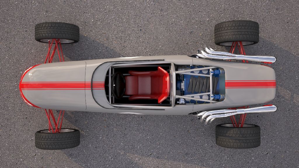

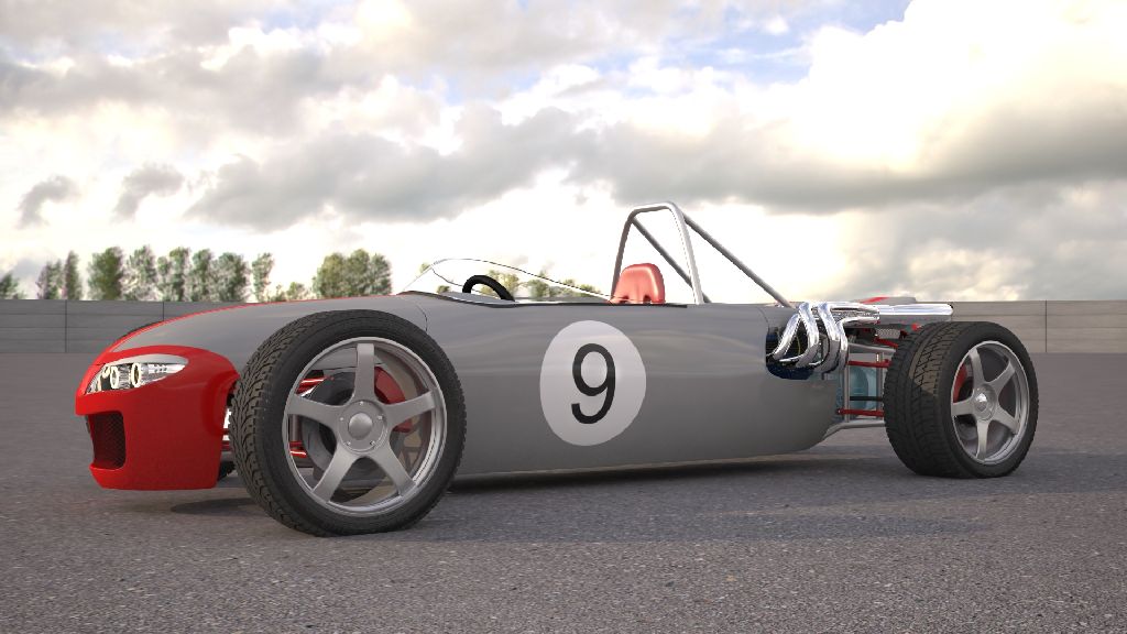

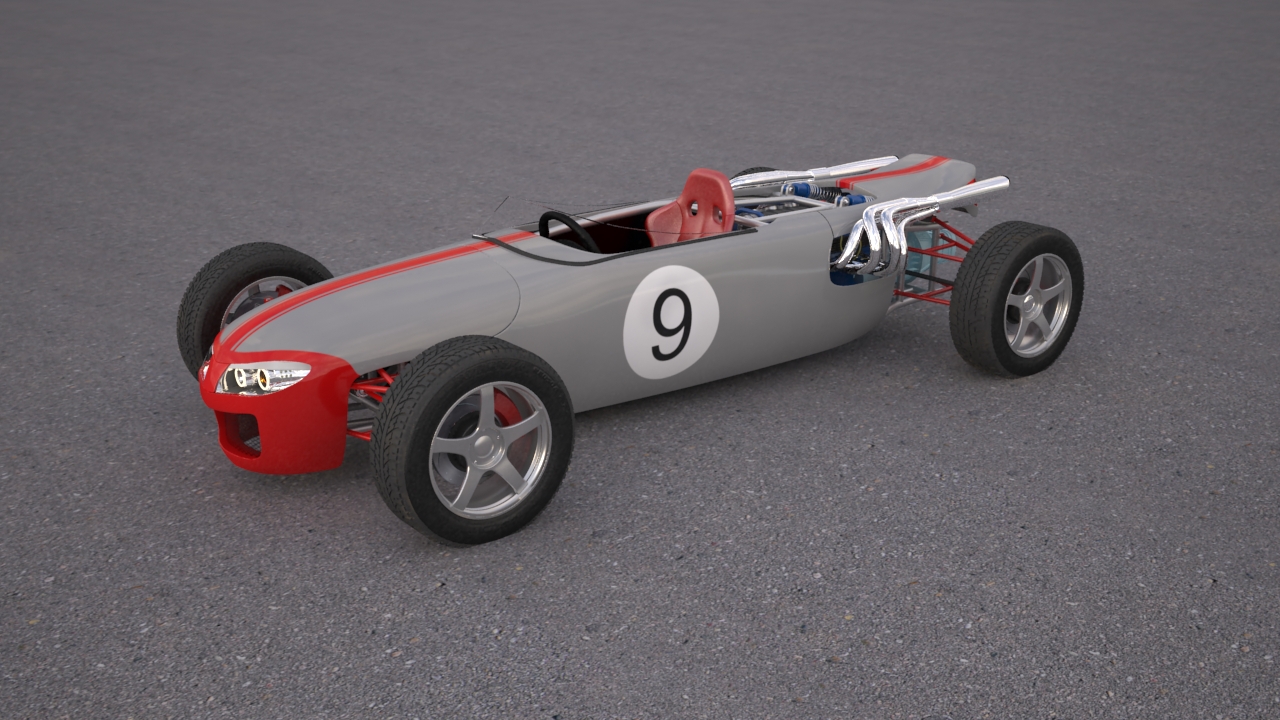

siverson   Now with fenders, mirrors, and additional headligh...   Aug 14 2013, 09:37 AM
AE354803   It might be easier to go 3 wheel design, although ...   Aug 14 2013, 09:45 AM
Andyrew   Fenders look nice! The lights there might be p...   Aug 14 2013, 10:35 AM
JamesM   <1,600 pounds, 600 horsepower, and zero downfo...   Aug 14 2013, 10:52 AM
FourBlades   Cool concept, I like it. I have thought having a ...   Aug 14 2013, 08:24 PM
rick 918-S   Why fabre glas body? Why not aluminum? I could ban...   Aug 15 2013, 06:56 AM
effutuo101   go with this motor. http://www.youtube.com/watch?...   Aug 15 2013, 08:19 AM
siverson   > minimum height requirement for headlights whi...   Aug 15 2013, 09:29 AM
monkeyboy   I'd call around to the hot rod shops and see i...   Aug 15 2013, 09:43 AM
69telecaster   Nice-looking, and recalling that it's 105...   Aug 16 2013, 07:02 AM
