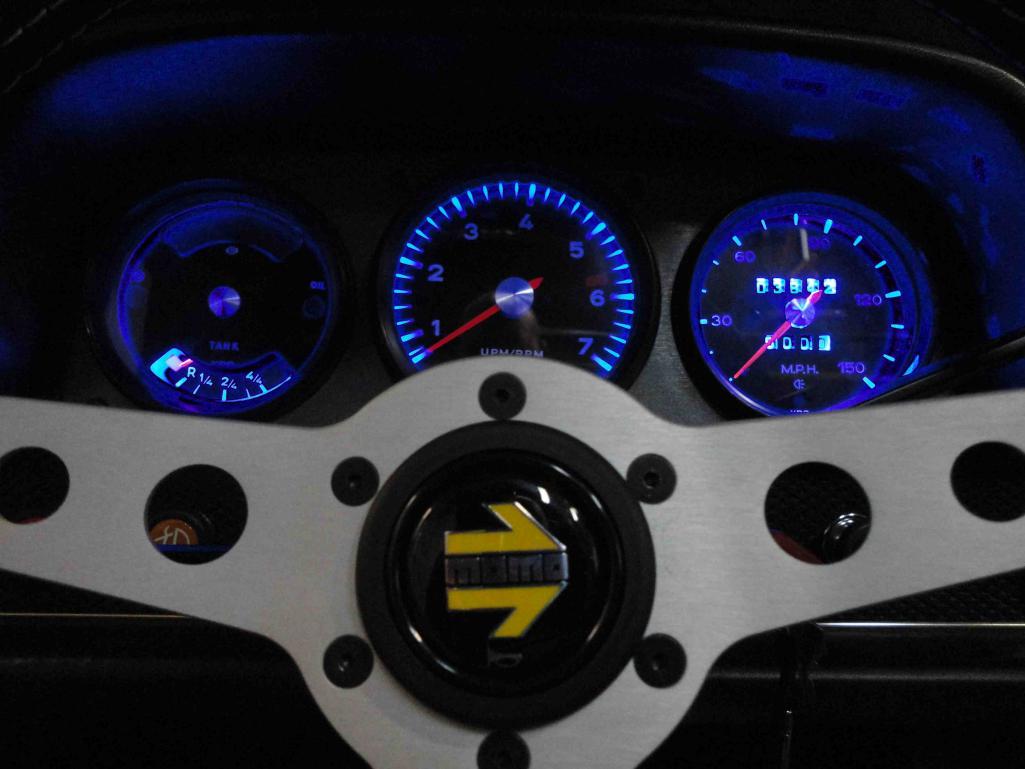

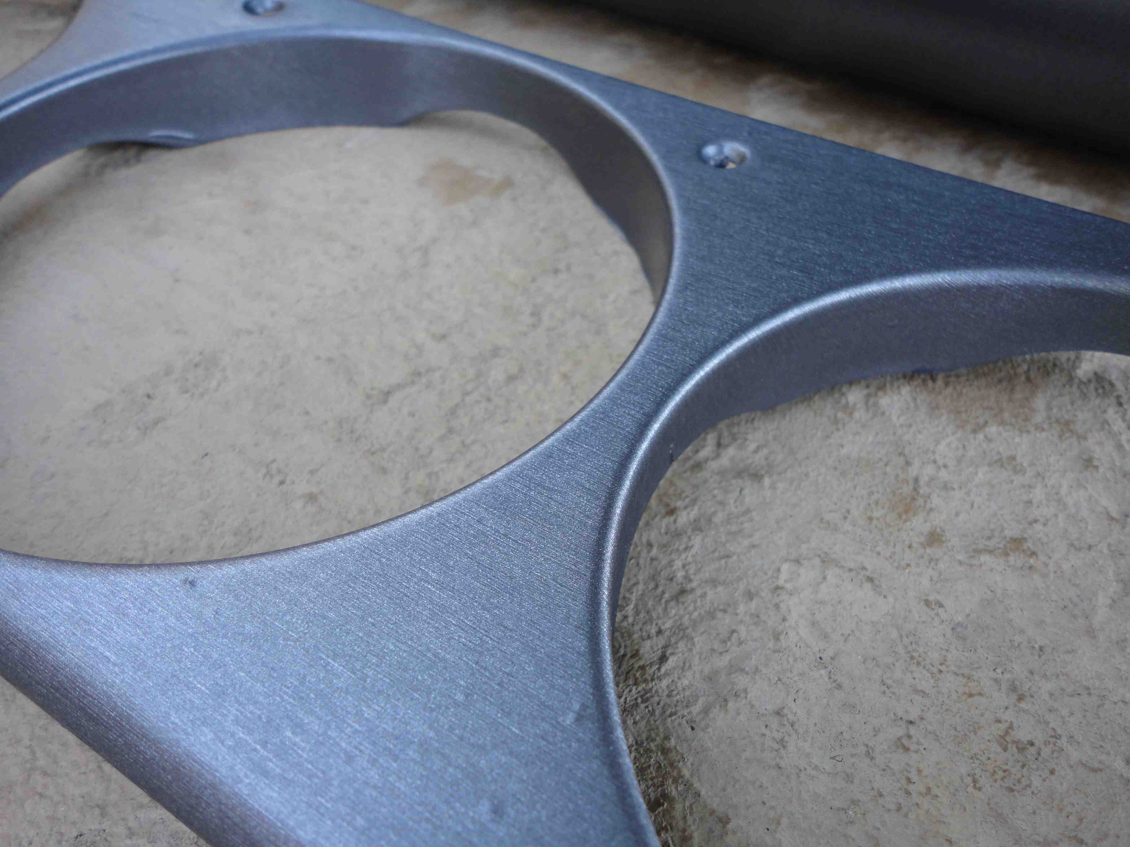

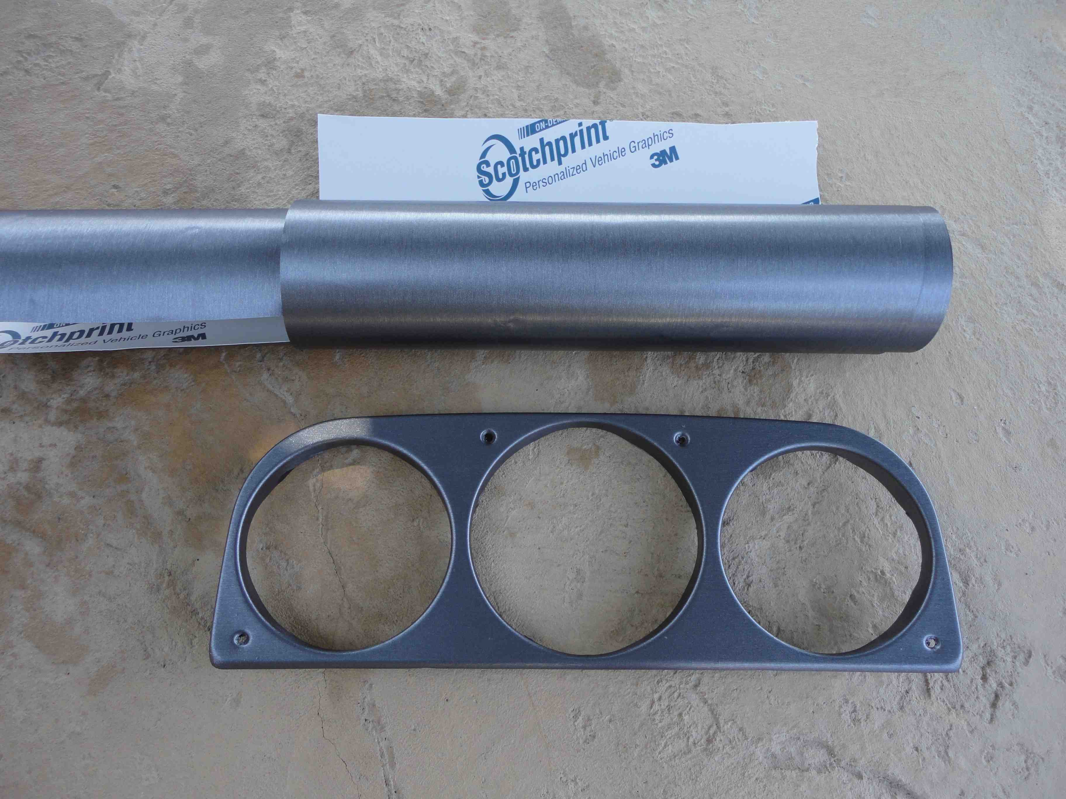

Today I wrapped my gauge plate with stainless steel vinyl wrap. Put in the finished LED gauges done by Tim and last touch was the new Momo wheel!Attached Image

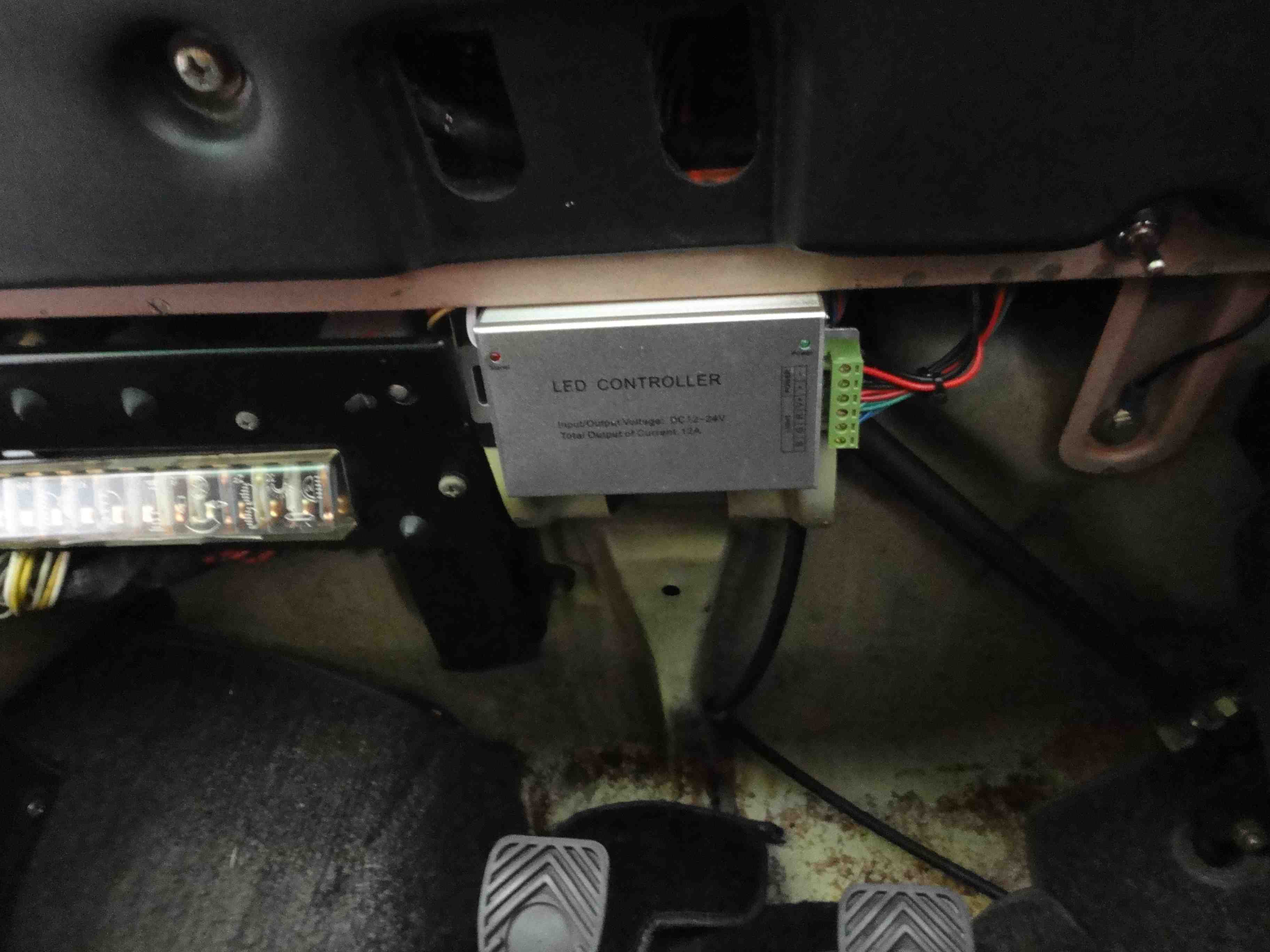

Did you figure out that the black wire from the RGB controller goes to the fuel reserve wire and the light blue wire goes to the tack wire?
914socal
post Aug 10 2013, 09:56 PM
Posts: 38
Joined: 18-October 12
From: Santa clarita
Member No.: 15,059
Yes sir. Directions you sent made and easy install!

Was the vinyl flexible? Looks like it fit around the holes nice. Very cool

A heat gun some stretching and a good razor blade!

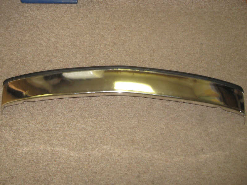

Do they make 'chrome' wide enough to do the fiberglass bumpers so they look like stock?

QUOTE(stugray @ Aug 11 2013, 09:28 PM) *
No.
It's only 60" wide.
If you're real careful its possible to stretch the wrap enough to reach the ends but it isn't easy.
A better way would be to purchase a 6' long piece and coat 4-5 bumpers.
