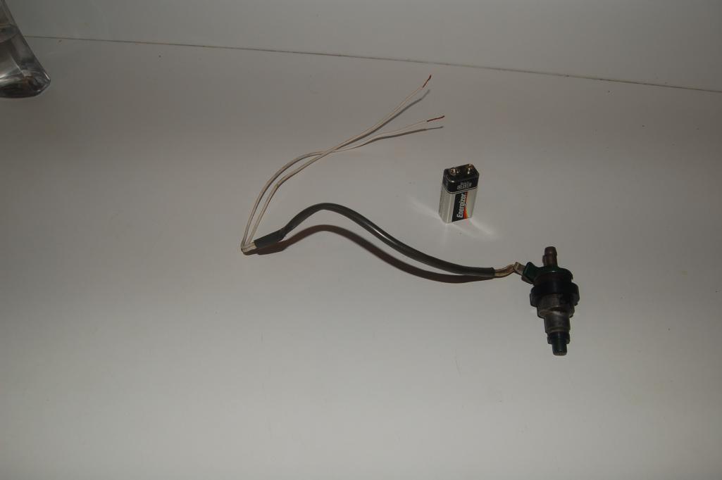

OK,
I hooked up a pig-tail to this injector. Then I got a 9V battery and tapped the pig-tail numerous times.
I never hear the injector click - and I'm assuming that it should.
The pig-tail does spark though - as if there is a short - which seems odd.
So, what is that telling me?
BTW - PO has said that all the injectors were cleaned and tested and all tested and sprayed well. They were however sitting in a baggy for three months. I can't imagine that they just went south????
All four injectors and the cold start valve all behave the same way.
Thanks,
Len

reharvey   These operate at 3 volts. I use a DC model train t...   Aug 11 2013, 11:21 AM
toadman   They do operate at 3V but, in the past I have test...   Aug 11 2013, 11:31 AM
lsintampa   OK, So there is NO click under power. They ohm ...   Aug 11 2013, 11:46 AM
Mark Henry   If the pintle won't budge after the soaking (i...   Aug 11 2013, 12:00 PM

Porsche930dude   try some different test leads and a different batt...   Aug 11 2013, 06:24 PM

Jeff Bowlsby   I have seen this before. The injectors must be in...   Aug 12 2013, 10:40 AM
speed metal army   Is the pigtail you made any good? Just a thought.....   Aug 12 2013, 10:41 AM

SLITS   The electrical component inside is a solenoid. It...   Aug 12 2013, 11:19 AM
lsintampa   The electrical component inside is a solenoid. I...   Aug 12 2013, 11:26 AM
Jeff Bowlsby   You can hear a click when activated. Seems to me ...   Aug 12 2013, 11:41 AM
lsintampa   You can hear a click when activated. Seems to me...   Aug 12 2013, 11:52 AM
Jeff Bowlsby   You can hear a click when activated. Seems to m...   Aug 12 2013, 12:59 PM
