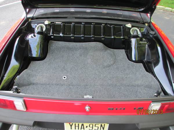

> What's different about this picture, Rear shock towers
Big Len
post Aug 11 2013, 12:55 PM
Posts: 1,771
Joined: 16-July 13
From: Edgewood, New Mexico
Member No.: 16,126
Attached File  1974_Porsche_914_1_8_30K_Orig_Miles.htm ( 11.34k ) Number of downloads: 153
Why are the shock towers different than most others I've seen? Has this car been rear ended? Try image 5.

Here is a working link:
http://newjersey.craigslist.org/cto/3917347207.html
They look pretty normal to me? (IMG:style_emoticons/default/confused24.gif)
Maybe if anything looks like the factory seam sealer was cleaned off of them and they look smoother than normal?

Looks stock to me ... (IMG:style_emoticons/default/confused24.gif)

does yours not have the rubber nipple covers? It does look like seam sealer is gone though.

Looks like the witches hats are not fitted quite right (maybe) (IMG:style_emoticons/default/biggrin.gif)

Was looking at this cat today. Perhaps nothing is wrong, but welding/forming of steel was different (way smoother) than anything else I had seen. What could be the reason for this?

The trunk was re-done. It would originally have been body color, this is black. So chances are the seam sealer was removed as part of the stripping process, and it was either re-applied with a very smooth finish, or not re-applied at all.
